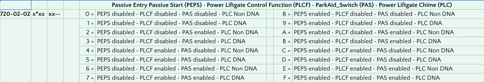

Howdy!
I've installed the aftermarket kick-open lift gate mod on my '23. It works great! A little too great - speed bumps in parking lots are triggering it pretty reliably. The lift gate doesn't open because I'm in drive, but it chimes do-do do-do do-do at me and passengers ask me why my car is beeping - it's because the lift gate won't open even though the car thinks I hit the button to open it.
Is anybody aware of a way to disable the chime? I'm willing to figure out FORScan if there's an option in there. :)

It might be here:
Ford Mustang Mach-E Disable Liftgate Chime - FORScan? 1728099834494-e8
I have not been able to figure out what DNA means. Mine is set to C. I do have the power liftgate, but not the kick-open feature.

Do we know what to set it so to not have the liftgate chimes ?
Just change the bit to the opposite of what you have now for PLC and leave the rest of the config options the same. So if you have a 0, change it to 1. Or if you have a 7, change to a 6. I would assume PLC non DNA is the one that does not chime, but I can't say for sure.
sozty, which module is that?

Ah, ok I understand! Thx again! 😎

Do ou know what ParkingAid Switch does?

IPC from the spreadsheet post #2. PAS Parkaid switch.
I'm guessing that is to enable the Park Assist animation/symbol on the IPC for vehicles that are equipped with park assist.

Yeah bit I habe park assist and this is in as build disabled
Strange. My F150 with park assist has a C there, so it is enabled.
