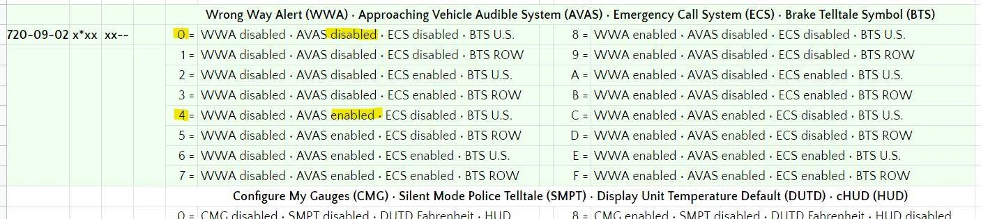

The 'free' PACM method that is used by the powerboost F150 hybrid works on the MME. The forscan value change is from 4 to 0 (zero) (If you have auto 911 dial enabled, it may be a 7 value to 2 value change) - there's a YT vid on it "powerboost speaker silence". It's located in the rear back panel of the vehicle. For those who use their vehicle off road exclusively, you can remove / modify the dump truck beeping. The forscan value change tells the IPC that with a waive of the hand "there is no beeper"

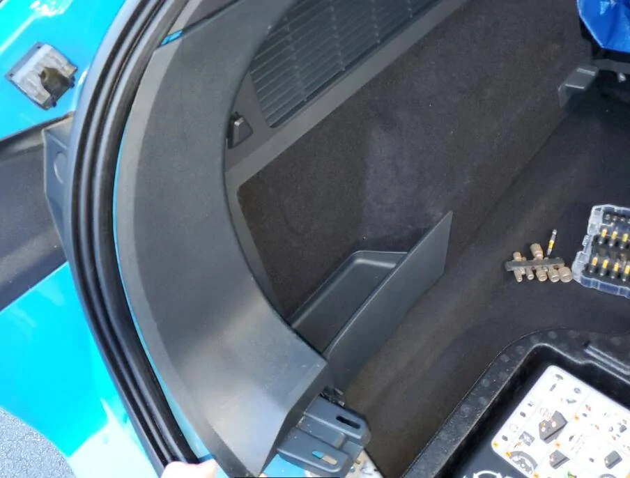

4 screws to remove the scuff plate...
Pop open this rear panel....

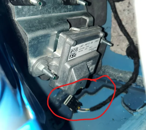

Just enough to reach a hand in and get this guy....
Alternatively, this is also the spot to tap into the speaker if you want a volume knob instead of playing at the speaker itself.
