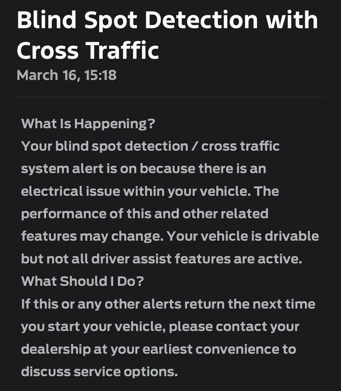

This message is the only one that gets reported to my Ford Pass app:
Ford Mustang Mach-E Disappearing Fault Warnings Screenshot 2026-03-20 at 05.33.56
