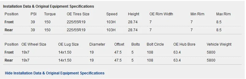

I have been driving on the Michelin Pilot Sport AS UHP for about 1500 miles now on the factory Premium rims and sizes. I get much better grip and better braking and still get great efficiency.
2.9 to 3.2 m/kw at 70-75 MPH. I run the tire pressure at 45-46 psi for the ride quality. The tires are rated for 50 psi for the XL load range. At 47 psi the tread is flat on the ground and is wearing even. The Mach-E handles like a Mustang should.
as an FYI tire pressure is set by the automobile manufacturer to maximize the tire's contact patch. On the pillar near your driver's door latch, you will find a placard that shows how much pressure ford recommends. The recommended pressure for a 19" wheel premium is 39psi. At 47 psi the tire is over-inflated and will wear out the center first
