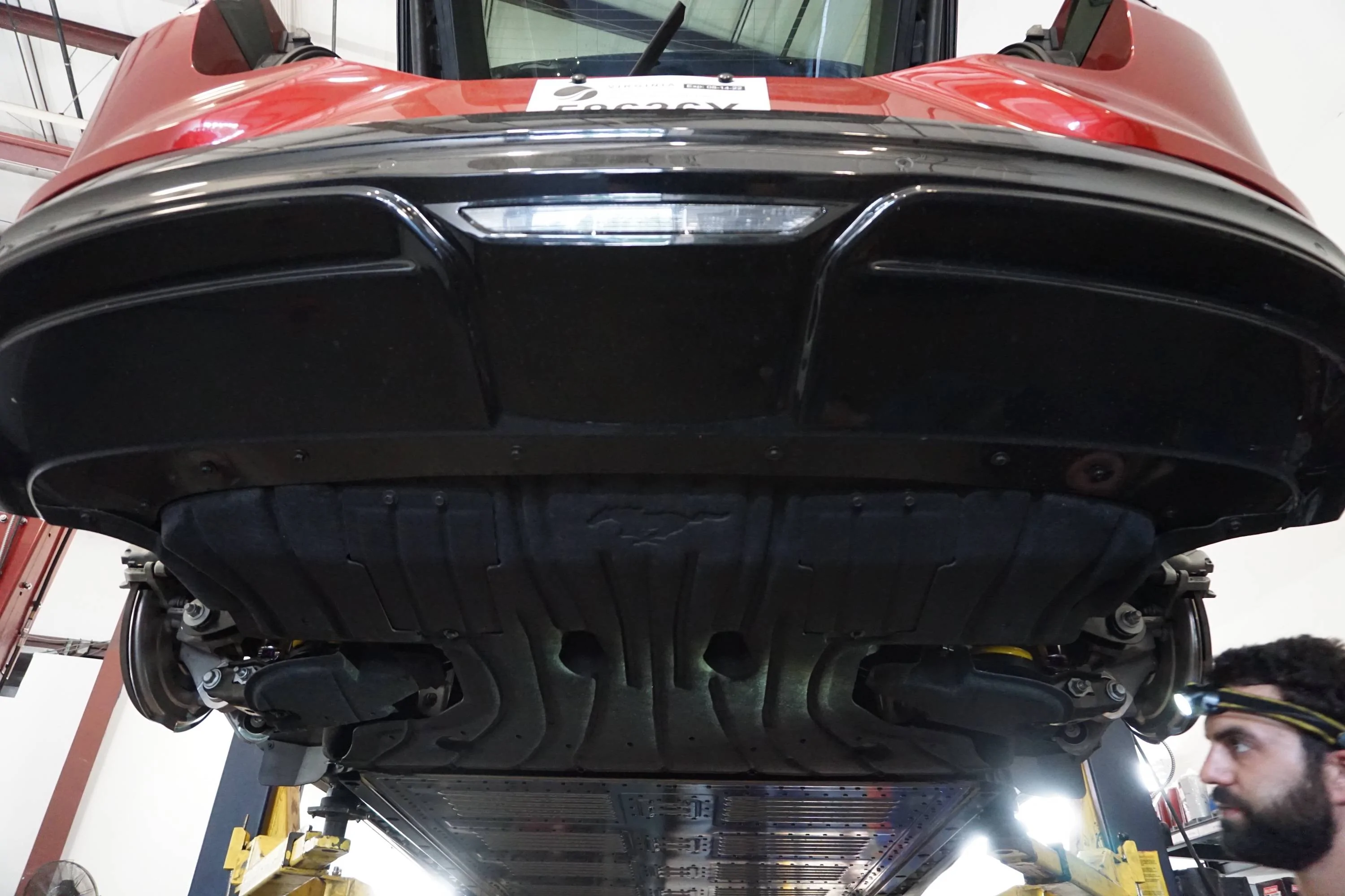

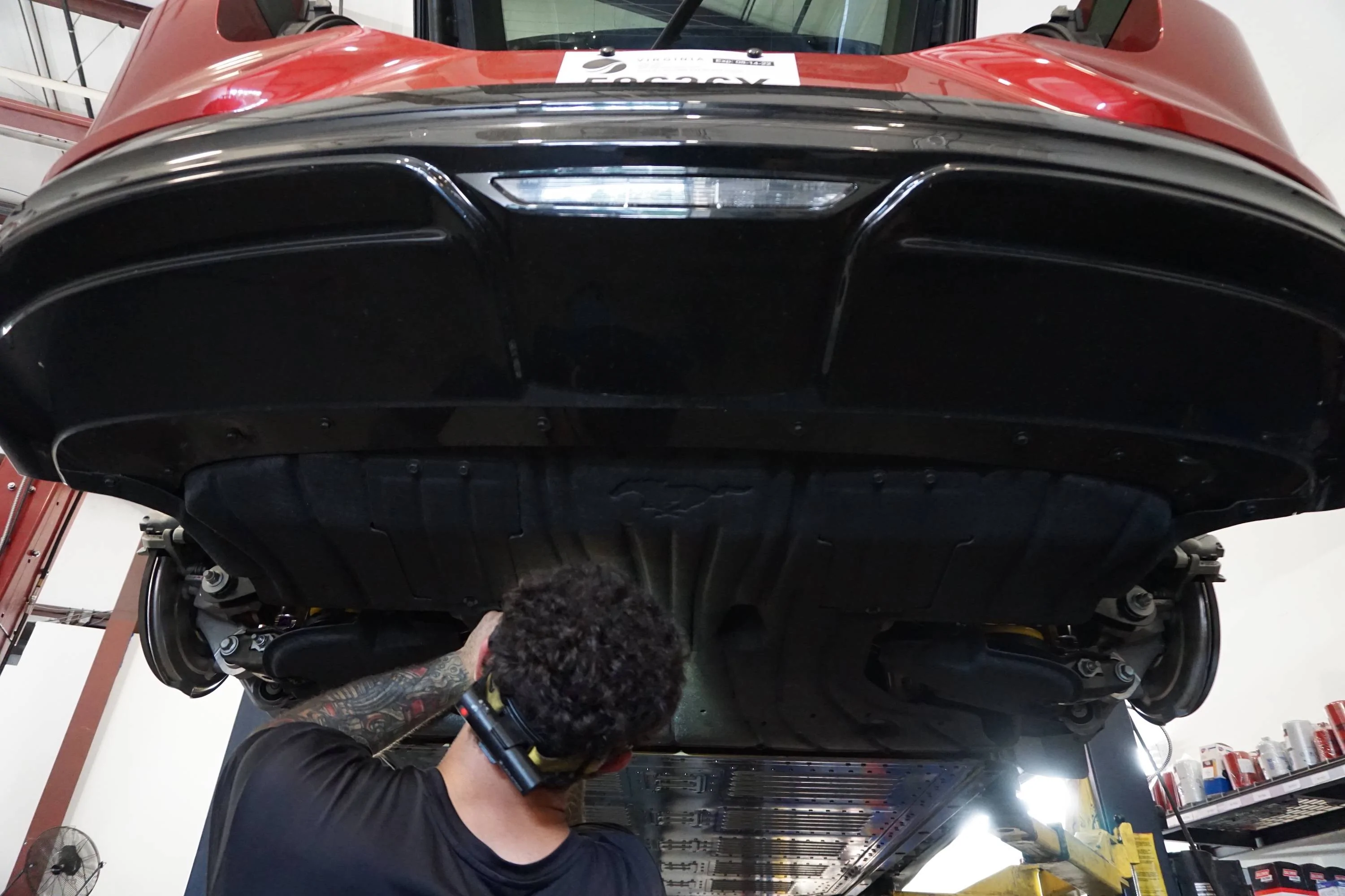

- Remove rear felt underbody tray, and both lower control arm air deflectors. Tray: 14 screws, 2 ribbed pins, 3 spread push pins; Deflectors: 3 retainers.

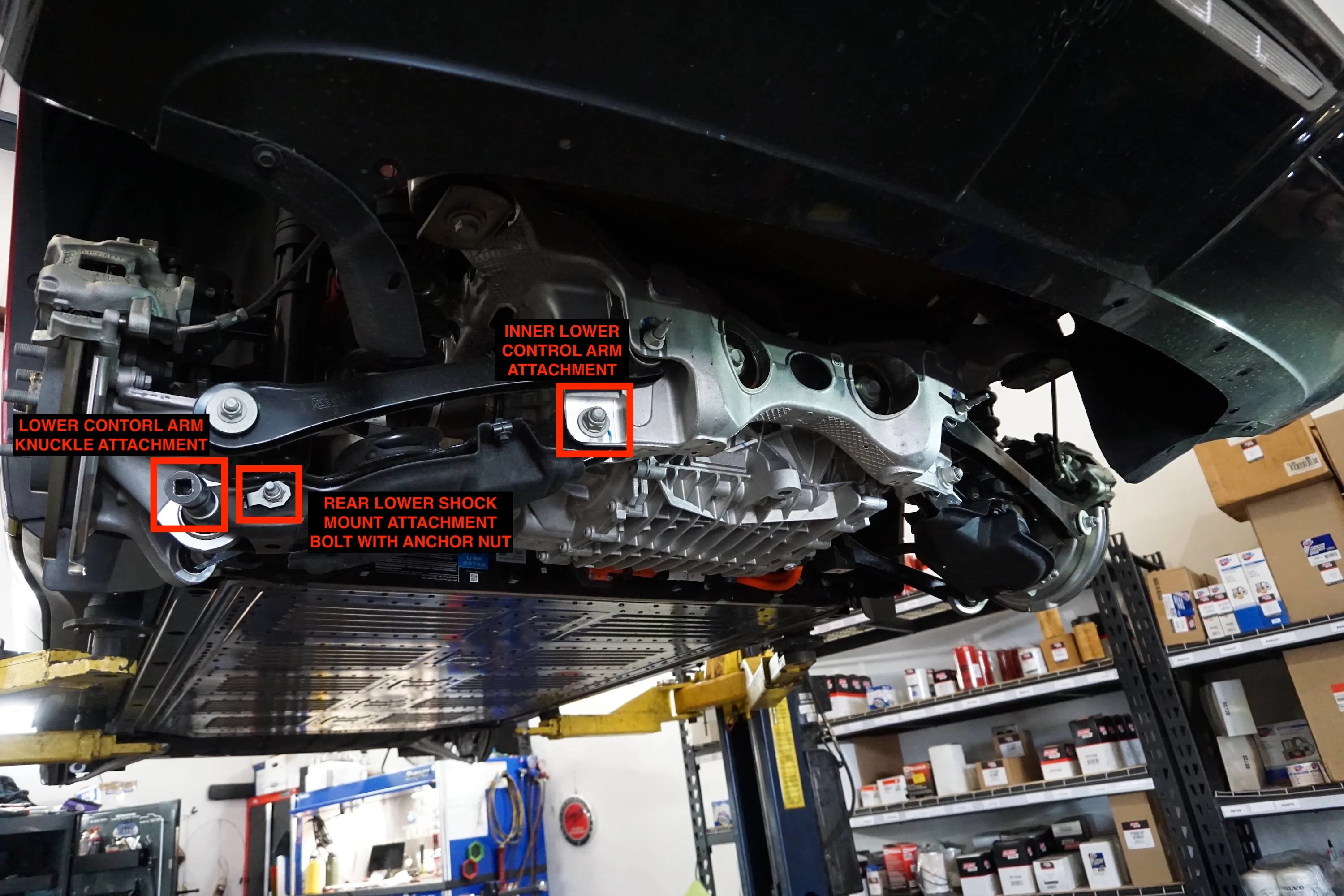

REVIEW THIS ZOOMED PHOTO OF ALL BOLTS AND NUTS REFERENCED IN THE FEW STEPS BELOW

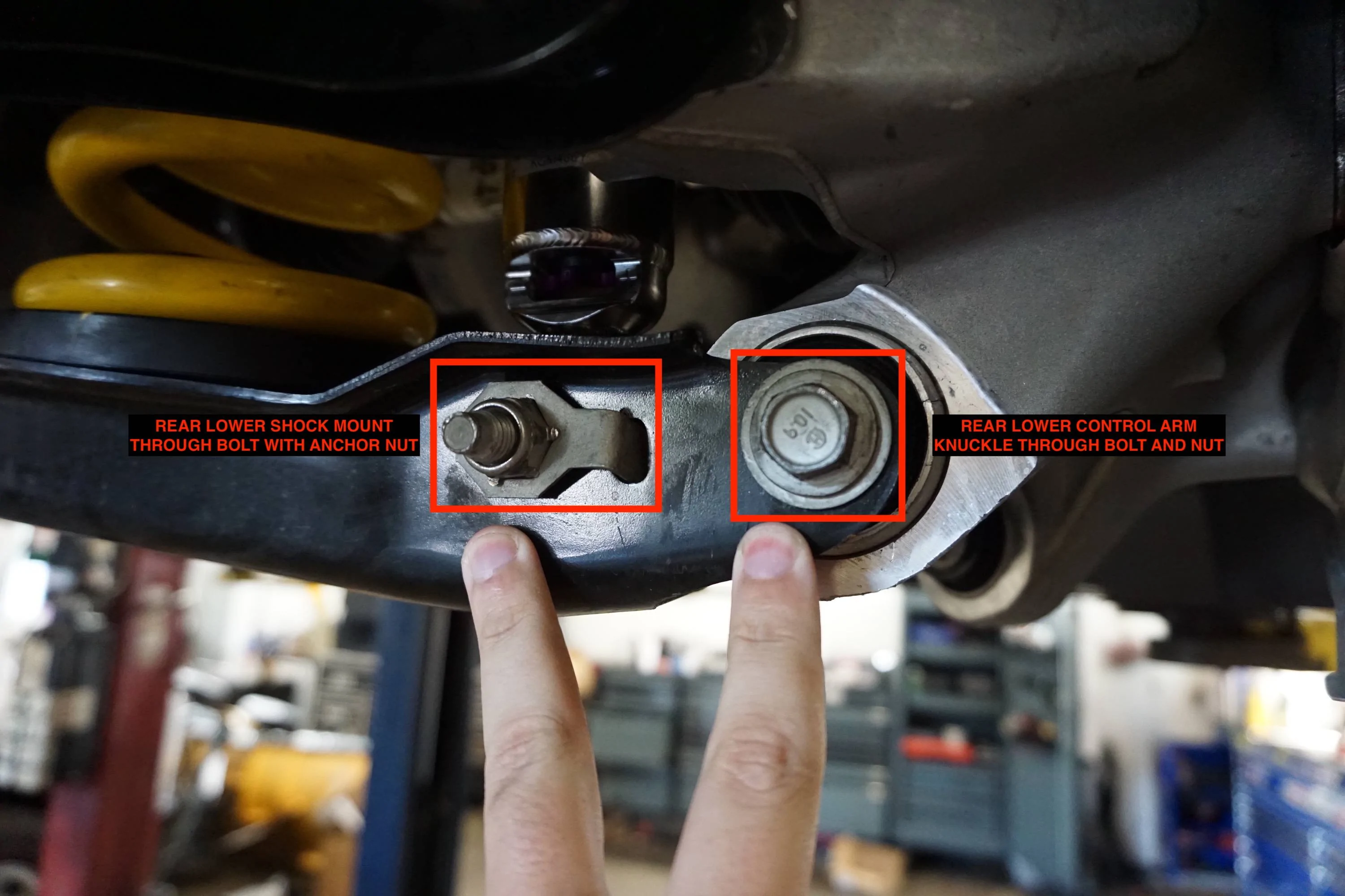

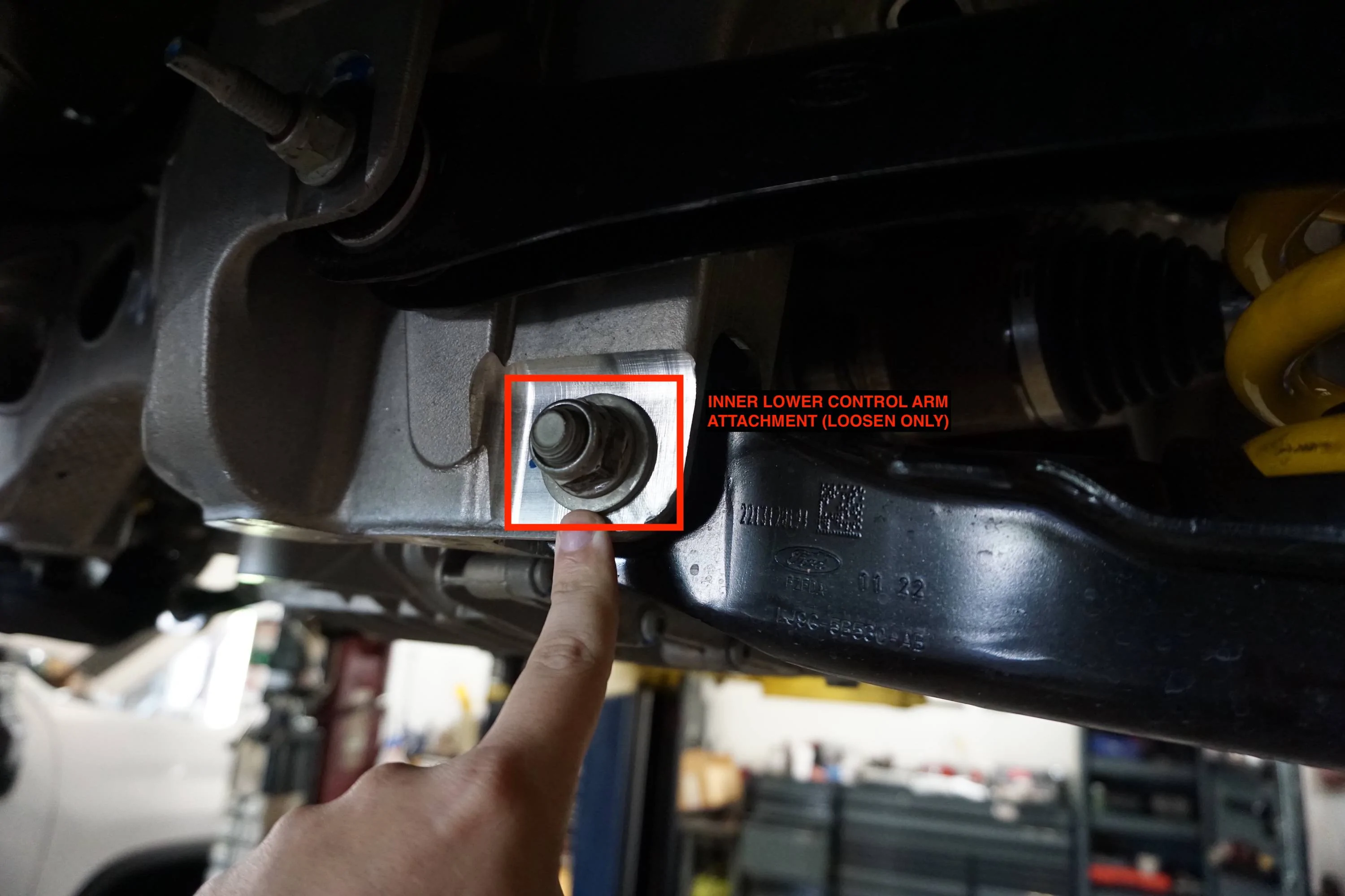

- Loosen rear lower control arm INNER mounting bolt. DO NOT FULLY REMOVE – JUST LOOSEN. This allows the control arm to swing down once removed from the rear knuckle.
- Loosen and remove bolt held by the anchor nut. You will remove the bolt side until fully unthreaded from anchor nut. (Left bolt/nut in image below)

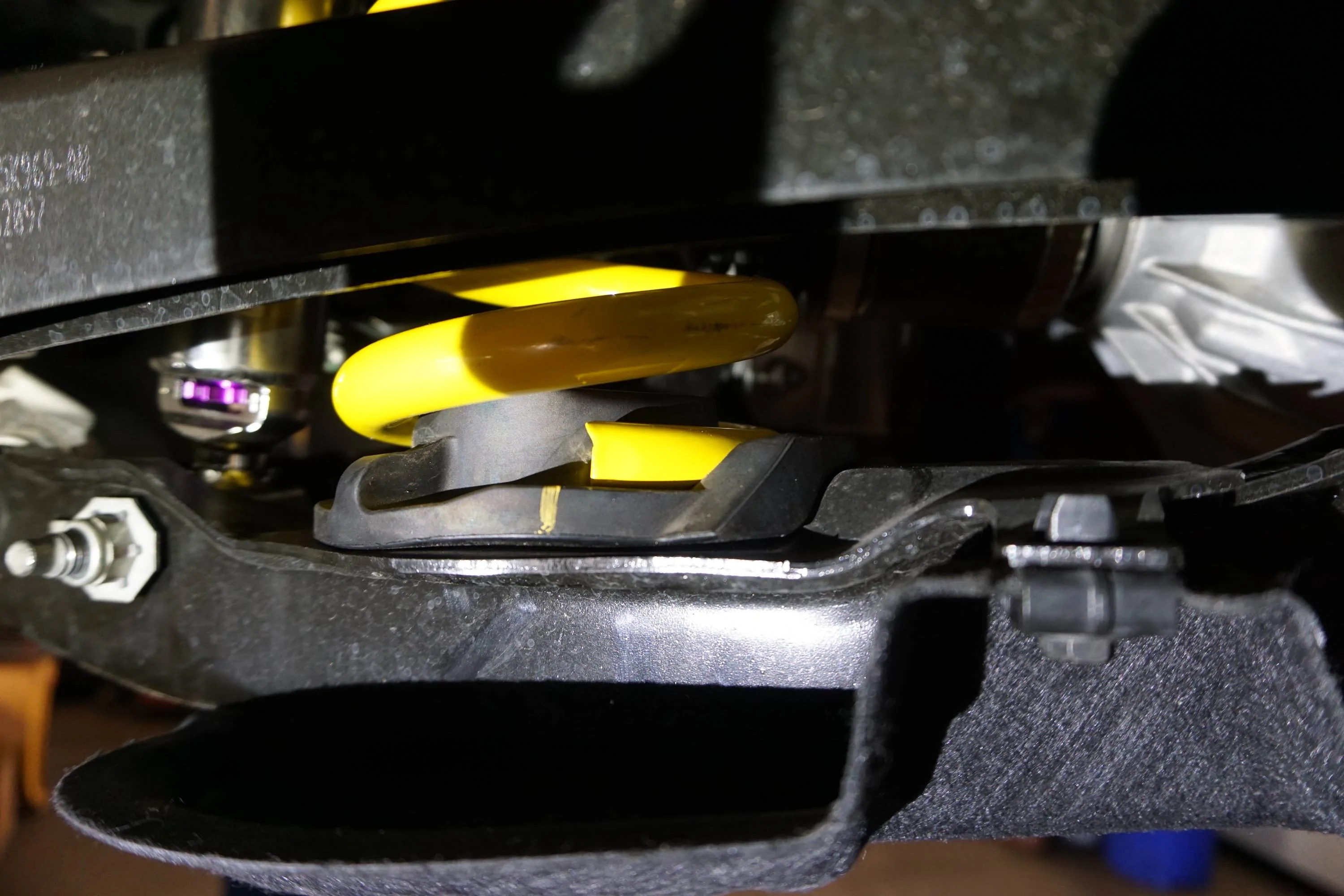

- This step may be optional, but I will recommend you do it anyway. The lower rear rubber spring perch/isolator that sits between the spring and control arm only sits one-way on the control arm. You’ll see a raised “hill” on the rubber perch that’s aimed towards the rear drive unit. Also look to see if there is a vertical marker line indicating where the lower spring coil ends on the perch. If one doesn’t exist, use a paint marker or silver sharpie to draw a vertical line indicating spring location on the perch. The perch will also have an indentation from the OEM spring pressing into it. You'll use that indentation to reinstall and align the KW coil spring.

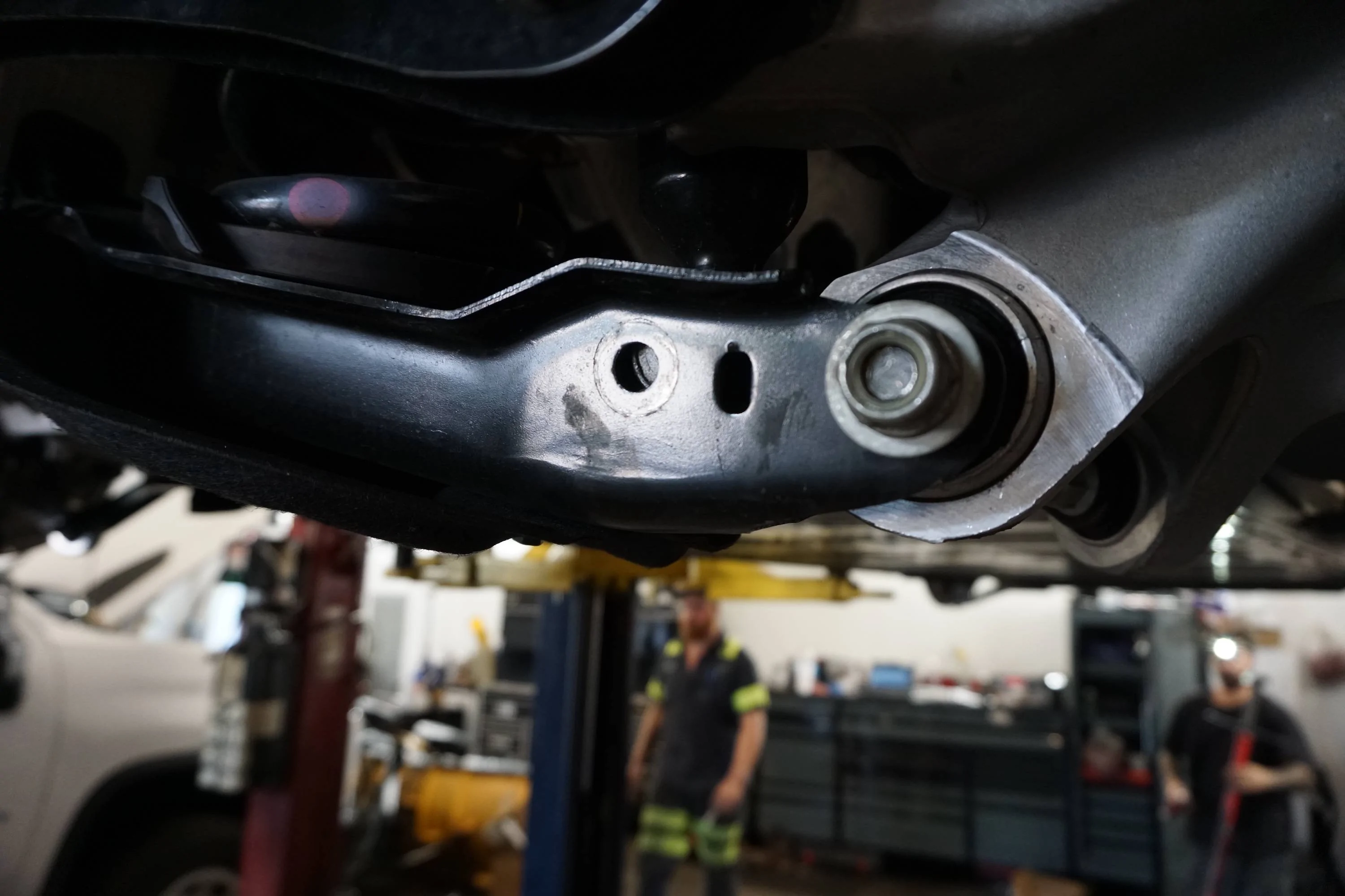

- Loosen and remove bolt and nut securing rear lower control arm to rear hub knuckle. Use a jack stand or under hoist to hold the rear lower control arm. Once this bolt is removed, the control arm will be free to pivot down, releasing the rear spring assembly. Set spring assembly aside and retain lower rubber perch/isolator for reuse.
- Loosen and remove two bolts securing the shock to the chassis. Remove shock assembly and set aside.

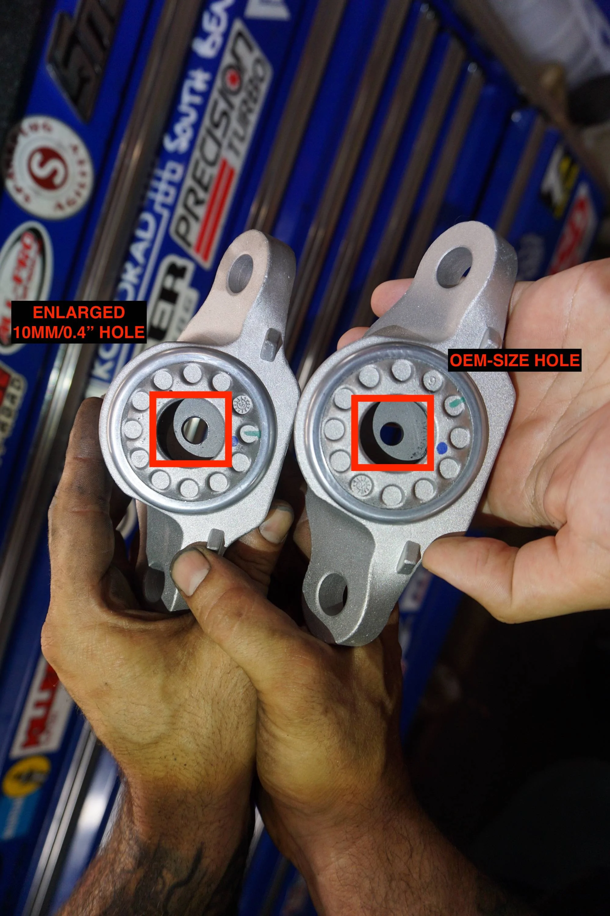

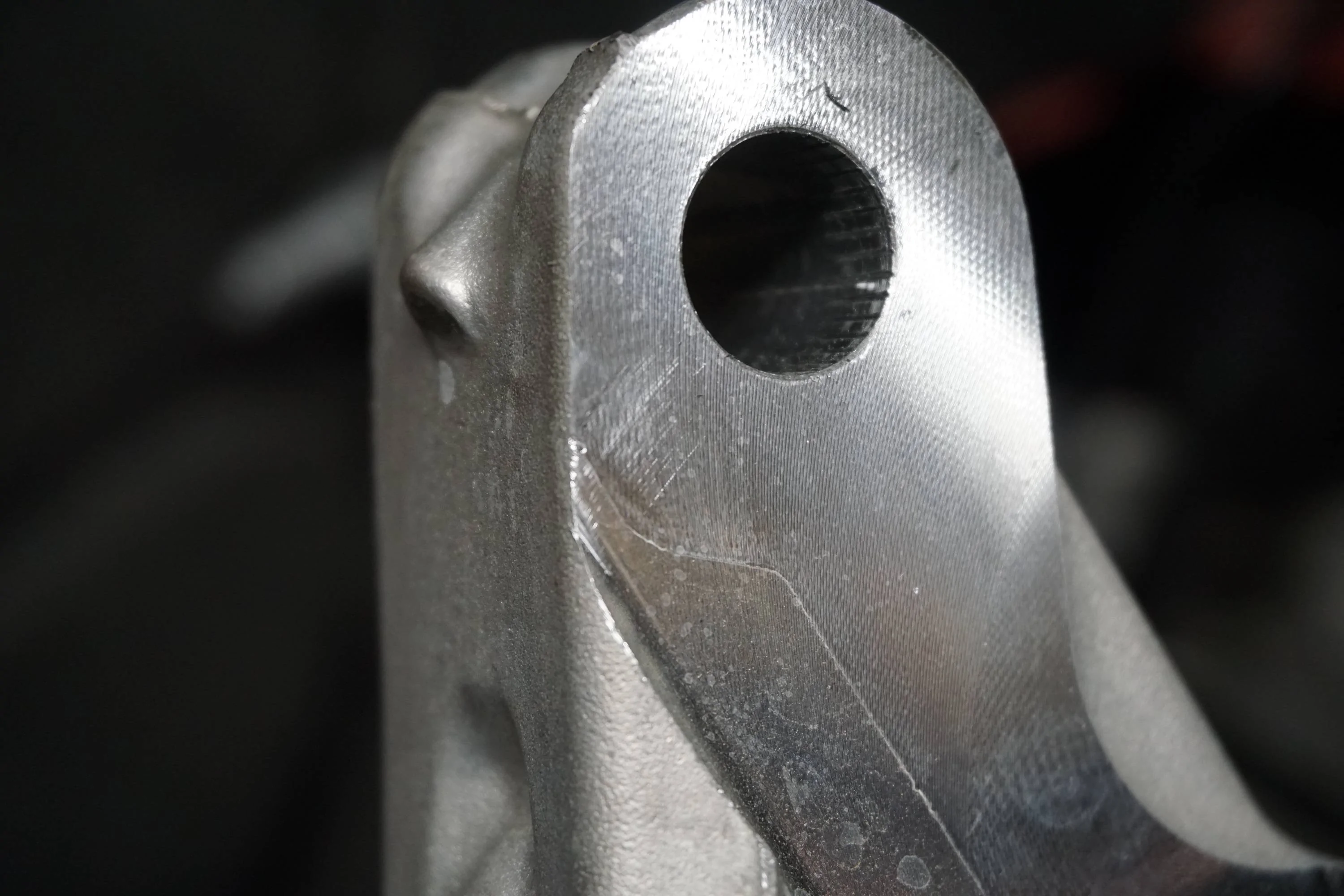

- NOTE: If you purchased spare OEM hardware, SKIP THIS STEP. Remove black plastic cap exposing rear shock mount bolt. Then remove OEM shock mount from shock and set aside for required modification to fit replacement KW shock.
NO PHOTO OF THIS STEP
- Enlarge mounting hole on rear shock mount, using a 13/32” or 10mm metal drill bit.
- Install modified shock mount to KW shock. KW includes a washer and two nuts. Assembly order: KW Shock > Mount > Washer > Nut (tighten) > Nut (tighten). Install black plastic protective cap by tapping it with a rubber mallet until it grabs the shock mount. Torque: 15 lb.ft (20 Nm).

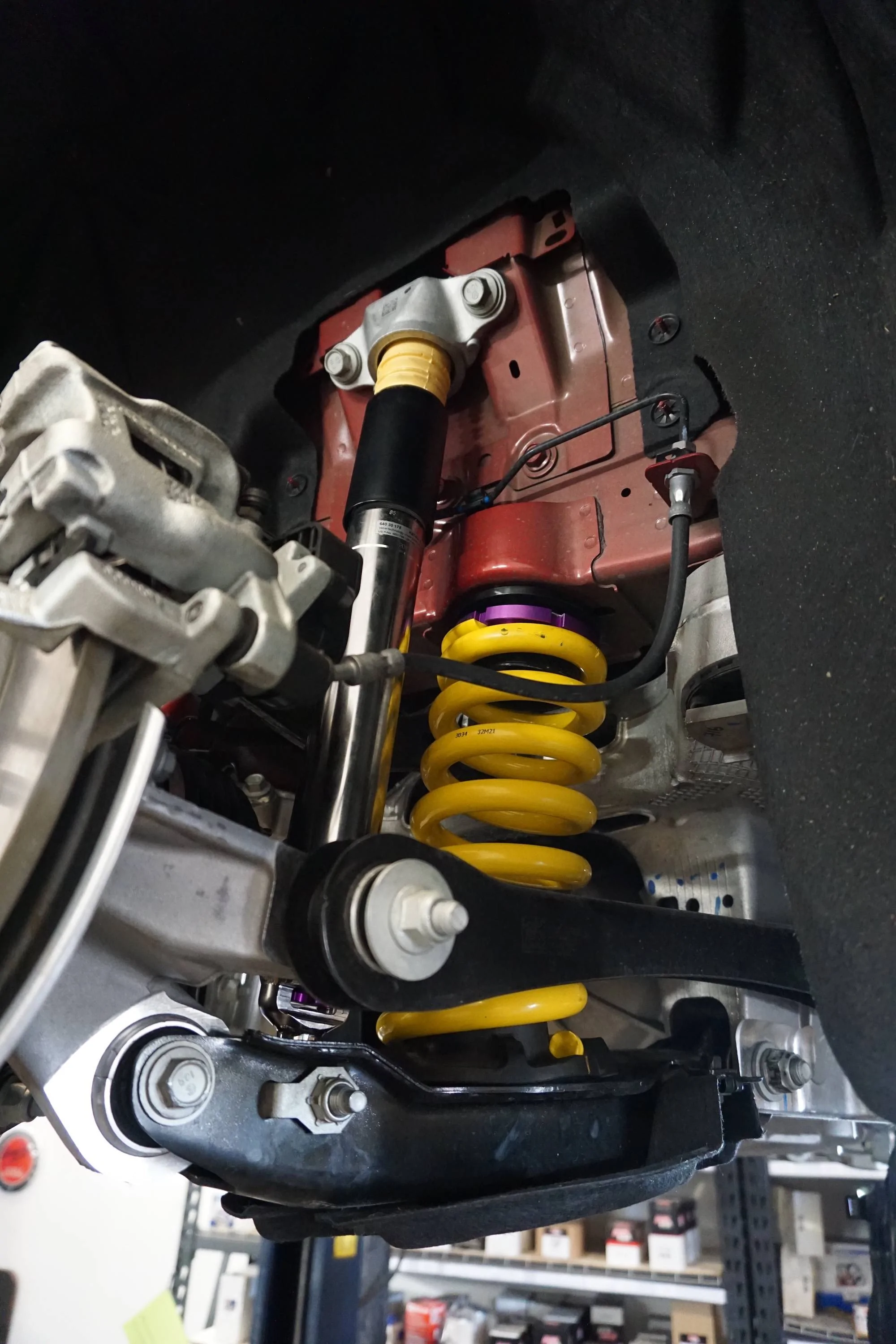

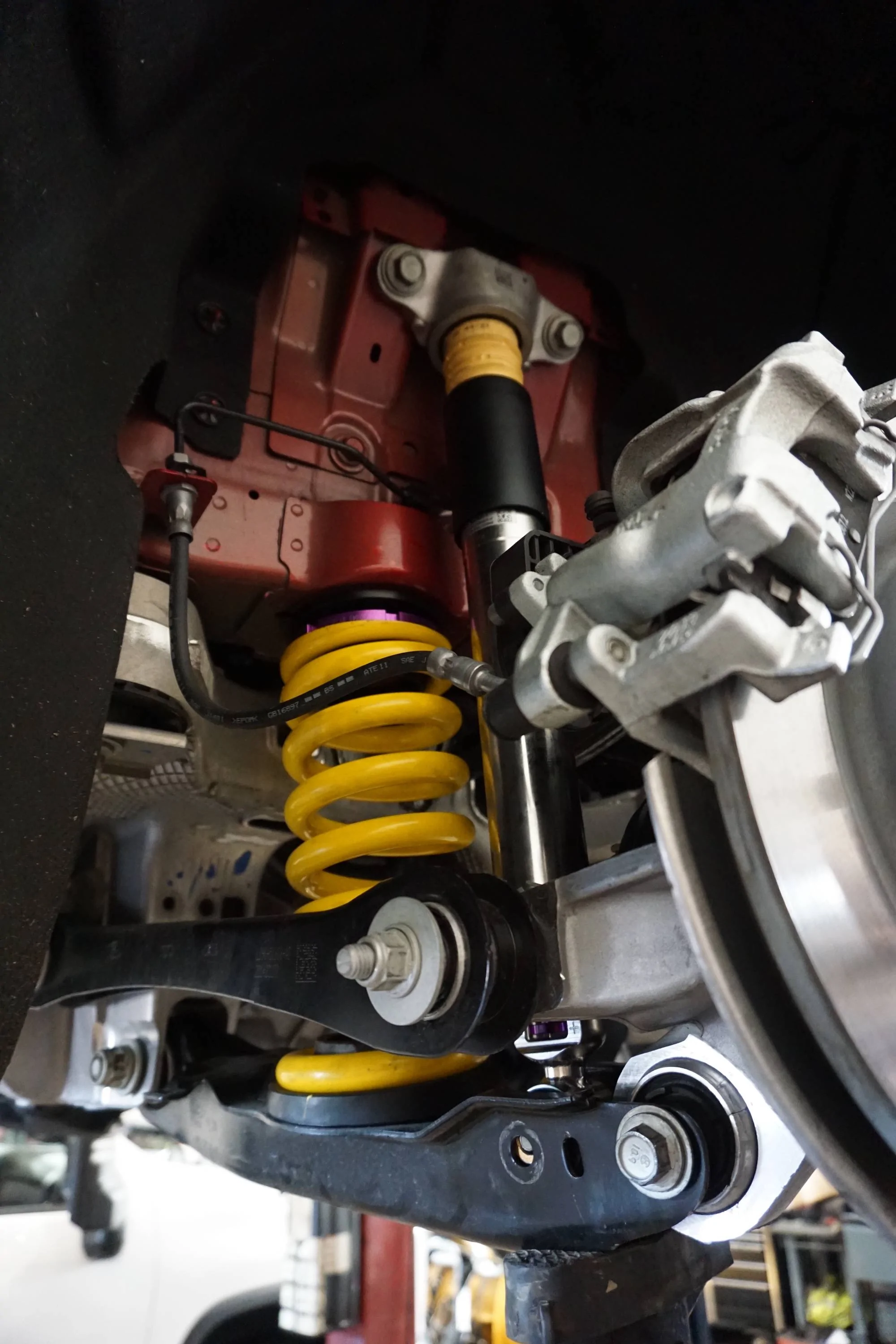

- Install and fasten KW shock to chassis using upper mount only. Lower will be fastened once the rear lower control arm is reinstalled. Torque: 81 lb.ft (110 Nm).

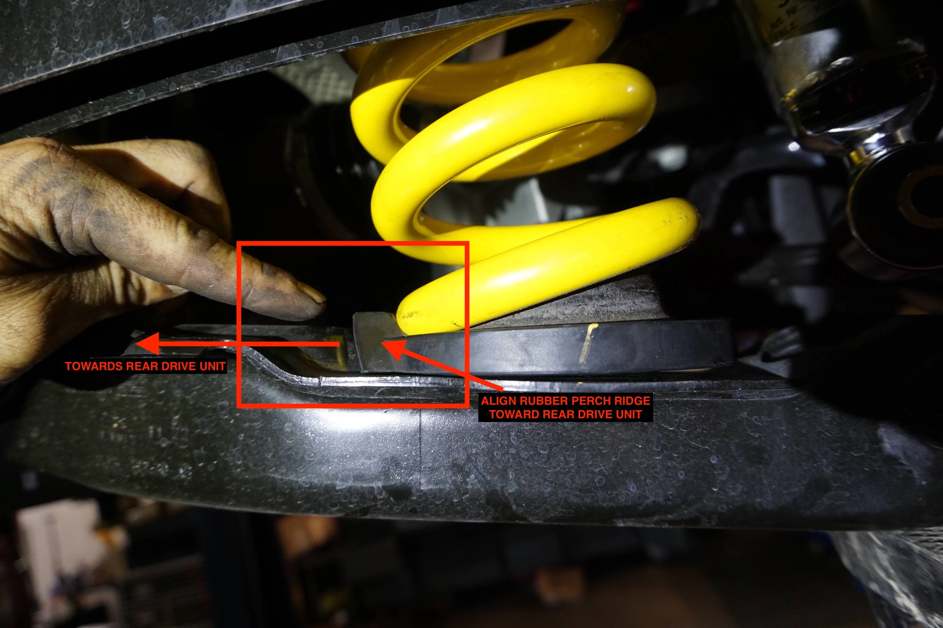

- Gather: KW upper adjustable perch, KW spring, OEM lower rubber perch/isolator. Apply anti-seize to adjustable perch threads, and thoroughly thread in. Set adjustable perch to middle alignment, so an identical number/distance of threads is equal above and below. You will be adjusting height a few times based upon initial vehicle contact to ground and height preference. I recommend middle so you have an idea of available adjustment range after first look.
- Install rear spring assembly. Slide all three components up into the cavity, ensuring the adjustable perch is sitting flush to the chassis. Ensure the lower rubber perch and coil spring are properly aligned, as identified in Step 4. Installation requires you to pivot the lower control arm up to meet the rear knuckle.
- Use a jack stand or under hoist to hold the control arm and apply lifted pressure until the holes line up between the rear lower control arm and the knuckle. Reinstall knuckle bolt and nut. This will require a combination of upward tension on the control arm, while pulling down on the entire hub assembly, to get the holes to line up between these two components. Torque: 92 lb.ft (125 Nm).
- Install and fasten the lower shock body mount to the control arm. Torque: 81 lb.ft (110 Nm).
- Fasten the previously LOOSENED rear lower control arm INNER mounting bolt. Torque: 129 lb.ft (175 Nm).

- When both sides are complete, reinstall rear felt protective tray, including two felt covers protecting the rear lower control arms.

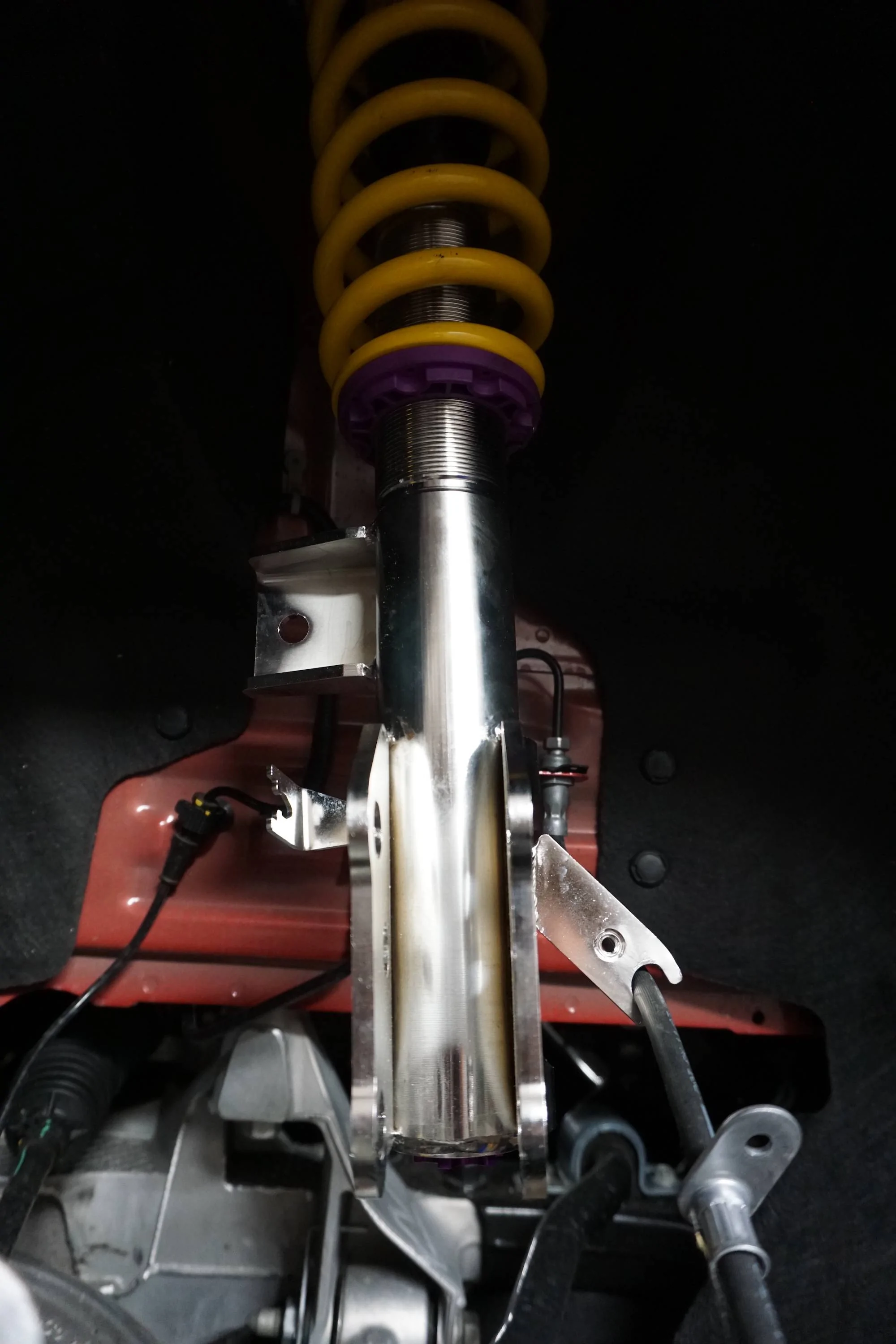

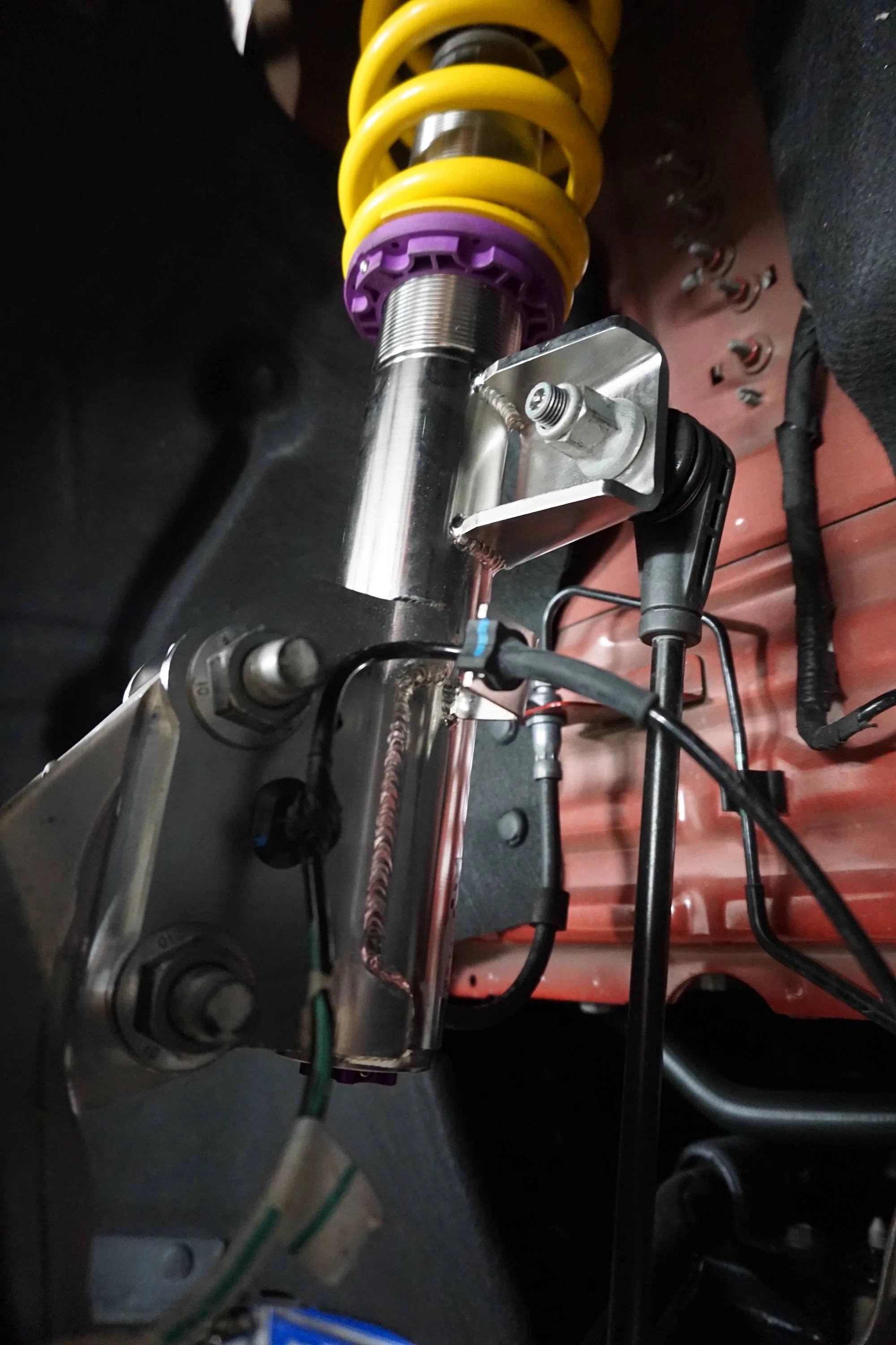

Before you get started, I recommend capturing the rough alignment position of the front end. With the steering centered as straight as possible, use a torpedo level to capture the camber position for the side you are working with. Yes, this is not accurate, and no, this will not be your final alignment adjustment. You WILL need an alignment after a brief settling period. Capture the level’s reading with your eye, camera or whatever you need, then proceed.
- Loosen and remove strut tower brace nuts, and brace. Set hardware and brace aside for reinstallation.

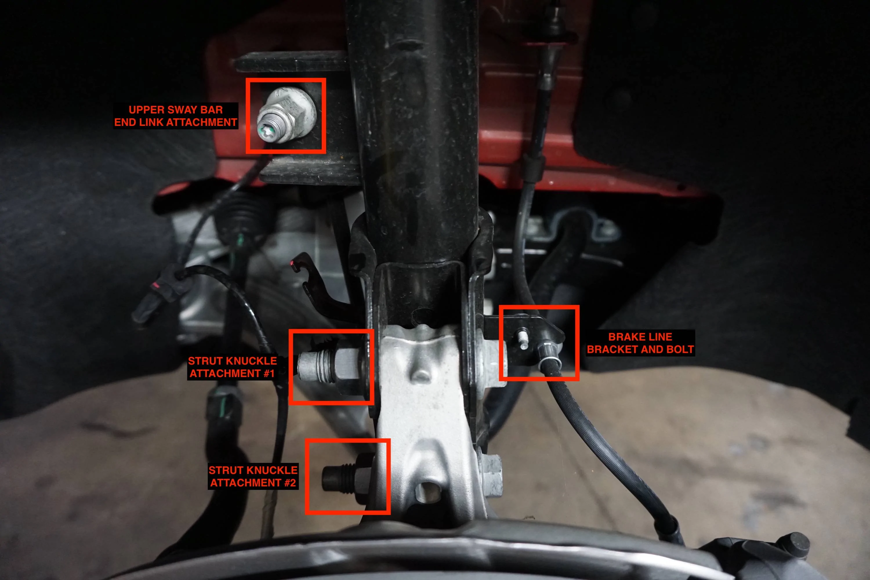

- Loosen and remove brake line bracket bolt from strut. Set bolt aside for reinstallation
Loosen and remove UPPER sway bar end link nut. Set aside for reinstallation - IMPORTANT NOTE: Knuckle bolts are SPLINE BOLTS. BOLTS WILL NOT SPIN UNTIL APPROXIMATELY 1” REMOVED FROM THE SLOT. Loosen and remove BOTH knuckle bolt NUTS attaching the strut to the knuckle. Once both bolts are removed, the knuckle will fall away from the car, and will be held in place by the brake line. Use a bungee cord, or some stiff wire to relieve tension from brake line. Set hardware aside for reinstallation.

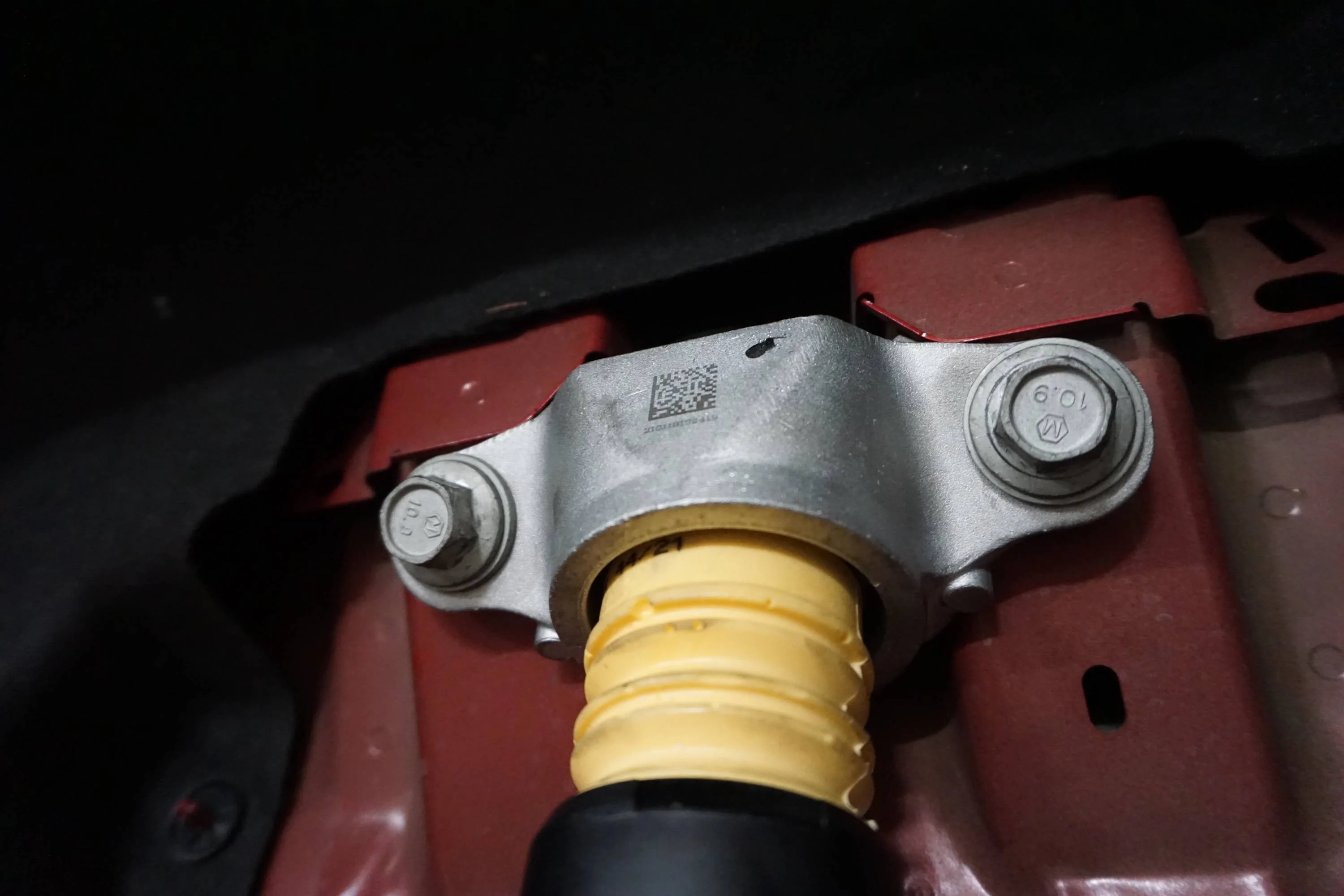

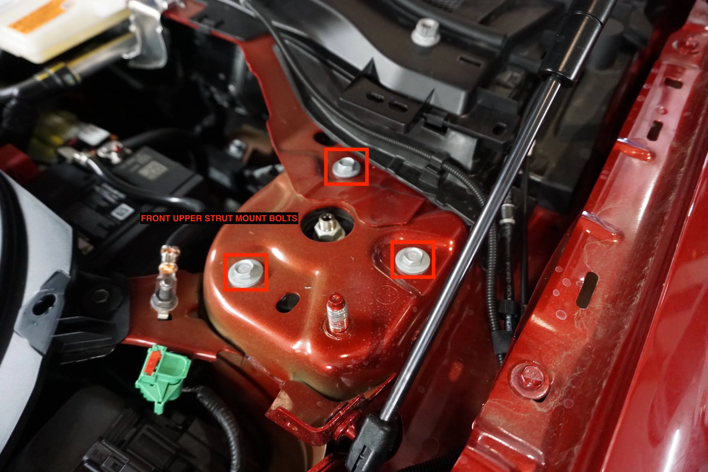

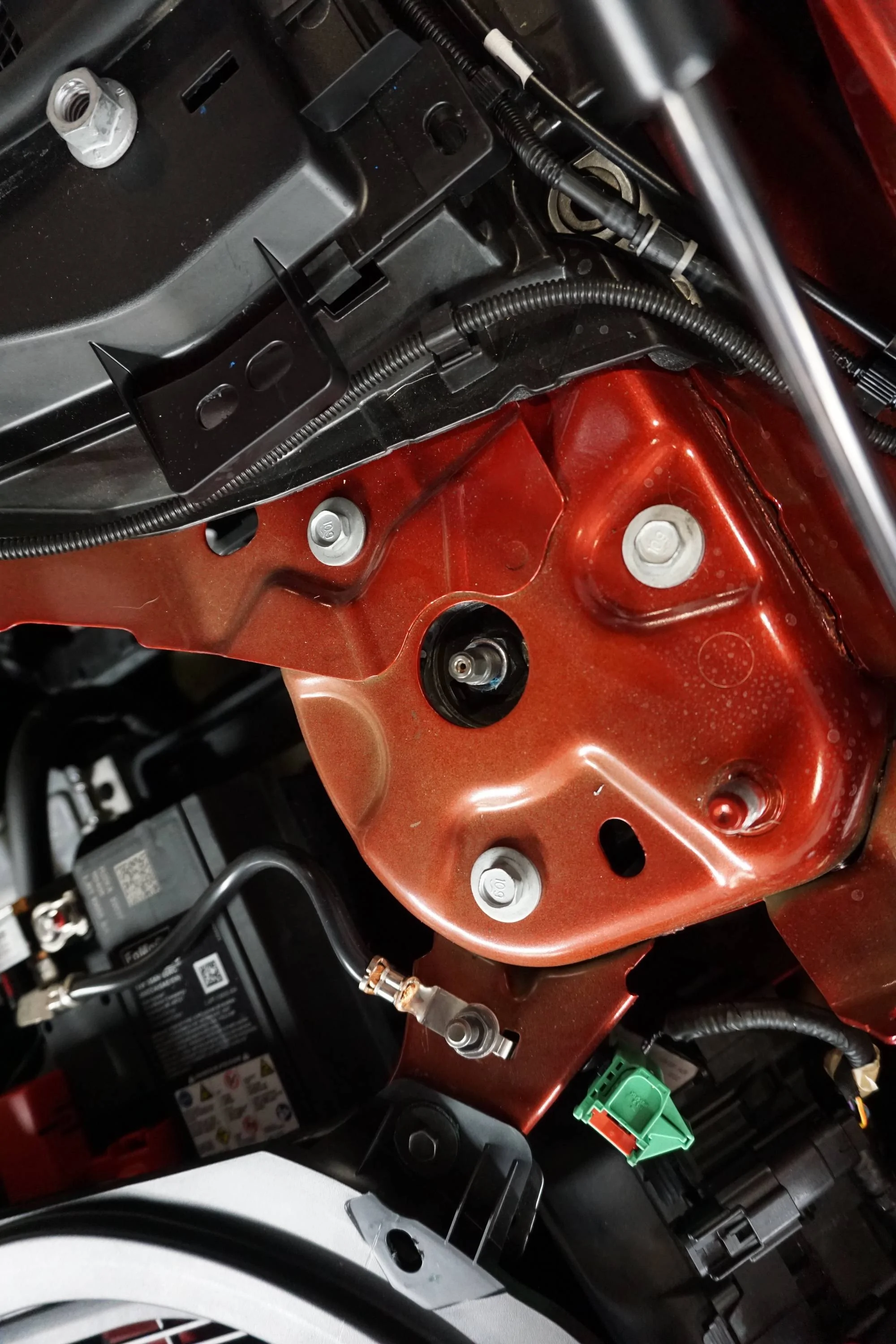

- Loosen and remove THREE bolts affixing upper strut mount to body. As you’re removing the last bolt, keep a firm grip on the strut assembly. It will be completely free to fall. Set hardware aside for reinstallation.

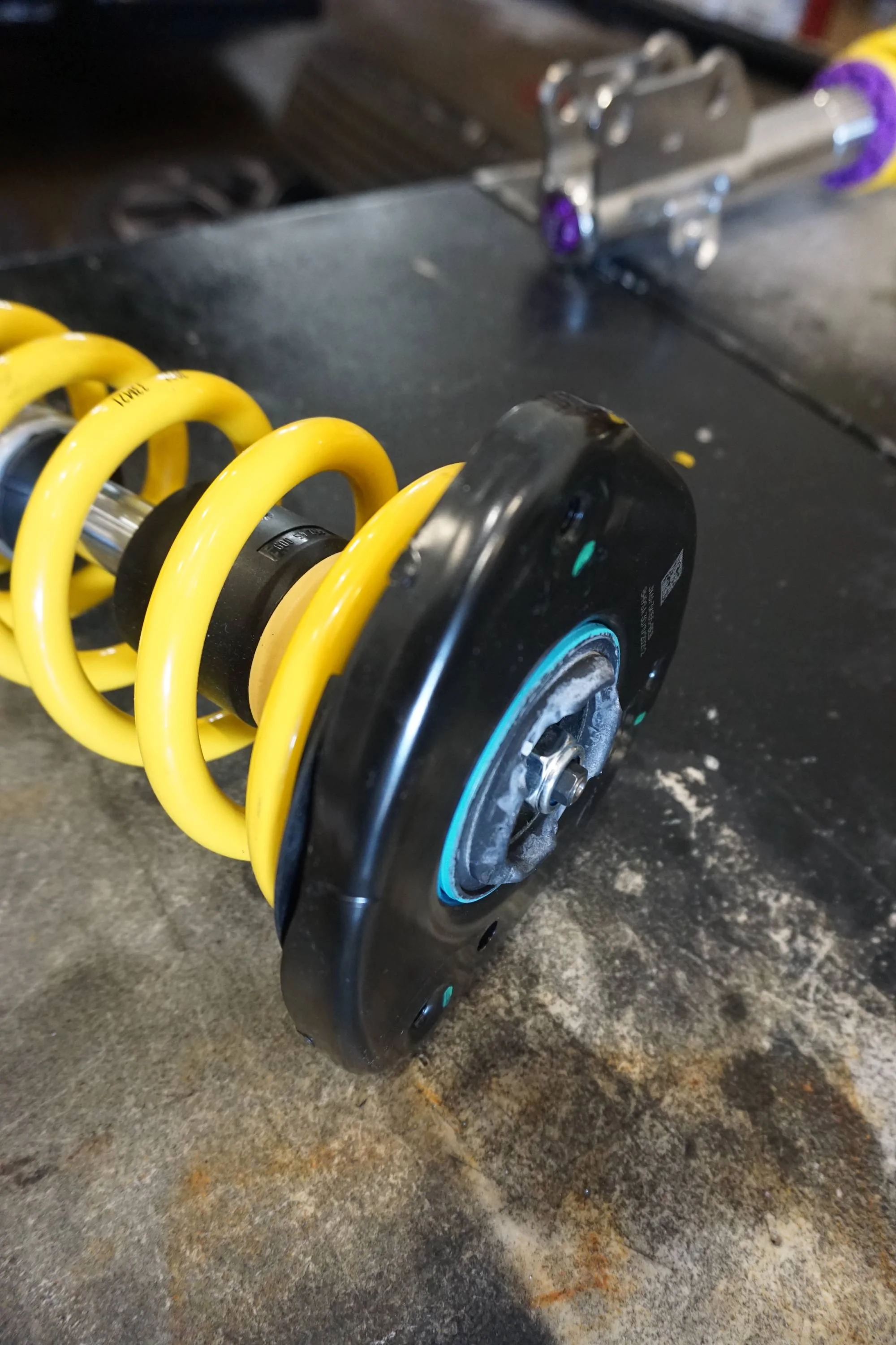

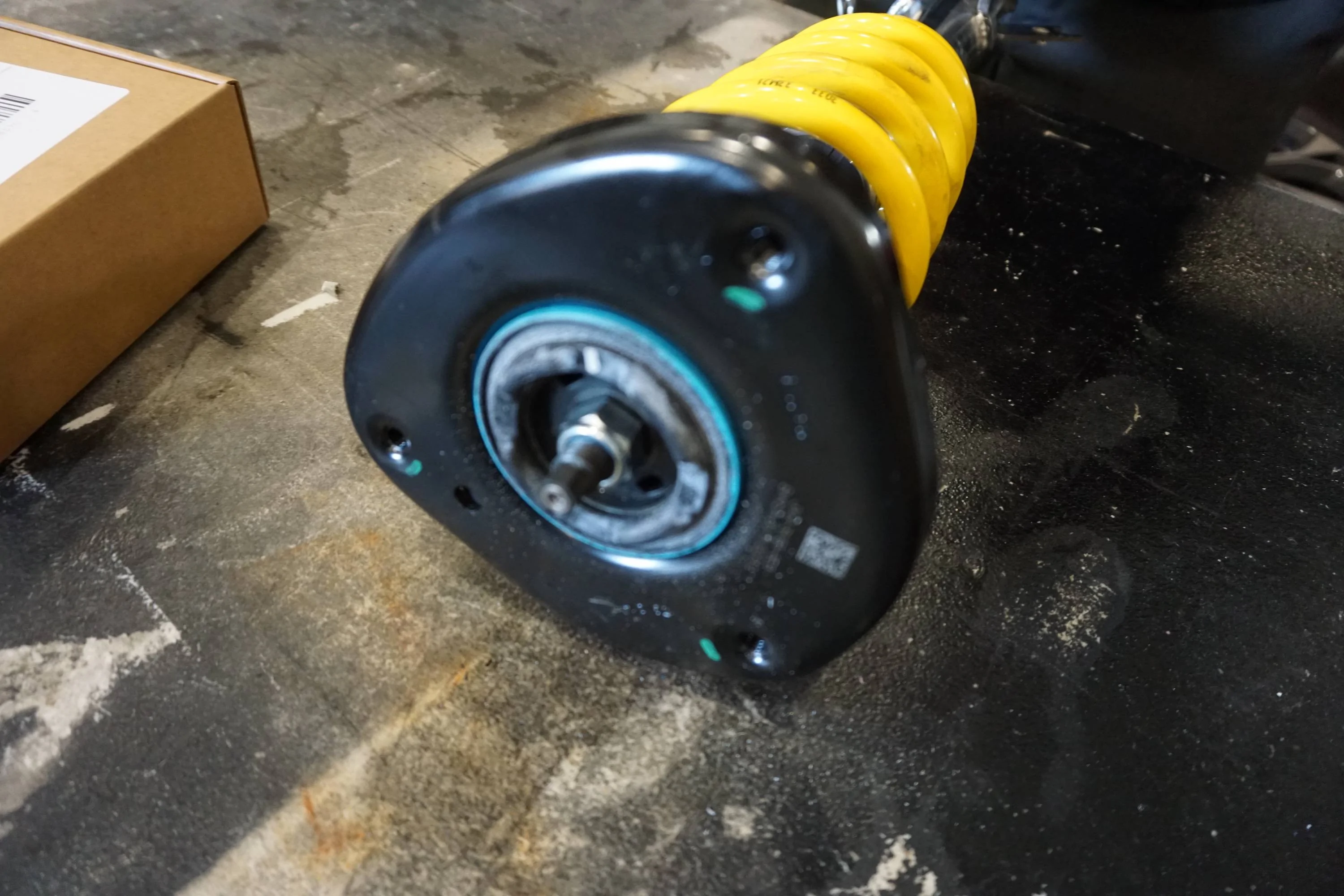

- NOTE: If you purchased spare OEM hardware, SKIP THIS STEP. Remove upper OEM strut mount from the removed strut assembly. A spring compressor WILL be required for removal. Set upper strut mount aside for use with KW coilover.

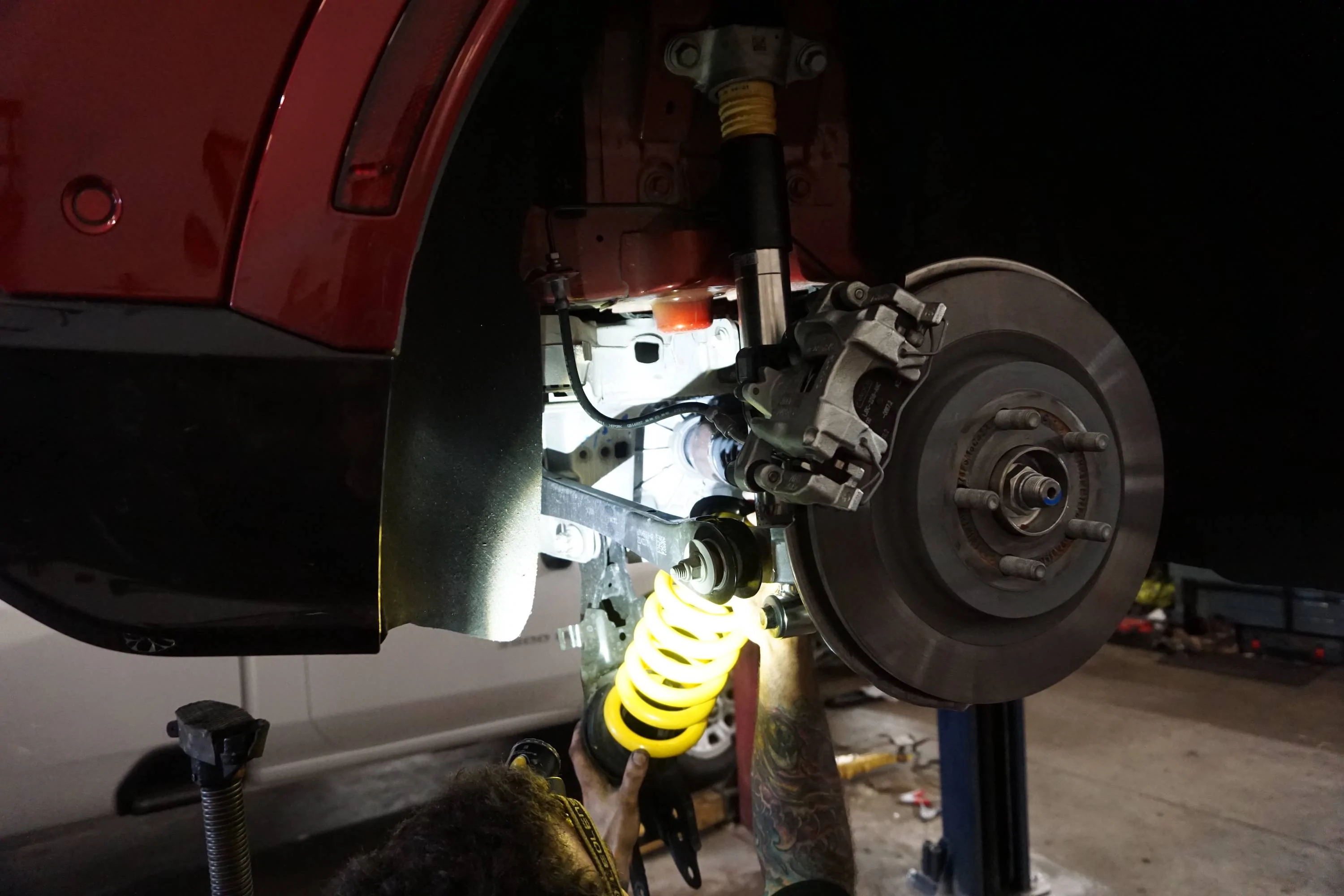

- Install the OEM strut mount to the front KW coilover. Follow the KW installation instructions for proper orientation of KW-provided rubber isolators. Torque: 37 lb.ft (35 Nm).
- Loosen KW coilover height adjustment locking collar retention screw, apply anti-seize to the locking collar thread area and adjust to work in the anti-seize. Set height to approximately halfway on the range, leaving locking collar retention screw LOOSE. You will most likely need to adjust height after a first look with wheels hitting on the ground. Regardless, the retention screw can be tightened with wheels ON.
- Insert the KW coilover assembly into the suspension cavity and align the strut top mount to the bolt pattern on the chassis. It only fits one way. Install and fasten the upper strut mount to the body. Torque: 22 lb.ft (30 Nm).
- IMPORTANT NOTE AGAIN: Knuckle bolts are SPLINE BOLTS. Install knuckle bolts until the spline channels contact the knuckle spline grooves. Tap in with hammer until fully seated. Install and fasten knuckle bolt nuts. Before fully torquing down, roughly set alignment to captured position, prior to OEM strut assembly removal. Torque: 173 lb.ft (235 Nm).
- Align brake line bracket to the KW coilover assembly. Install and fasten brake line bracket bolt. Torque: 97 lb.in (11 Nm).
- Align UPPER sway bar end link to the KW coilover assembly. Install and fasten end link nut. Torque: 81 lb.ft (110 Nm).
- When both sides are complete, install and fasten strut tower brace. Torque: 66 lb.ft (90 Nm).
