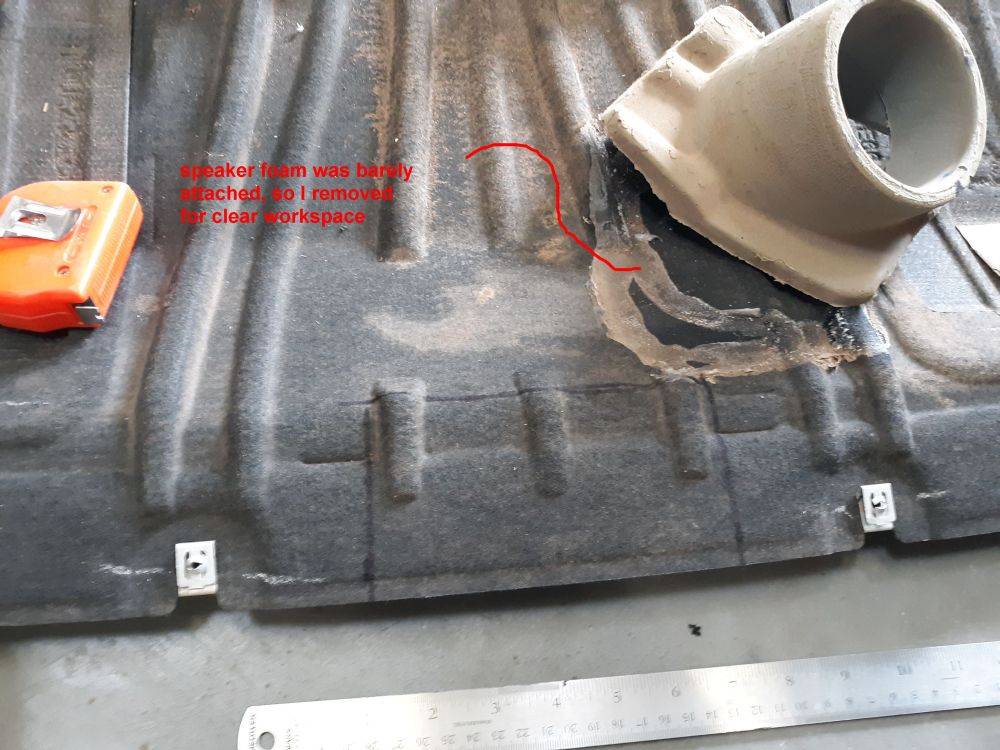

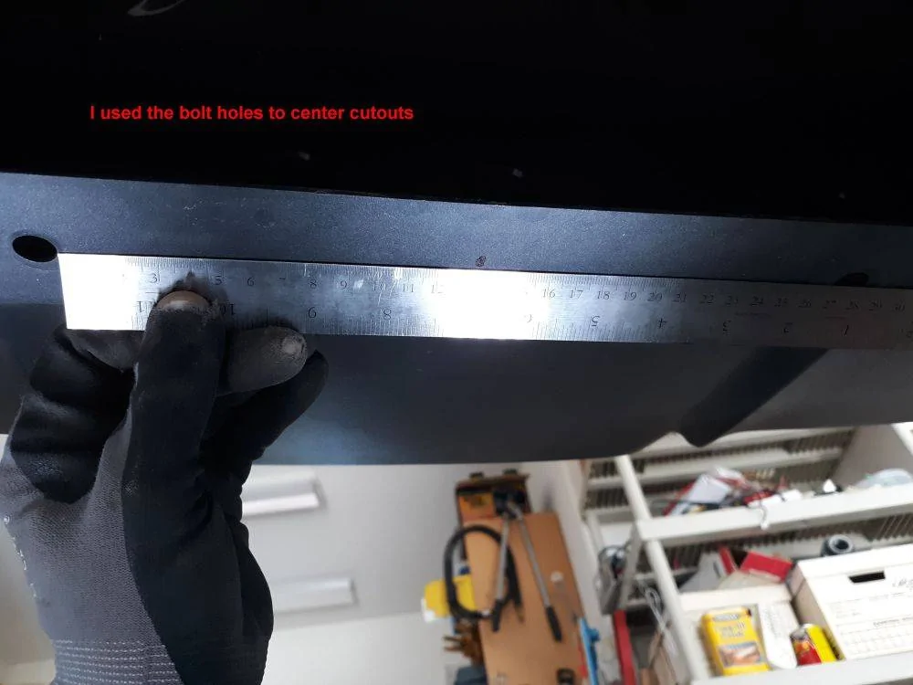

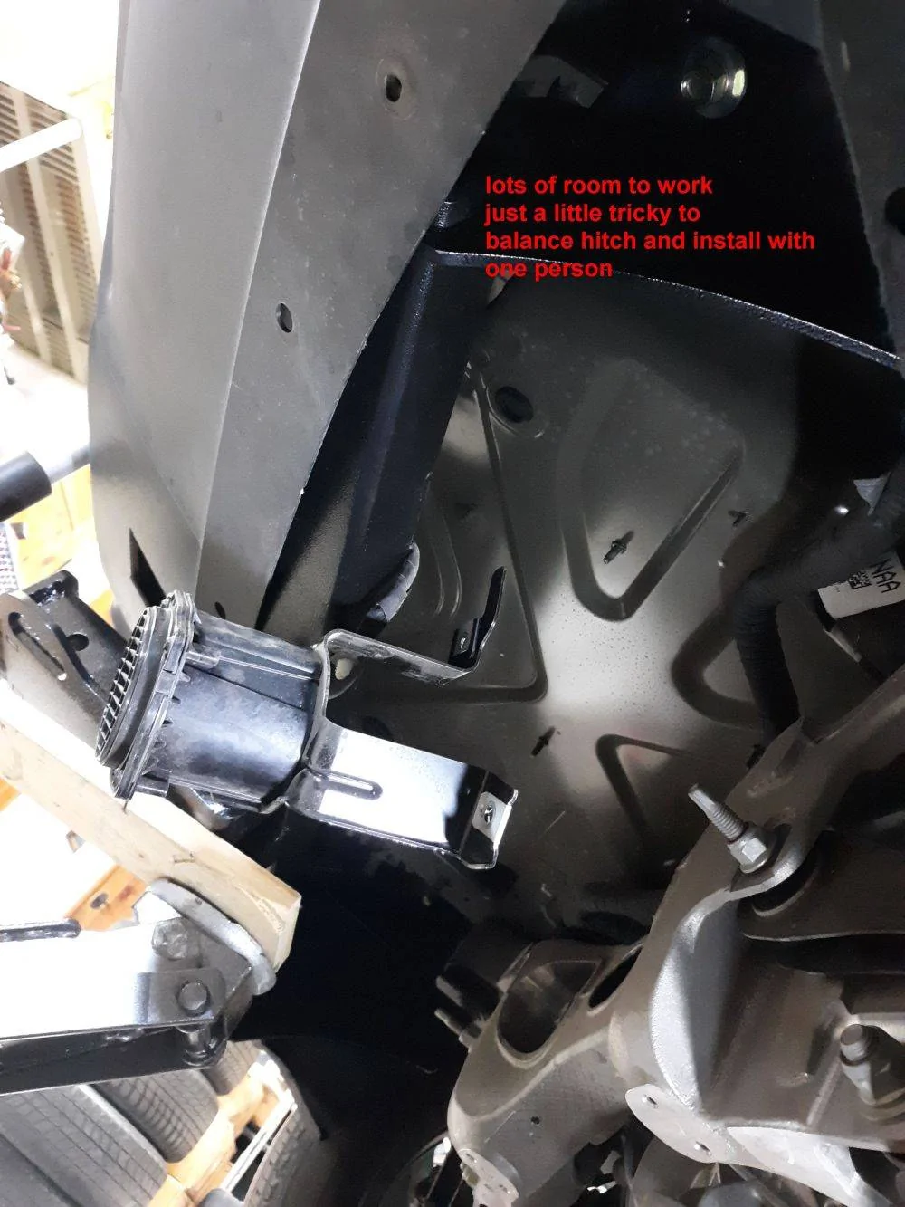

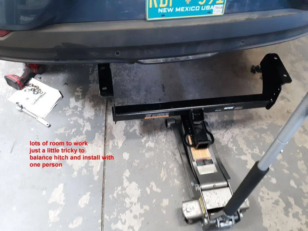

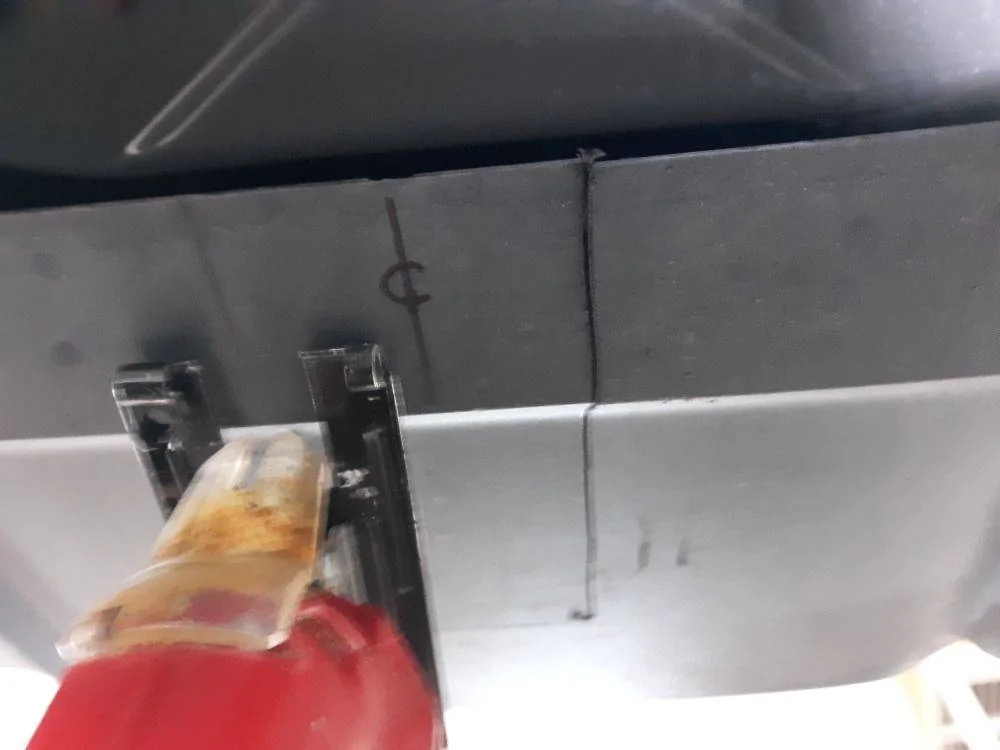

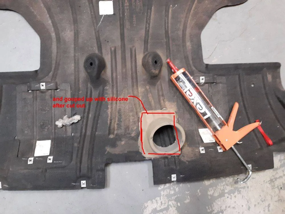

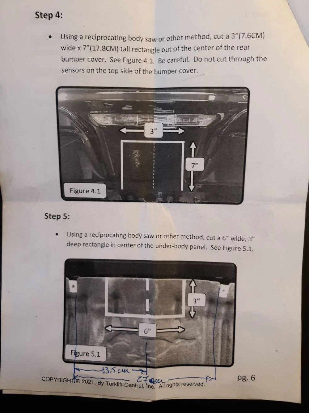

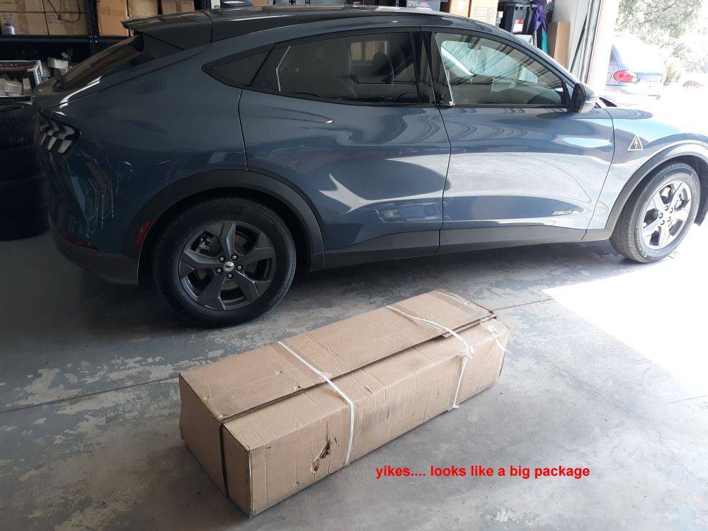

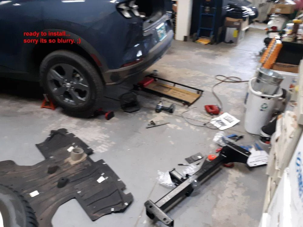

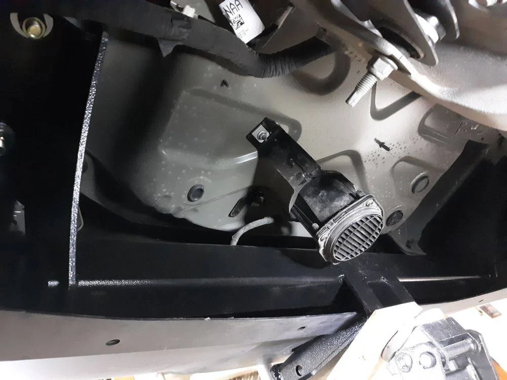

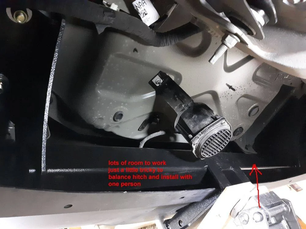

took less than 2 hours, even stopping for pictures.... install instructions were 'ok'. only real issues were:
- 4 plastic fasteners holding rear 'diaper' pan up probably will break on removal, and you 'll need replacements. You might want to get exact replacements if you have a decent hardware store nearby that carries automotive fasteners.... or, use 'regular' anchor bolts with a fender washer under the screw head so that it will be easy to remove the diaper in the future.

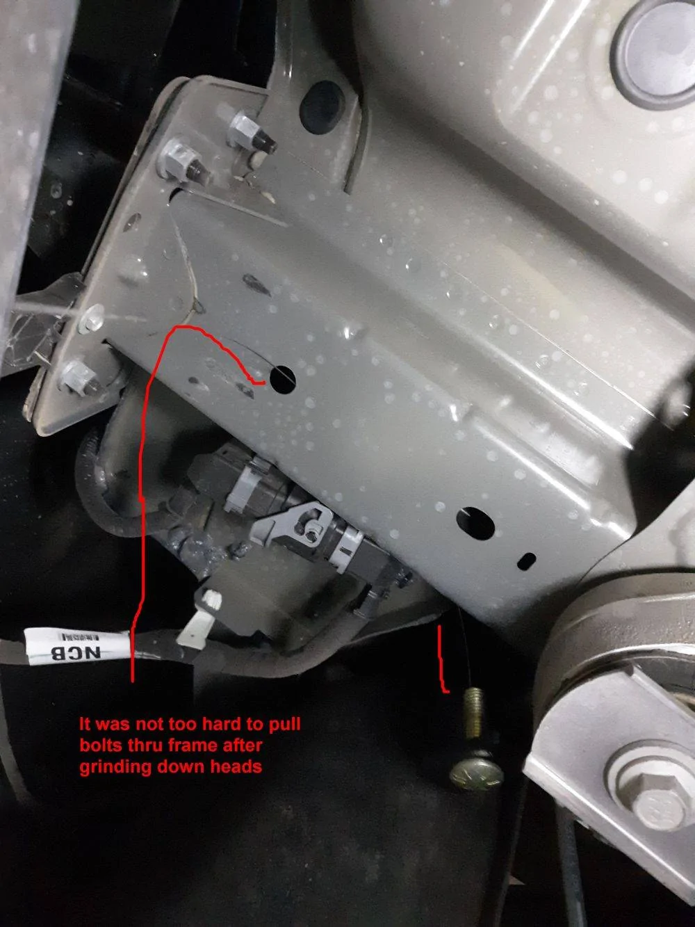

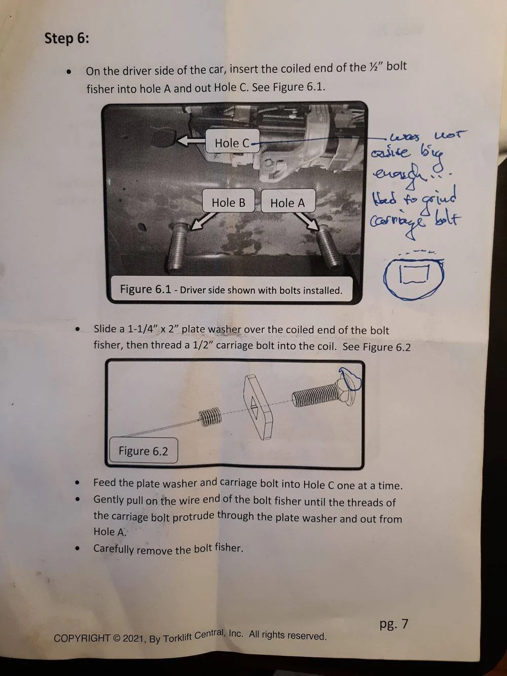

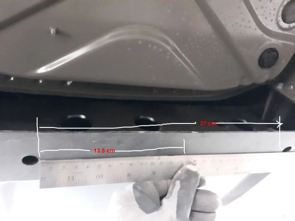

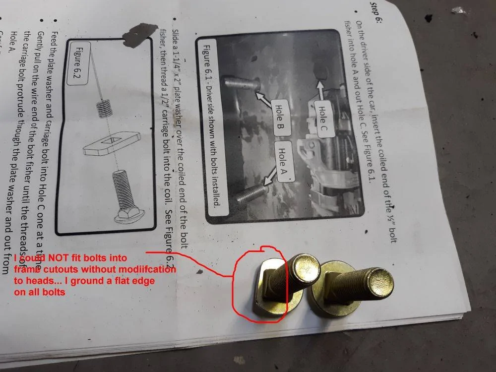

- the 4 included carriage bolt heads *barely* fit thru holes in chassis rails, and you *probably* will need to grid them down to fit thru holes. Or, try sticking the head in FIRST; but be careful not to lose the fish wire off the thread end!

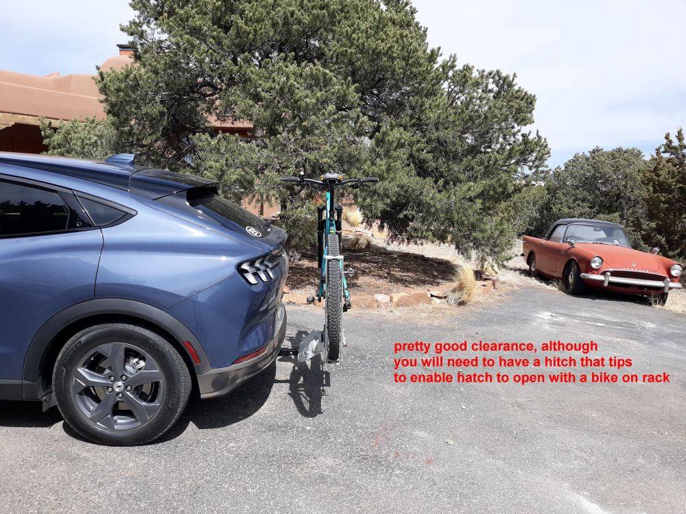

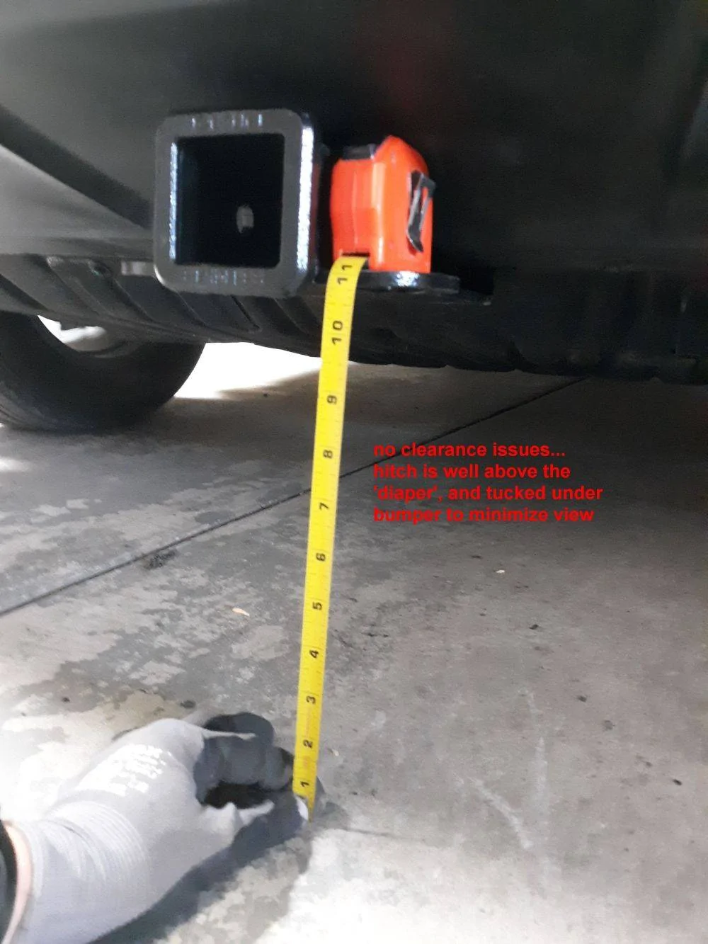

I got my hitch from Torkliftcentral.com directly, it is the 2" steel version.

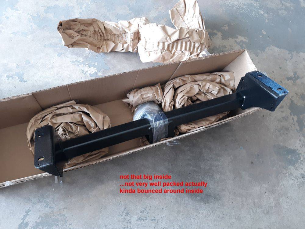

...I think they are now offering a stainless version, and may offer a 1-1/4" version. At the time I ordered, there was only a 2" version.... very beefy at 42.5# including hardware.
There are NO electronics included for wiring lights... but perfect for a bike rack
