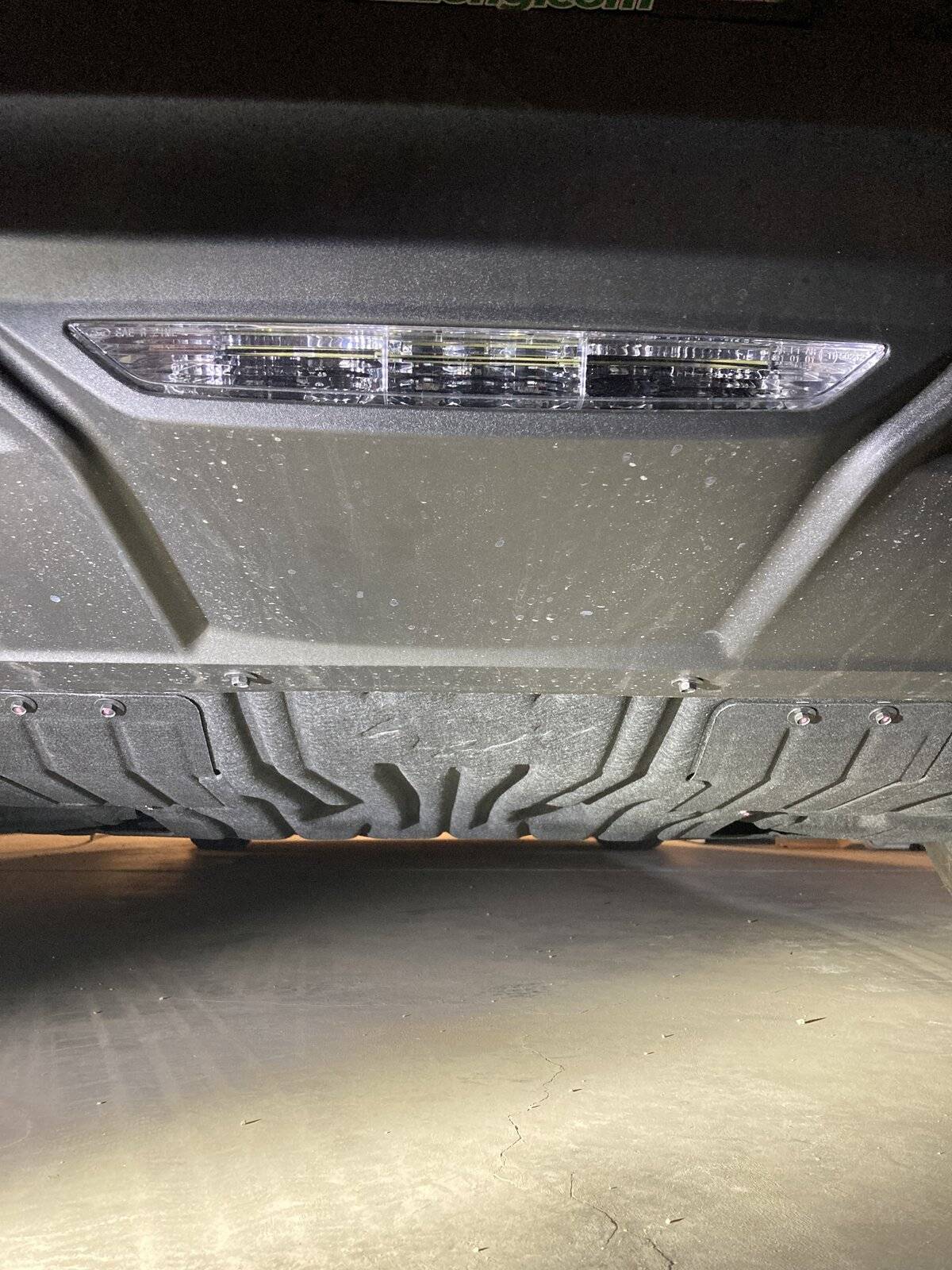

No drilling but you have to cut a hole in the underbody cover to have the hitch stick out. That's why this isn't for everybody. Maybe one day we can buy the Euro underbody cover so the hole is pre-cut.
I can understand the reluctance to cut something on one's nice new car - I felt the same way. But once I got over that, making the cut was very easy, perhaps the easiest part of the installation. Just be sure to measure carefully. You can make the openings a little smaller than the instructions say but note that the hitch (at least mine and others pictured on this forum) is offset a few mm to the driver's side. I got mine very close to being exactly centered by pushing the hitch as far as I could to the right side before tightening the bolts.

Warning for Select owners!!!
My back end doesn’t look the same! I assume this is because I have a Select but it could also be that they have changed things (mine is 4/12/21 build date). My car doesn’t have a “diaper” and only has one piece of plastic that houses the reverse light and wraps up to the bumper. I haven’t tried to take this off yet and was wondering if anyone else has tired this install on a non-diaper model?
Your select is not different than mine. The 'diaper' is the piece between bumper and bellypan
