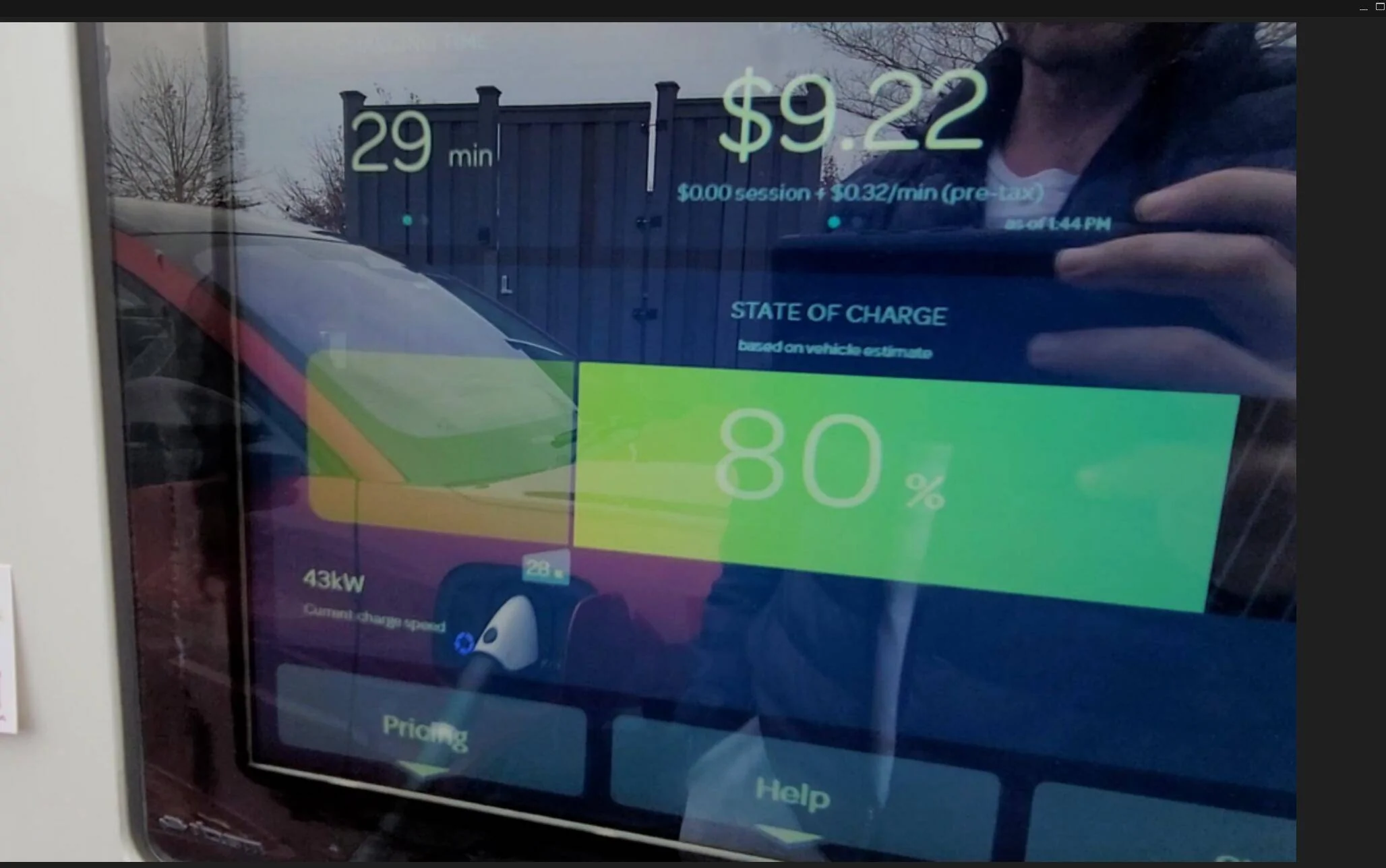

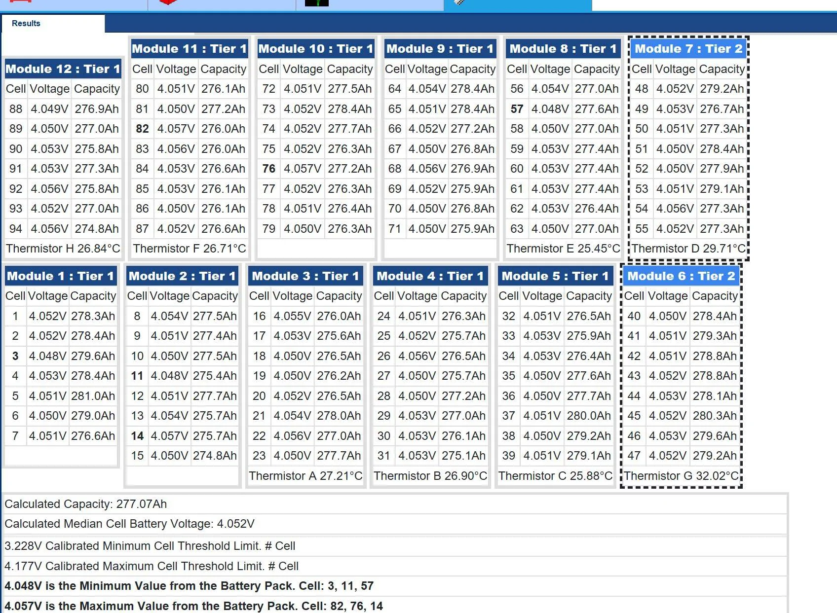

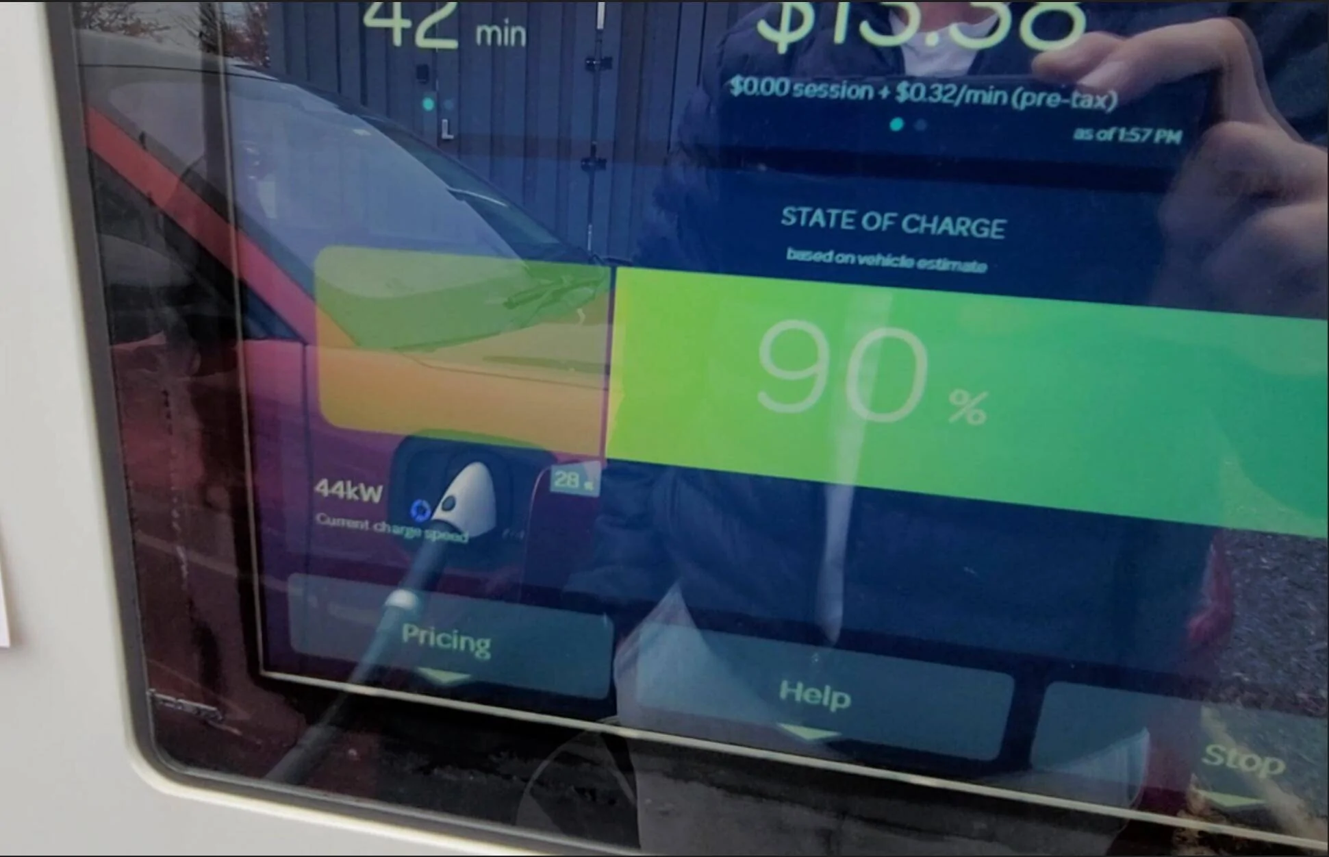

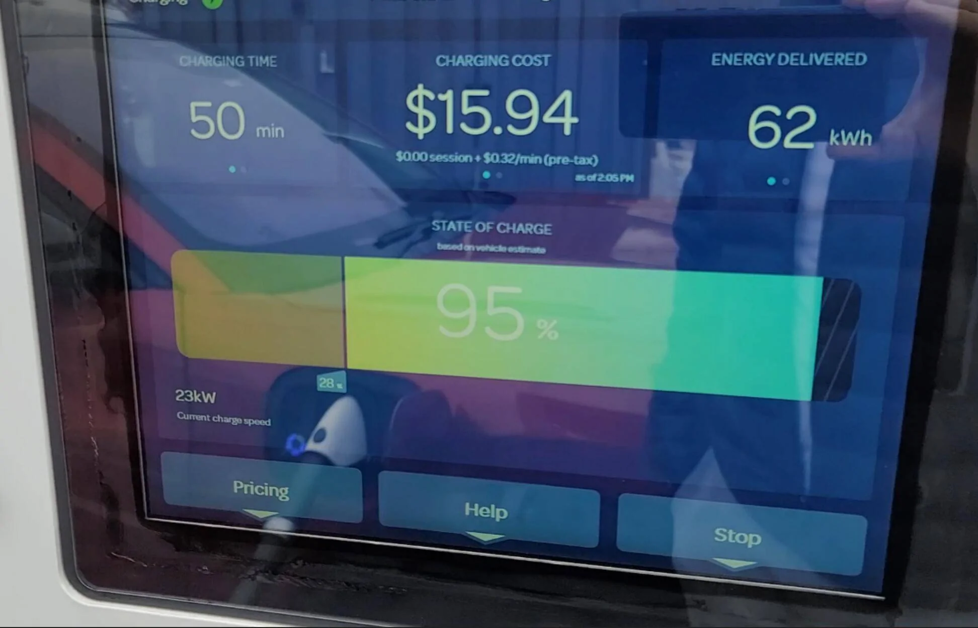

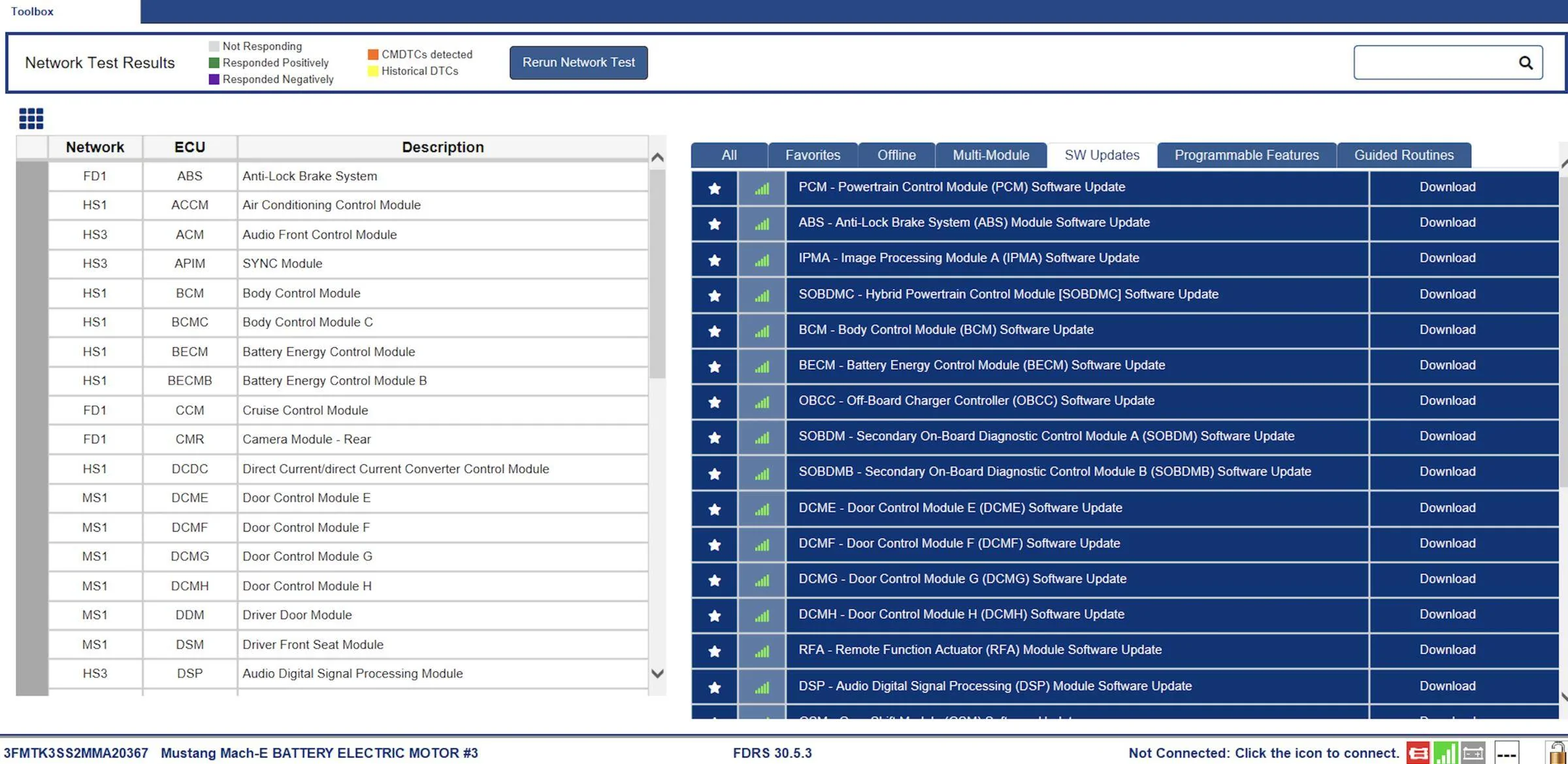

Over the weekend I performed software updates on my Mach-E as outlined in the sticky post The Complete DIY Guide to Updating Your Mach-E with FDRS (Alternative to Forscan). Everything went smooth except the APIM Sync Update. The one that requires USB stick. Tried multiple times with different software and hardware combos but no luck. Below are some pics and video. Noticeable differences are DCFC speed and PAAK has not failed yet since Saturday evening.

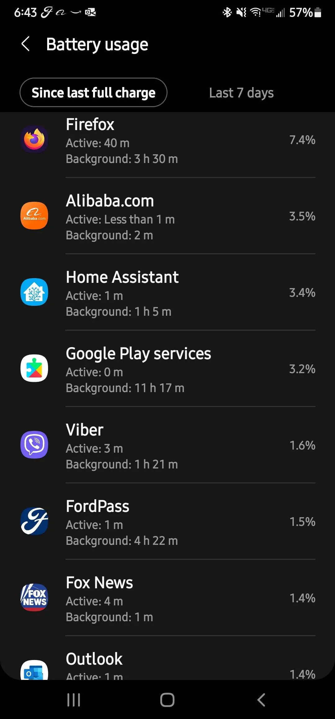

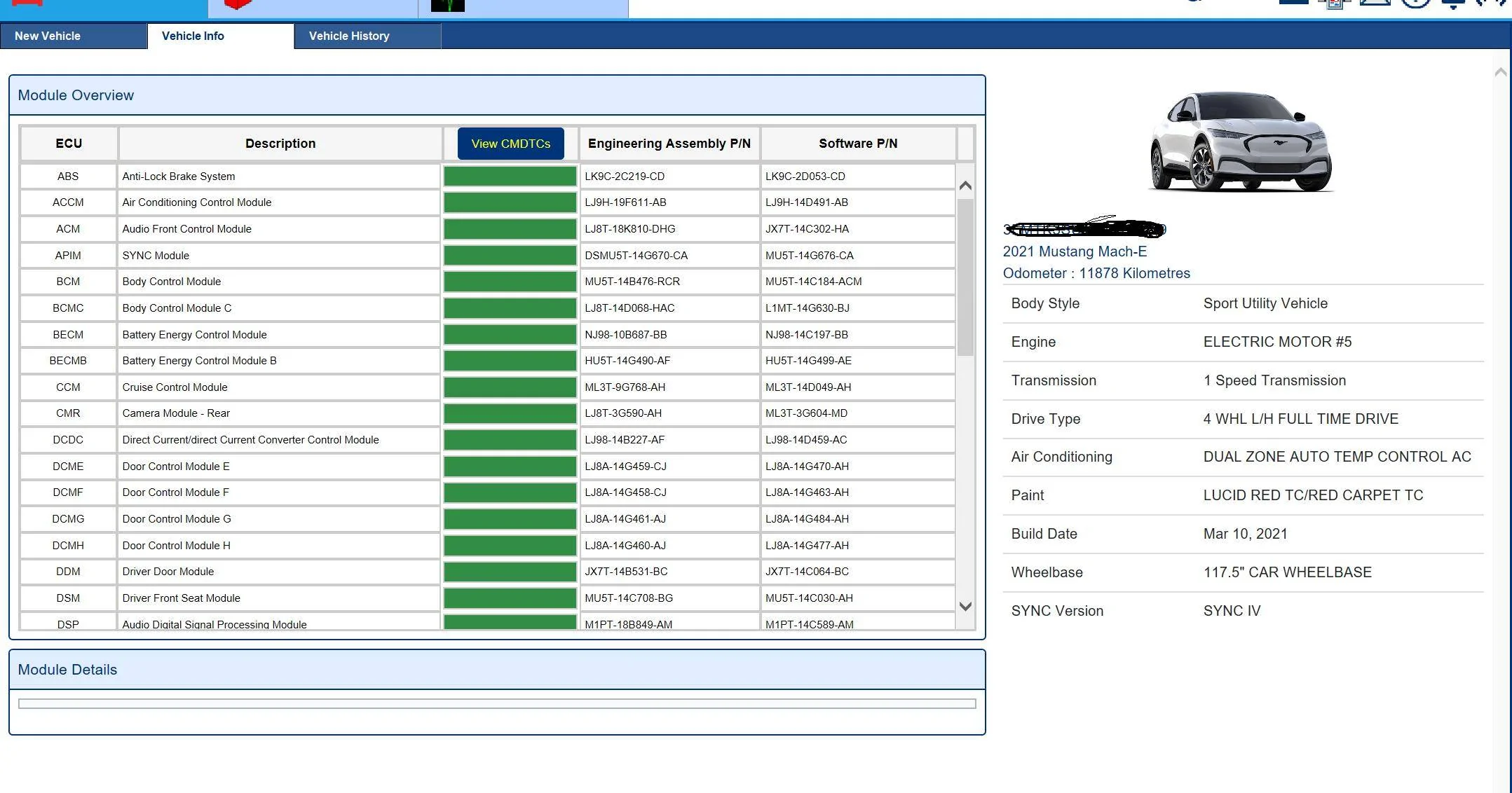

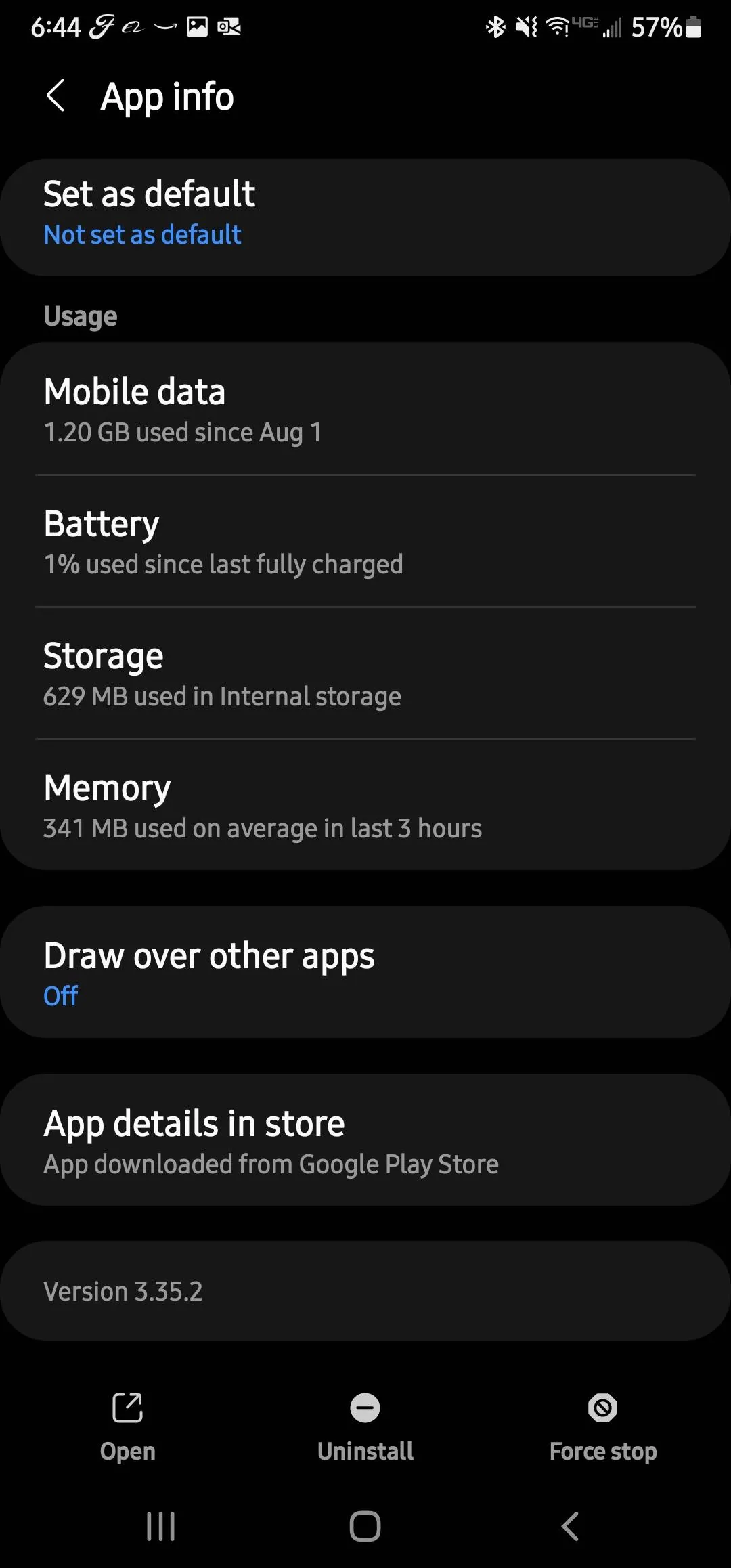

Update: After 48 hours PaaK is working perfect after updating software via FDRS. See images below. I cant believe that Ford Pass 3.35.2 is using that much less energy on my phone. It used to be number one energy consuming app by far (up to 20%/day) I hope this not just some weird stroke of luck that will fade away.
