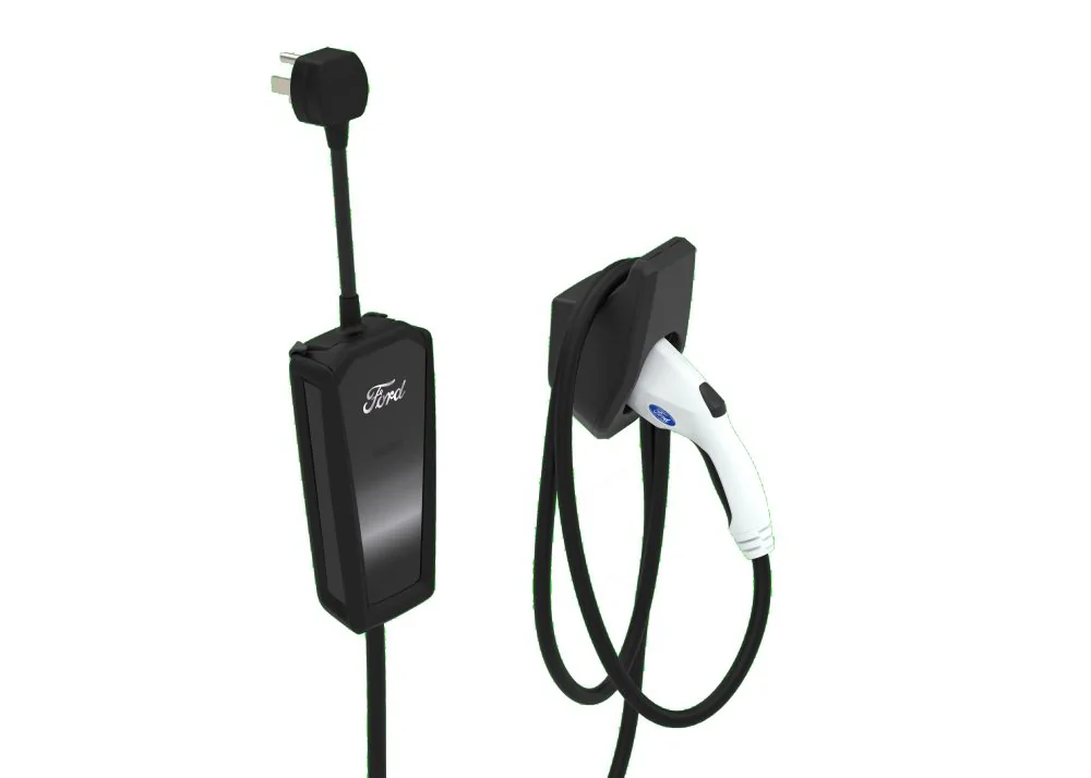

The MME comes with a 120 V/240V probably a 12A/h-32A/h portable charger (Level 1 and 2). Let’s calculate charging time a little bit. Of course car manufacturers always give you the empty to full figures, but this will probably never happen unless you come home behind a towing. For example with the 120V 12A/h supplied charger it will take roughly 53 hours which you calculate as follow 120V X 12A/h= 1.44 kW/h and 75.7 kW/h /1.44 kW/h = 53 hours. In the EU because it is 240V that time would be cut in half. Not good. But let’s see for my average 40mi/65km which is only 19% of the battery capacity of 210mi/335km or 14.4 kW/h of a 75.7 kW/h battery. With the same formula we then have a 14.4 kW/h / 1.44 kW/h= 10 hours so overnight charging would be sufficient for many people’s daily commute only with a 12A/h charger. Now for the 32A/h it will give us a 7.68 kW/h capable charger which for that 19% daily usage will require 14.4kW/h / 7.68kW/h= less than 2 hours. Better if you have a reduced electric tariff outside peak hours. And don’t forget EV batteries are happy charging at a slow pace.
Based on these numbers should you install a 40A circuit to use the 32A/h portable charger supplied with the MME? Well just let’s say that this charger might be expensive to replace if need be, has some Nissan Leaf owners have find out. Now if your charger is installed inside a
garage and don’t have to deal with the elements you will only have a Nema 14-50 plug on a 40A circuit to install. Personally I will get a 32A/h wall charger with the Nema 4X weatherproof rating. This is the highest exterior rating because not only is it waterproof but also humidity proof. I will then keep the MME portable charger in the car, has a spare tire kind of, and use it on family visit far from home or Nema 14-50 available chargers on the road if needed. It’s important to say also that installing a Nema 14-50 plug for a wall charger, your MME portable charger can be used as a spare if your wall charger needs repair.
So my final exterior installation will have a 50A circuit, (future proofing) the maximum for a Nema 14-50 plug, I will get the Global Industries EV One 32A/h variable current output charger (can be set between 8A to 32A on the 32A model, as we don’t know at this time if the MME will have the capacity to select variable input current like in the Tesla’s, with a Nema 14-50 plug and Nema 4X weatherproof rating and a 5 year warranty, operating temperature between -40F and 104F/-40C and 40C. An app is also available as an option, but we will have access to everything needed for charging from the FordPass app already. It is available in Canada at the https://roulezelectrique.com/ boutique (they have video on their french site but it’s worth watching) or for the US I believe directly from the manufacturer at https://www.global.industries/product/ev-one/. It is also important to note that for cold regions it is important that the charging cable remain flexible at very cold temperature like -22F/-30C.

As the question is phrased, no, there is no absolute need for a wall charger. I would suggest that it is absolutely necessary to have an accessible plug: Either a normal 120 or 240 volts. Which one you choose really depends on how much time your car will be plugged in sitting at home. Many people will tell you that a 120 outlet is simply not enough because it will take you three days to fully charge your batteries from empty. This however leaves out the next question which is "How often do you have to charge from zero to full"
A 120 outlet will charge three miles per hour. If you are out and about for ten hours a day, then that leaves you 14 hours of charging time or forty-two miles of range gained overnight. If you are commuting thirty miles of day you will be able charge back to full or gradually build back twelve miles each day from those days where you exceed your normal travel.
The problem comes in when you have several days in a row of extraordinary usage. In the extreme case, if you drive three hundred miles on one day, you will only be able to build up forty-two miles of range by the next morning. Either you make a trip to a level-3 charger for a DC fast charge, or no long trips on day two.
Alternatively, if you have a 240 plug, then you can gain twenty-one miles per hour, or 294 miles of range in a 14-hour charging period. This means you can go from zero to full charge every day.
It is worth mentioning that both above options are supported by the charging cord that comes standard with the Mach E. No wall charger needed just a standard 120 or 240 outlet.
So why a wall charger. The simple answer is convenience. Having a wall charger means you can keep the charging cord in its case and in the car so that it is always available should you need it either in an emergency situation, or when paying a visit to far away friends or relatives who don't mind you plugging in overnight.
There are some other benefits that can come with more sophisticated wall chargers that can communicate with your phone or with your Ford App or give you status updates. How important these features is up to the individual, for some they are a nice to have feature, for others it's just another way for companies to collect data regarding your day-to-day activities.
