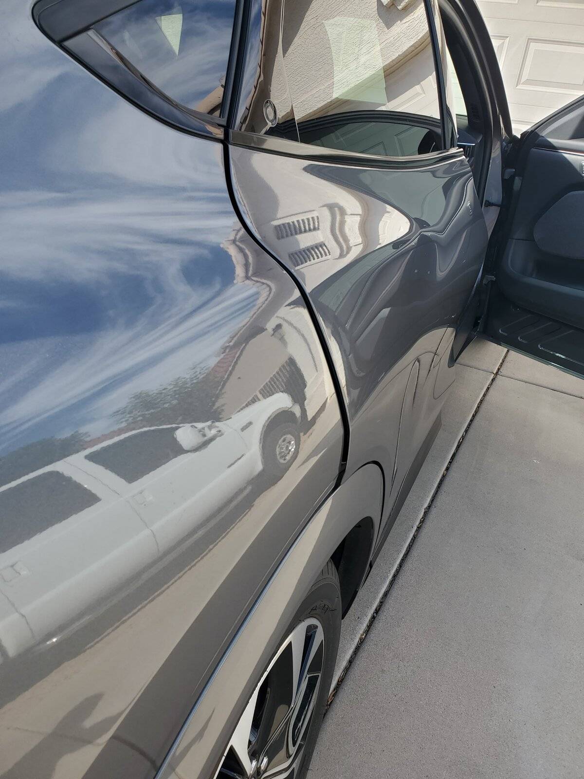

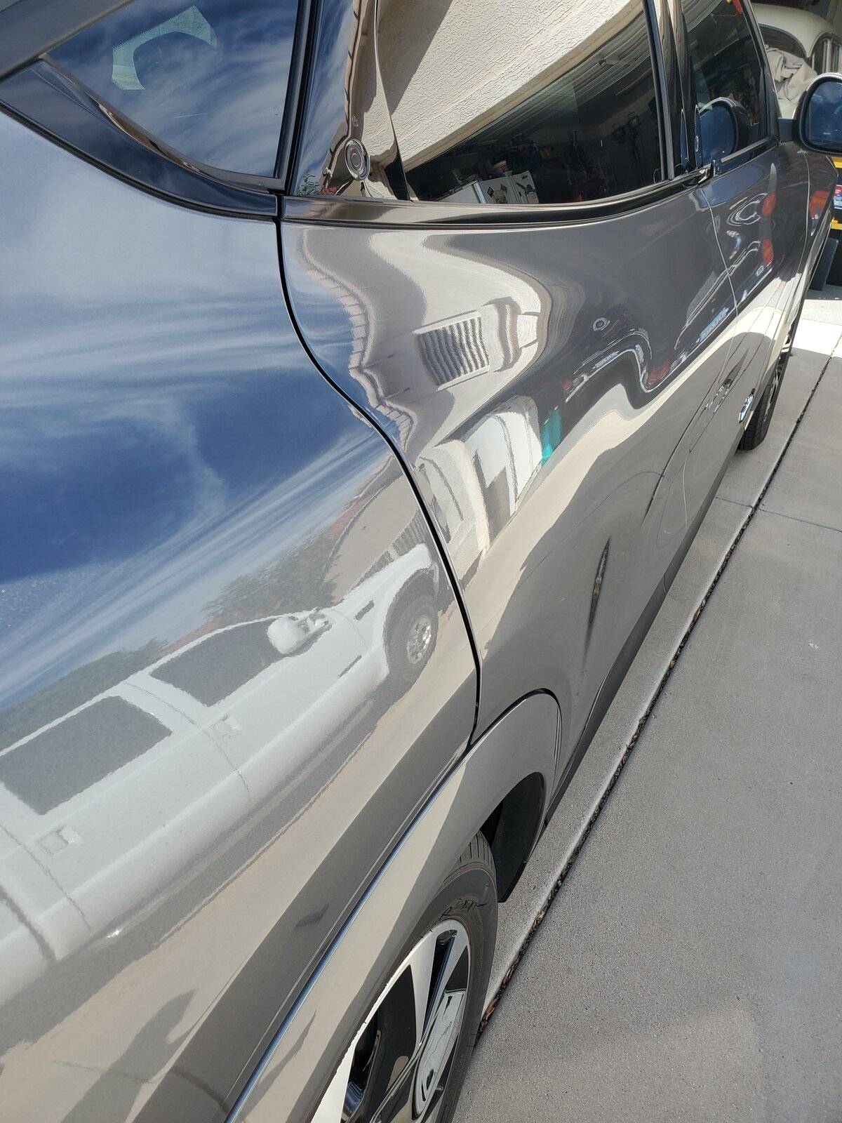

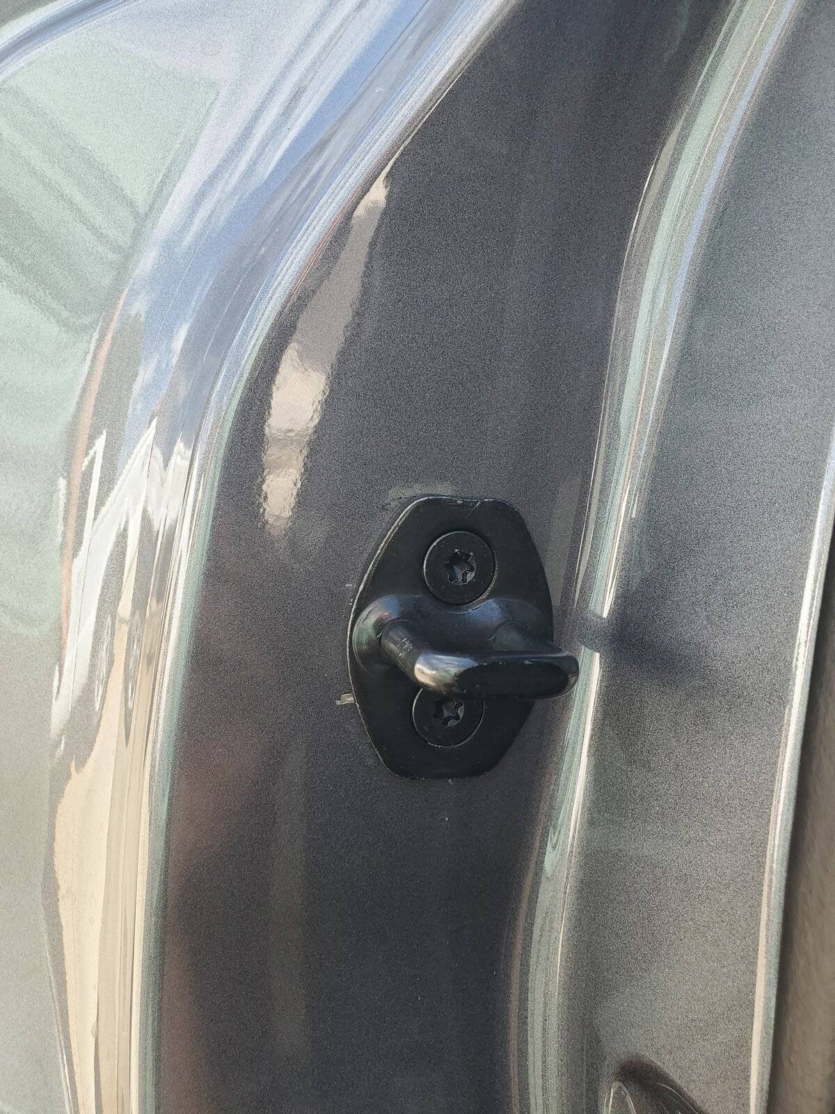

My wife noticed the left rear door wasn't closed completely and tried opening and closing a few times but that didn't work. I took a look at it and noticed the striker plate was loose. There were scratches/witness marks in the paint showing it's original placement so I moved it back and tightened it up. Will have to touch up the paint damage from the loose plate. Hopefully my touch up pen arrives soon (been a few weeks already....)
In case anyone else ends up with loose fasteners....the bit size is T-40.
