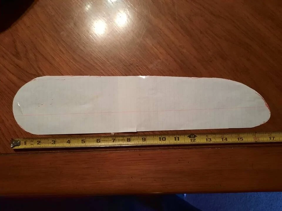

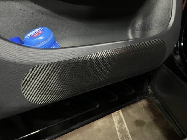

Even better, here's a pic. At it's widest it's 4" I used the carbon film from RVINYL, six months and still holds beautifully with no lifting. If they didn't send you a squeegee use an old credit card to apply, it reduces air bubble issues. As I recall I wiped the area down with diluted rubbing alcohol beforehand.
https://www.rvinyl.com/3M-Wrap-Film...MIqIi8wczN3gIVAx6GCh1TagEsEAQYASABEgLgSPD_BwE
btw, nurse here too, retired 3 years ago, 30 years ED, CVICU, Behavioral Health, Jail Clinic, PACU
Thank You @zvez. That photo will help lots of people I’m sure. I’ll get mine cut and apply tomorrow. Supposed to be above freezing. Thanks for all you did in your career. Enjoy retirement, when you can pee any damn time you want.
I did 10 years of ER and will hit 10 years of critical care transport / flight in a few more months. I’m sure I’ve got another 10 years before I can consider retirement.

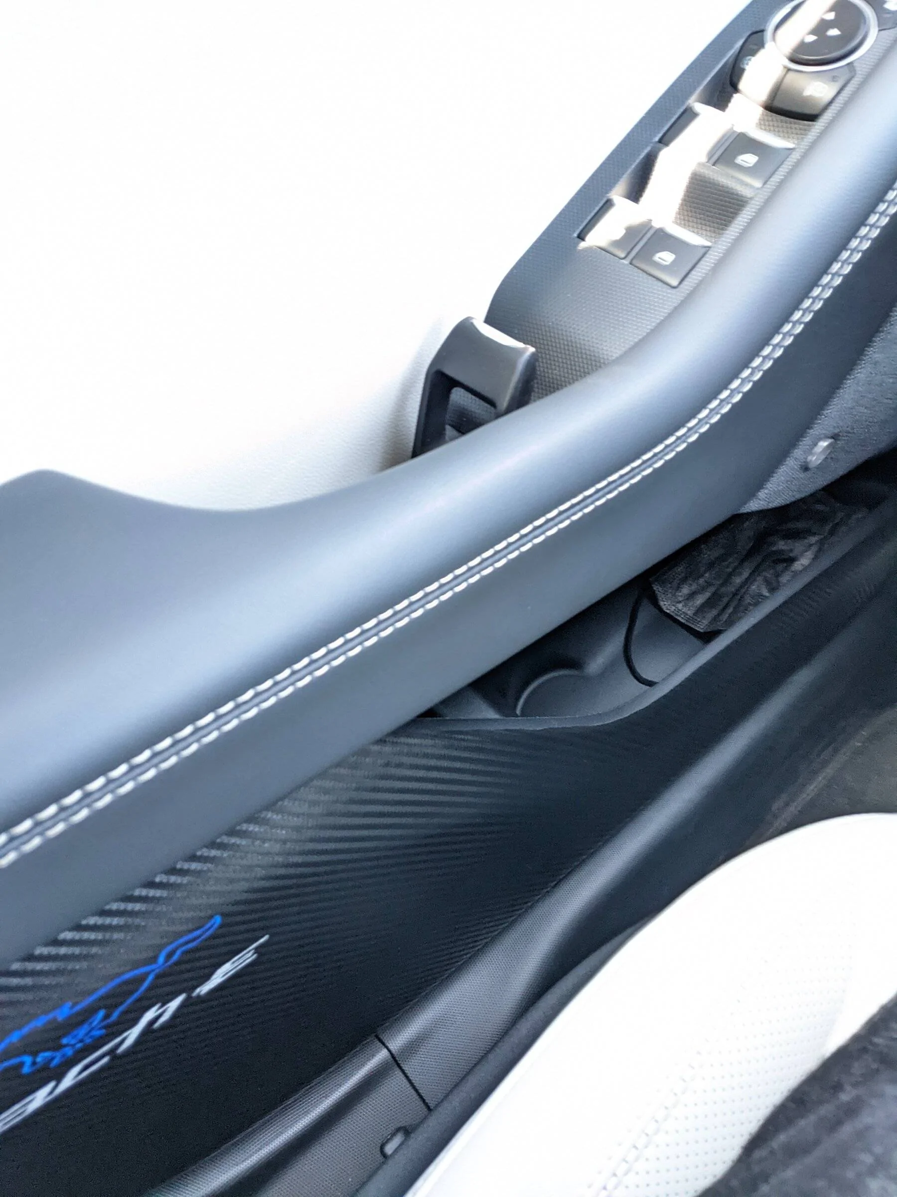

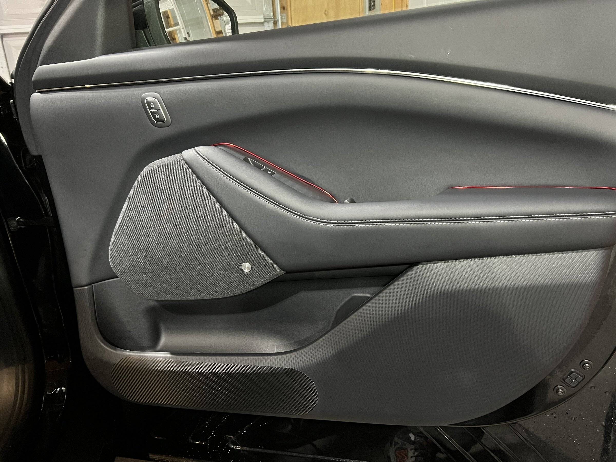

Can confirm that 3M 2080has way better adhesion on this plastic than VVIVID+ Premium film.
@MachEGTPilot If you’re going to try it, go with 3M.

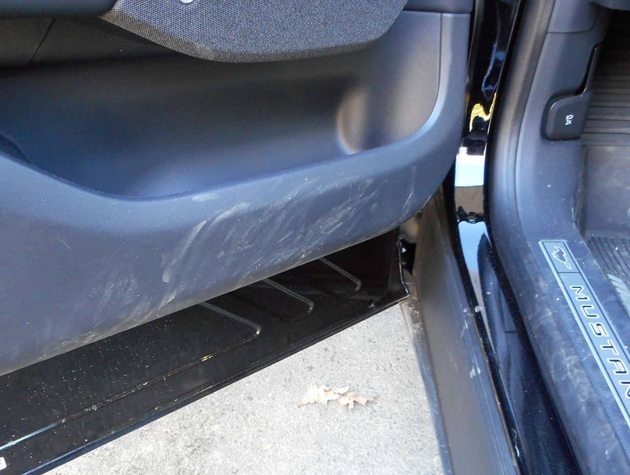

In the old days, door bottoms had carpet at the bottom to catch scuffs and to use to hold the door open with your foot.
