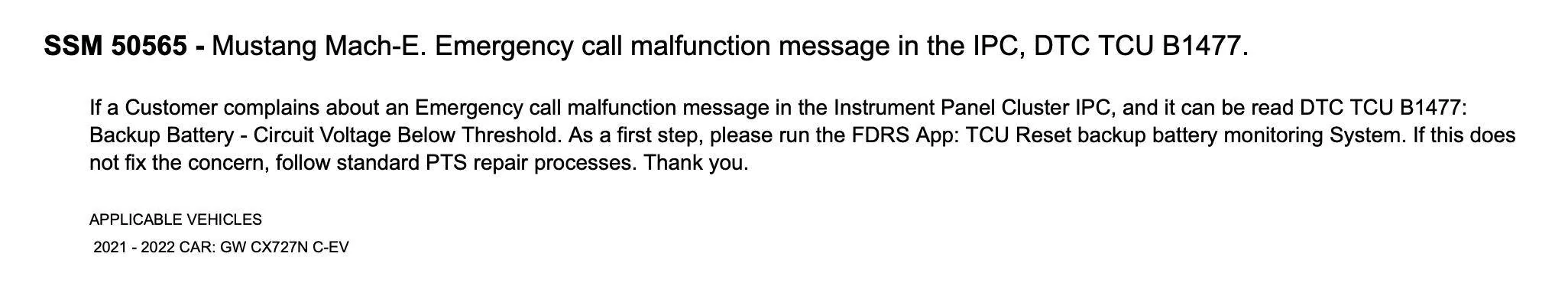

Looked in the search but couldn't find anything relevant other the original eCall fix on the initial batch of cars. When starting I got a message about non functioning eCall and to contact the dealer for service. I noticed that the ecall button was glowing bright red through the cover on the ceiling console.
I switched on and off a couple of times and the message went away and the light was not glowing bright red. Anyone else had this? I'm loathe to take it in when it can't be replicated. (Should have took pictures of the message and light but hindsight is a wonderful thing)
