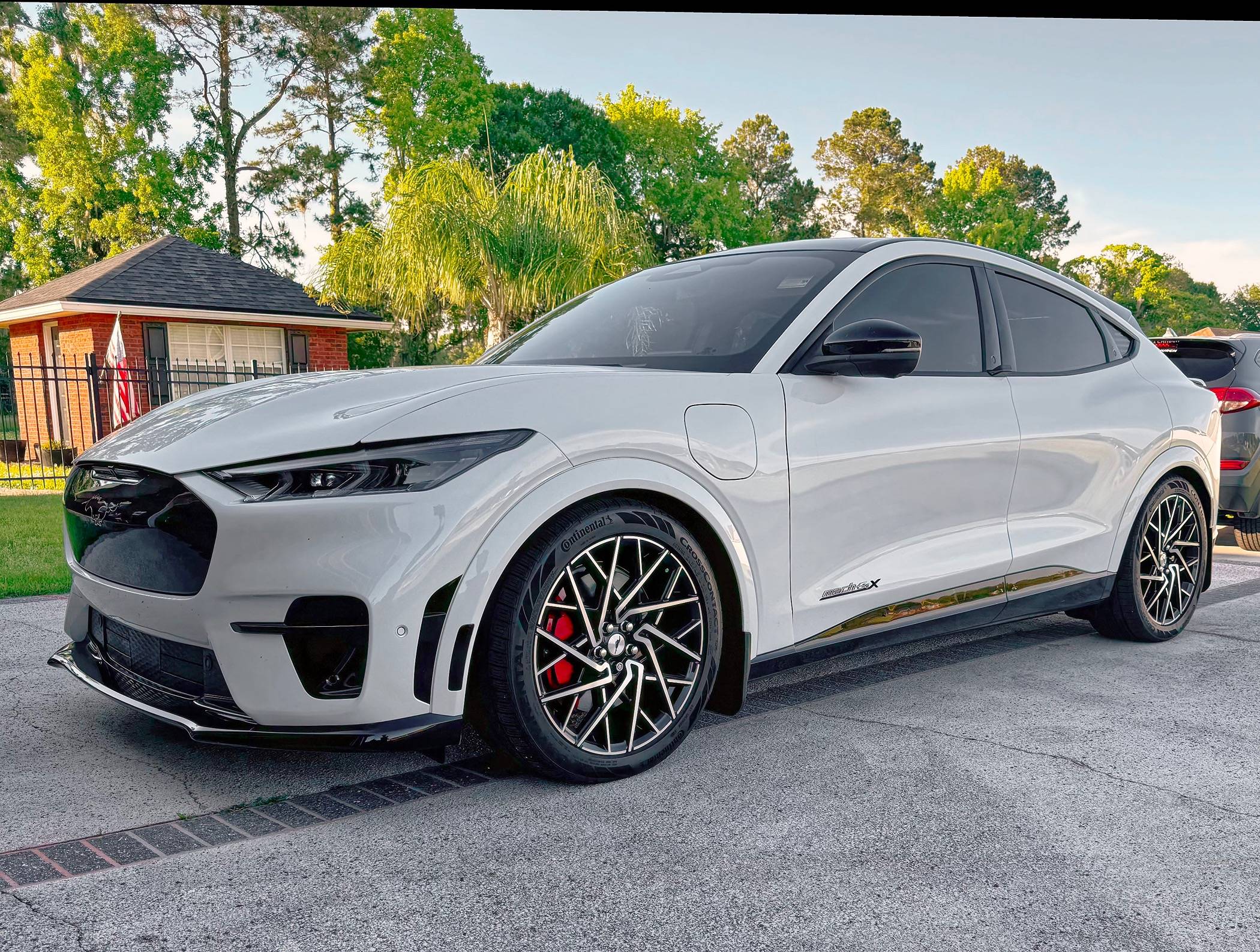

All done. Thanks again to Mark for helping me when I got stuck on the rear springs and for editing this pic. 😎
I took a very short drive and whoa! Definitely the stiffness from the stock springs is way reduced. The ride still has a familiar feel to it but definitely the intensity is dialed back. Can’t wait to get the sway bars on and drive it more.

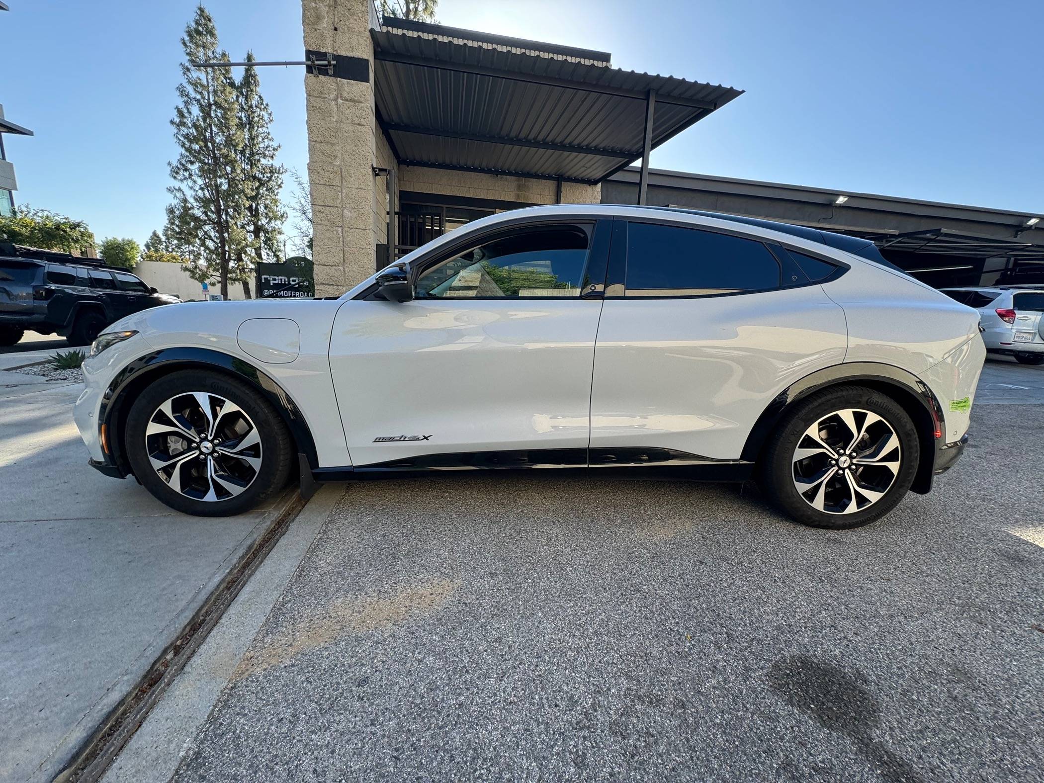

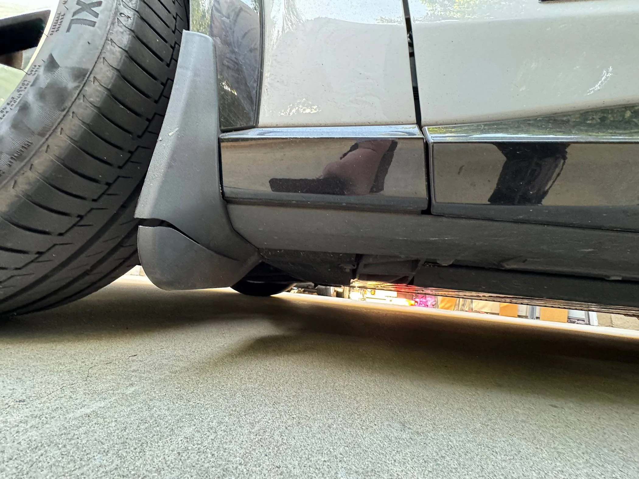

Alright. I did it. Just the springs and it dulls the road imperfections significantly but you still feel it. Big bumps also feel much better. We still need to test a few more in our area.
Springs seem to still be settling as I drove through bumps in a parking lot yesterday with no problem. But today in the same lot, after the front tires go over the bumper, the car touch the bump twice on two different kinds of bumps. It actually broke my mud flaps lol.
The bottom looks fine but I am realizing how much closer those battery rails are to the floor. The back is still high enough to not hit anything.

Hey Calvin, glad to hear the install went well. You must have some high speed bumps for them to break your mud flaps or you went over them kind of fast? There are quite a few speed bumps in our shopping center parking lots and haven’t had that issue yet. I don’t think we have the same mud flaps though. I have the AOSK ones.
Calvin
Apr 16, 2024
Pasadena,CA
Mach E Prem 4X
Yeah i think I went a little fast on one of them. Definitely need to think that I’m back to driving a sedan. The mud flaps are AOSK.
I’m gonna look to see if I can super glue it back together first before committing to buying another set.
