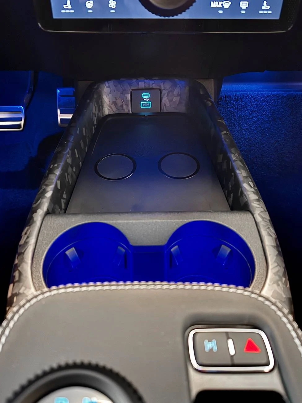

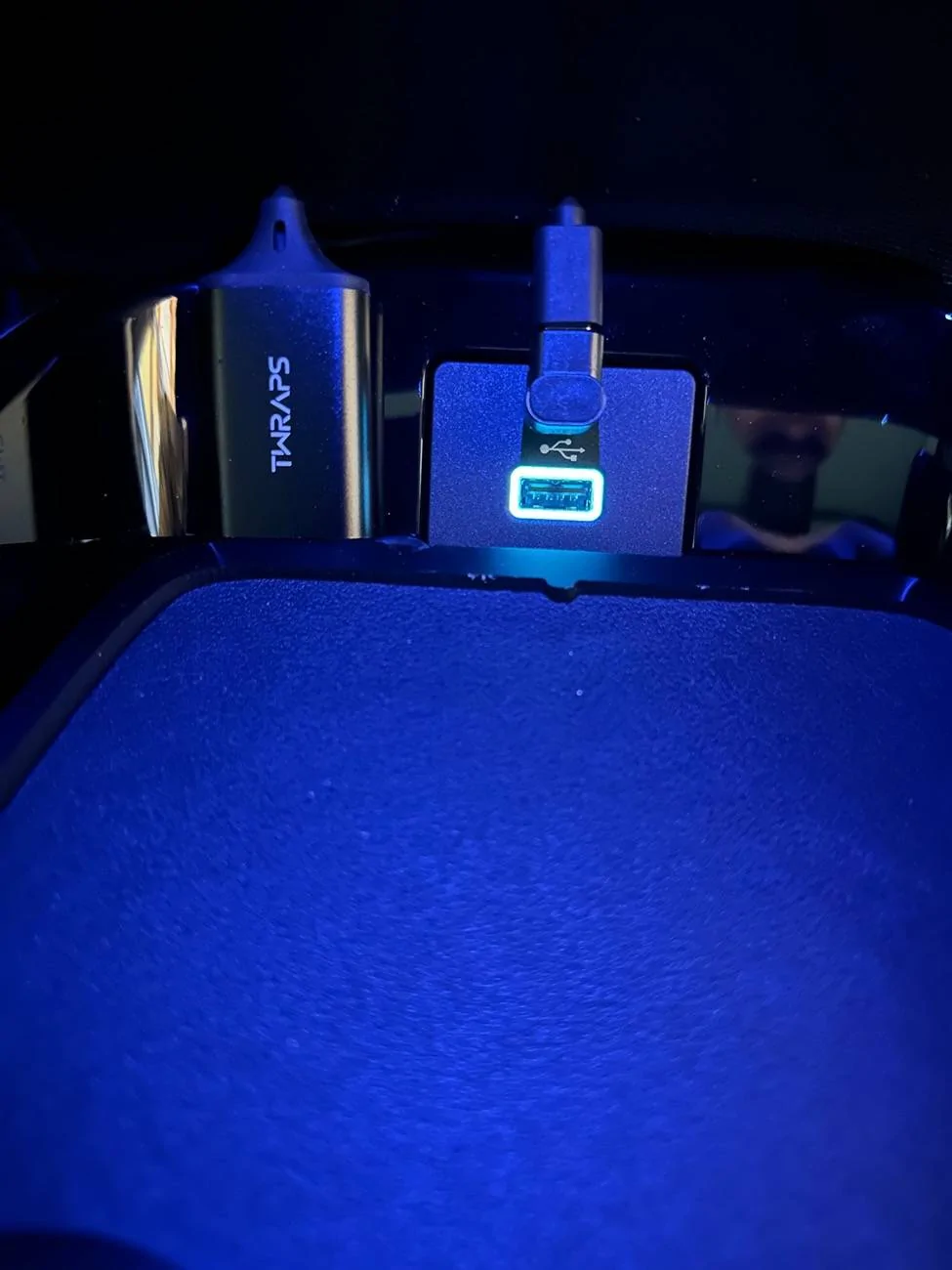

I've had my TWRAPS charging pad for a couple of years now and moved it from my '21 to my '24. One of the best little interior additions I've made to the car. In the '24 I didn't want the power cord to show so I moved it under the console trim panel. I did have to buy another USB module (ML3Z-19A387-D) and piggyback it off the one already in the console in order to power the TWRAPS charging pad properly.

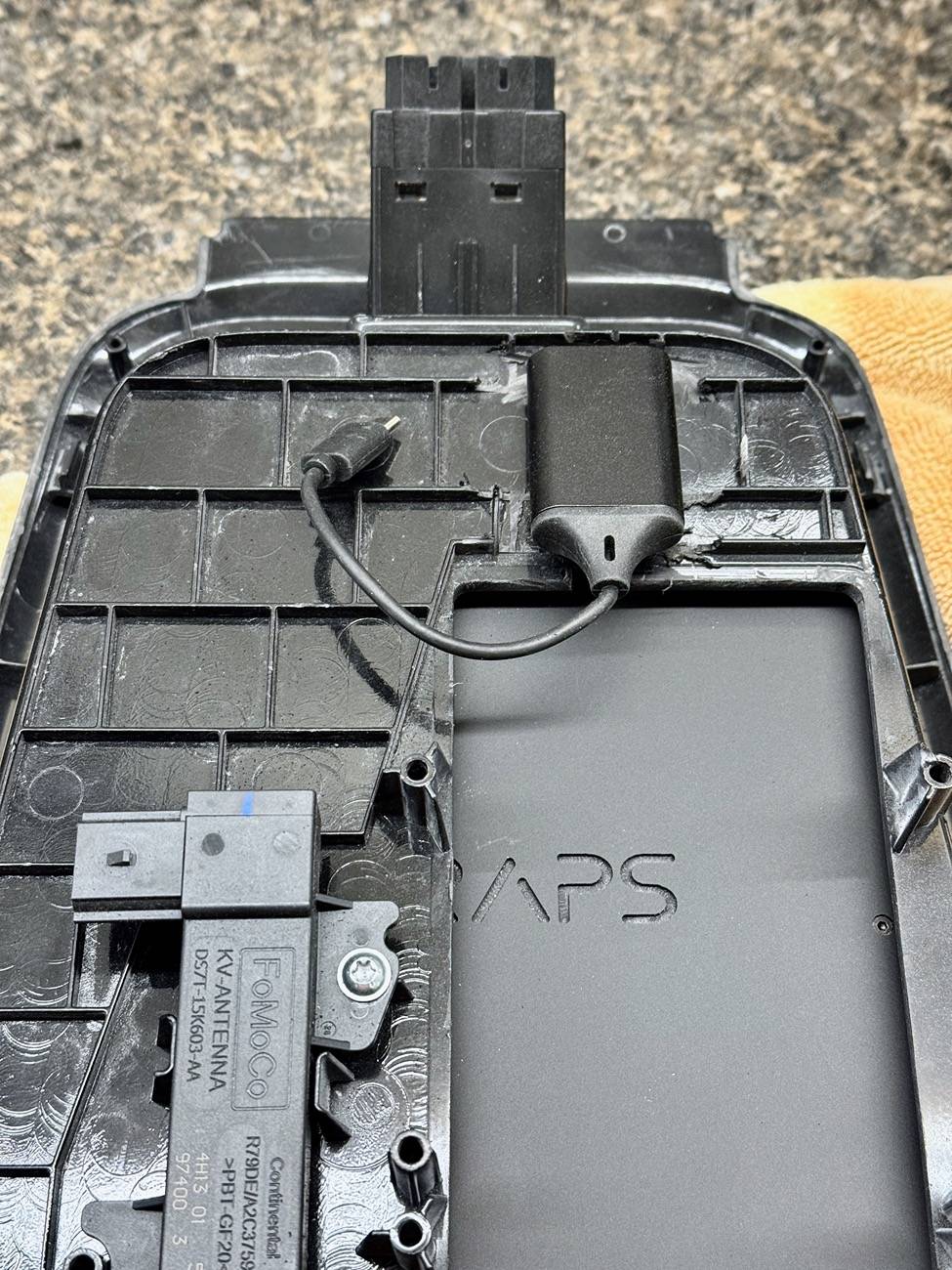

Just these Rick.

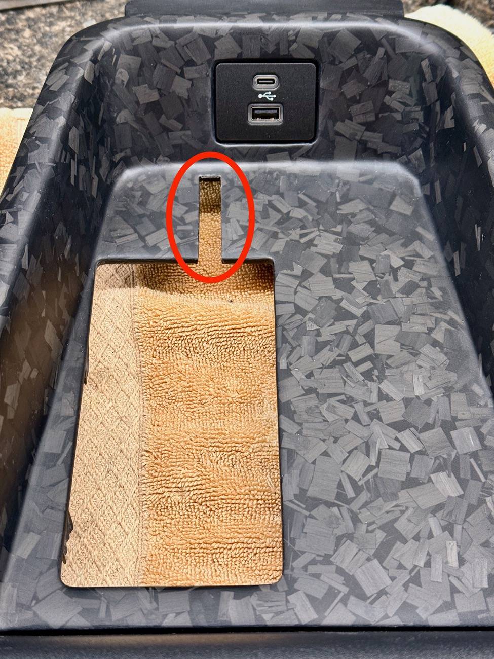

The slot I cut in the bottom of the console trim (I don't have the OEM wireless charger installed).
Ford Mustang Mach-E Elegant solution for phone charging annoyance in Mach-e, for iPhone users anyway! IMG_5121

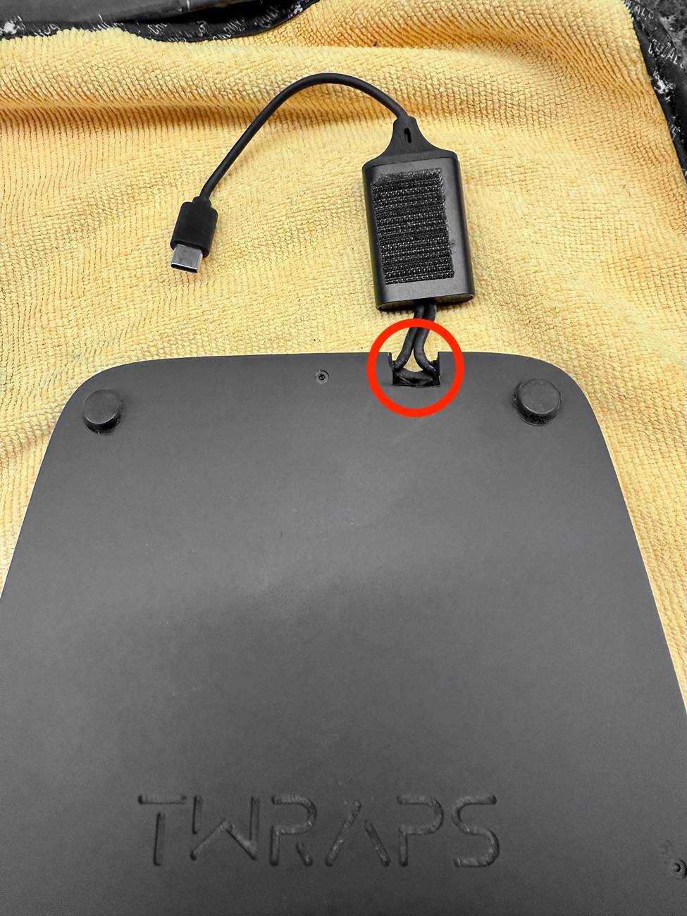

Cut out a small section in the bottom of the TWRAPS charger for the cord to bend down.
Ford Mustang Mach-E Elegant solution for phone charging annoyance in Mach-e, for iPhone users anyway! IMG_5141
Under the console trim with the TWRAPS charger installed. I used Velcro to secure the charger splitter.

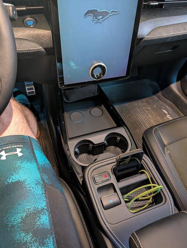

Just got my Twrap charger. I secured the splitter, used the tiniest right angle adapter I could find and tucked the wire away a bit. Not perfect but it helps clean it up a bit.
I just ordered one of these chargers and am happy with it. The slight ledge that accommodates the camera bar on modern phones is excellent, and my mag-safe compatible Pixel phone case snaps in flawlessly. I may look into the slight mod that some other pictures show, tucking the power brick below so it's completely out of sight but it's small and discreet to start with so I don't notice it much when hidden behind my car spare/reader glasses.
My other main issue was having my front passenger be able to charge over wire and not disrupt my android auto session - but the console pass-through to vertical slot doesn't touch the display's connections and works flawlessly for this need :) I like that I can have my phone in that vertical slot if I don't feel like charging (work iphone in picture for reference) while the cable still comes out for my passenger; bonus that the cable color nearly matches the car color :crackup:
