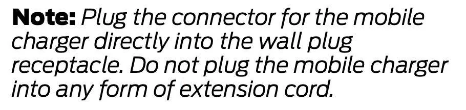

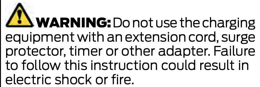

PSA- I found the Ford EVSE doesn't much care for extension cords on the 110V side. When I tried it with a 12G wire cord it worked fine. Not sure if its a resistance issue or grounding path. Suggest if you are planning a trip and need to use an extension cord try it out first before you leave.
