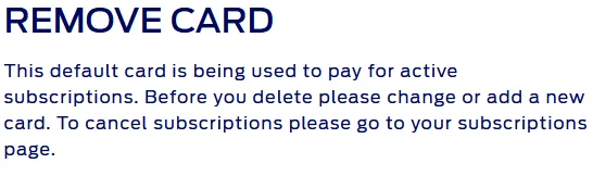

Once you factory reset the vehicle you will be locked out of the connected services section of the Ford website. Therefore, it's important to first remove the subscriptions from the vehicle otherwise you won't be able to remove your credit card. If you factory reset and then attempt to remove your credit card it will say that the card is associated with subscriptions and you can no longer access those subscriptions so therefore you're kinda screwed. If you reset the vehicle first you'll need to add the vehicle again to cancel the services.
Ford Mustang Mach-E Factory Reset How-To: Procedure and Steps 1699549453226
Log into the Ford website and go to connected services. Make sure that you cancel all of the connected services for the vehicle before resetting it. The BlueOval charge network is probably one of the most important ones to cancel because it has plug and charge. When I was testing this I was able to factory reset the vehicle and still plug and charge after the reset. Therefore, cancelling this service before resetting the car for ownership transfer is important. Once you cancel this service you should be able to remove your credit card on file.

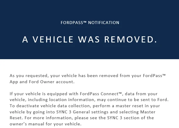

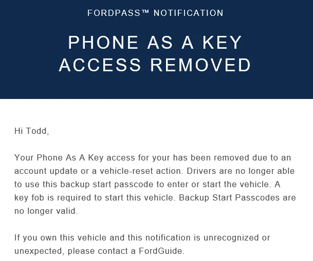

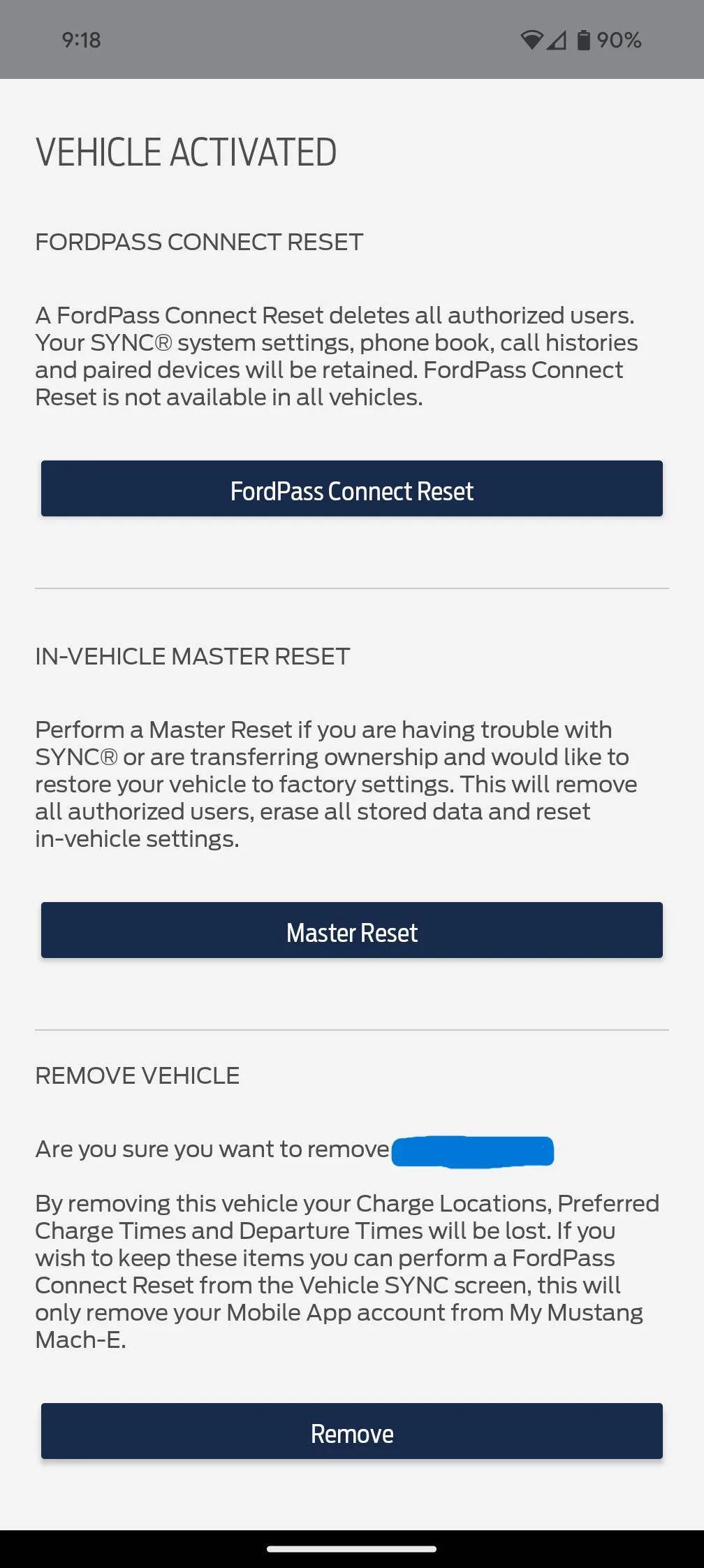

Go into your FordPass app and we first want to remove the vehicle from FordPass. If you reset the car first, you won't be able to remove the vehicle from the "garage". Go to your profile click on reset, scroll to the bottom and click on Remove Vehicle. You should get 2 email confirmations that PaaK was removed and that the vehicle has been removed from FordPass:
Ford Mustang Mach-E Factory Reset How-To: Procedure and Steps Screenshot_20231109-091832
Ford Mustang Mach-E Factory Reset How-To: Procedure and Steps 1699550465400
Ford Mustang Mach-E Factory Reset How-To: Procedure and Steps 1699550488857

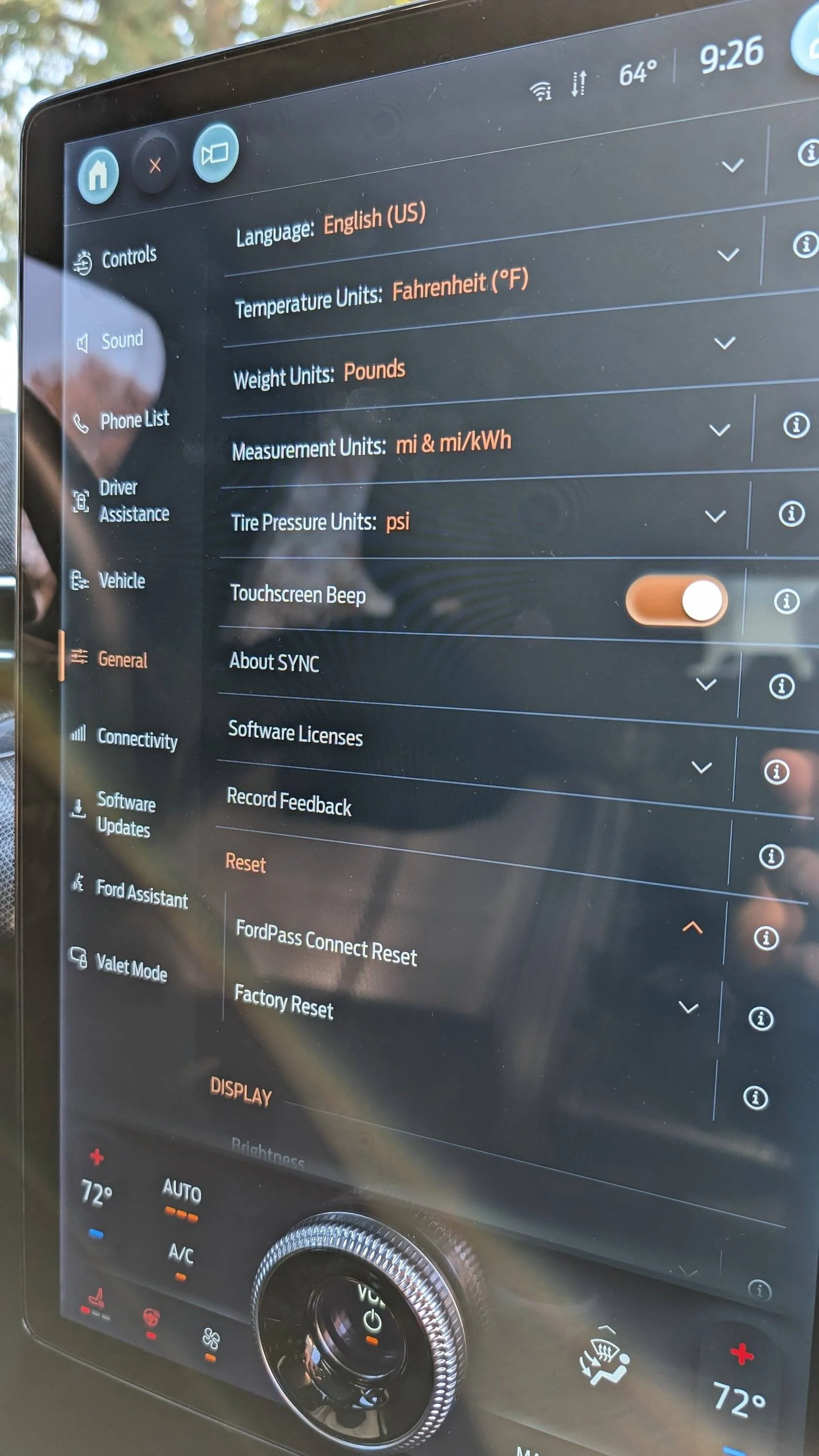

Now it's time to reset the vehicle. Go to your vehicle and click on the toggle icon (which Ford strangely uses for settings), then go to General and Reset. Factory reset can be found in the drop down.
Ford Mustang Mach-E Factory Reset How-To: Procedure and Steps PXL_20231109_172656190

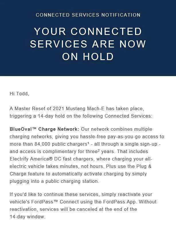

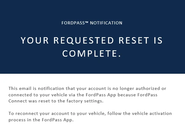

You should now receive a couple more emails:
Ford Mustang Mach-E Factory Reset How-To: Procedure and Steps 1699551065595
Ford Mustang Mach-E Factory Reset How-To: Procedure and Steps 1699551106138

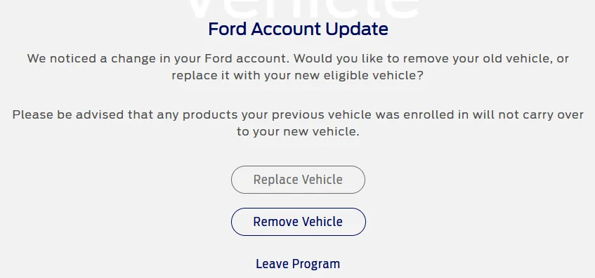

If you are in EAP you have the option to swap vehicles, remove vehicles or leave the program. You can login to the EAP program at https://www.earlyaccess.ford.com/ and it should prompt you to take one of those actions:
Ford Mustang Mach-E Factory Reset How-To: Procedure and Steps 1699552077330

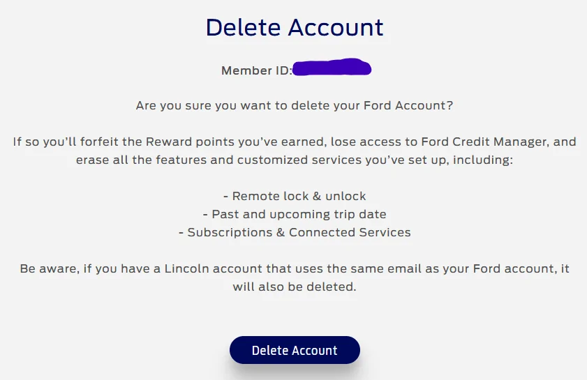

Deleting Your Ford Account:
Once all of the above items are done you can completely delete your Ford Account by going to:
{name} Account -> Account Settings -> Delete My Account
This will then ask you to confirm the deletion:
Ford Mustang Mach-E Factory Reset How-To: Procedure and Steps 1699551621102
