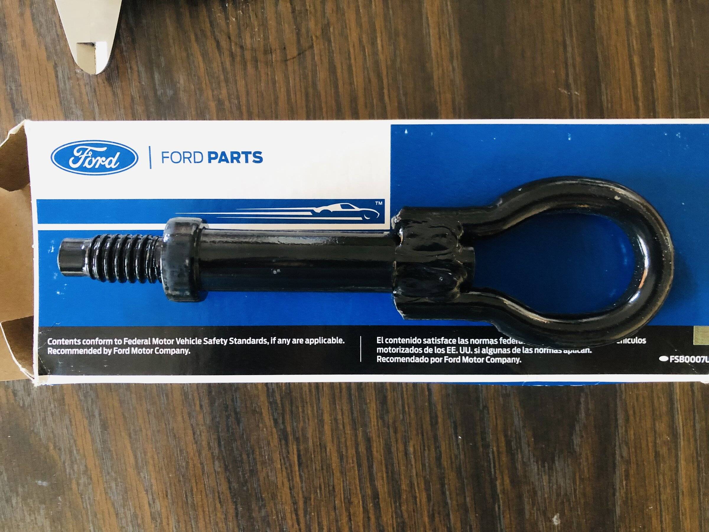

I found and bought a Ford tow hook. Being that I already knew that the hole in the MME front bumper is not threaded, I figured that I would have to find a mating female fastener. Well, today was the first time I actually removed the cover over the frunk jump leads from my GT-PE’s front bumper cover. Imagine my surprise to find out that the hole in the front bumper does not line up with the hole in the bumper cover! At least for the US-spec GT, we will need to make a different hole in the front bumper and find a special thread female fastener (M16x3.0 Left Hand). I’m not going to bust my butt to find that fastener since the hole doesn’t line up with the port in the bumper cover.
