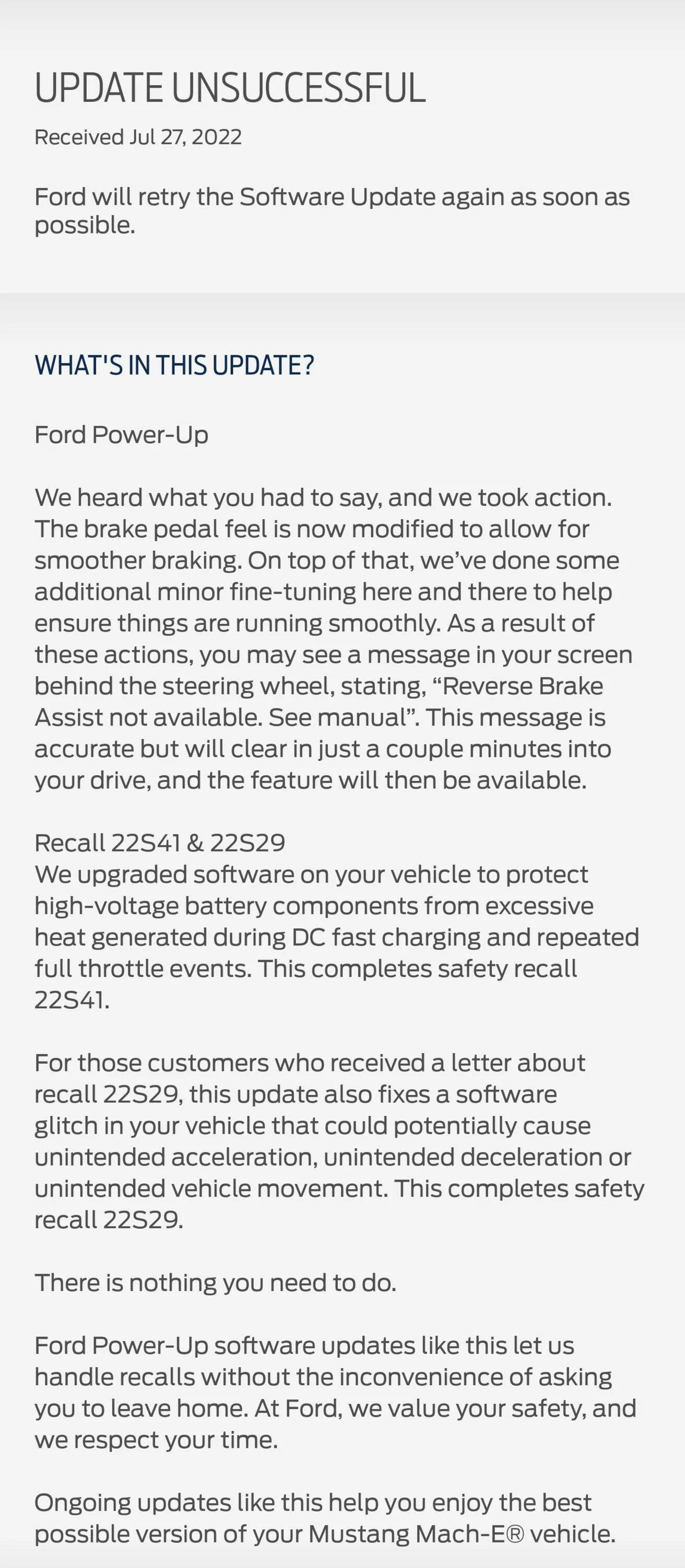

The new OTA recall updates have failed to install twice now for me. Both times they have tried to install at a time different that what I have scheduled and when you go into the setting to manually check for updates, it says there are none. Has anyone else had issues with them installing?

Have you tried just auto and no set schedule?
Have you driven your car lately? These ones will fail if the 12v is low
I used to have it on auto but set a schedule after Ford recommended it to "Not miss any updates". I'll try going back to no schedule/auto.
I drive it daily. Car scanner shows a healthy 12V battery so I think I'm good on that front.
