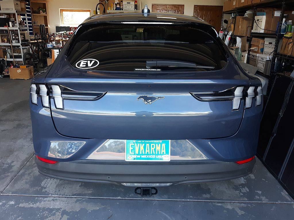

@mikeho I installed this hitch last weekend. It was an easy install and looks great. One of the reasons I went with the Eco-Hitch is that once installed there is no hole left on the underside. Yes, it is somewhat visible from the rear. But, since the hitch is black and the rear valance is black, it does blend in pretty well. There is also no affect on ground clearance since the hitch is higher than the lowest point.
Ford Mustang Mach-E First Hitch Installed on a Mach-E (Torklift EcoHitch) Hitch - underneath
With the stealth hitch, you are left with a large hole in the underside unless you fabricate a panel to use when you don't have the receiver in place.
The hitch is rated for a tongue weight of 530 lbs. That is more than sufficient for a 4-bike rack or a box. I'm using mine to hold a 2-bike platform rack. While they rate it with a towing capacity, there's no wiring for lights and Ford doesn't want those of us in the US towing.
nice job!
love your plate by the way. ;)
