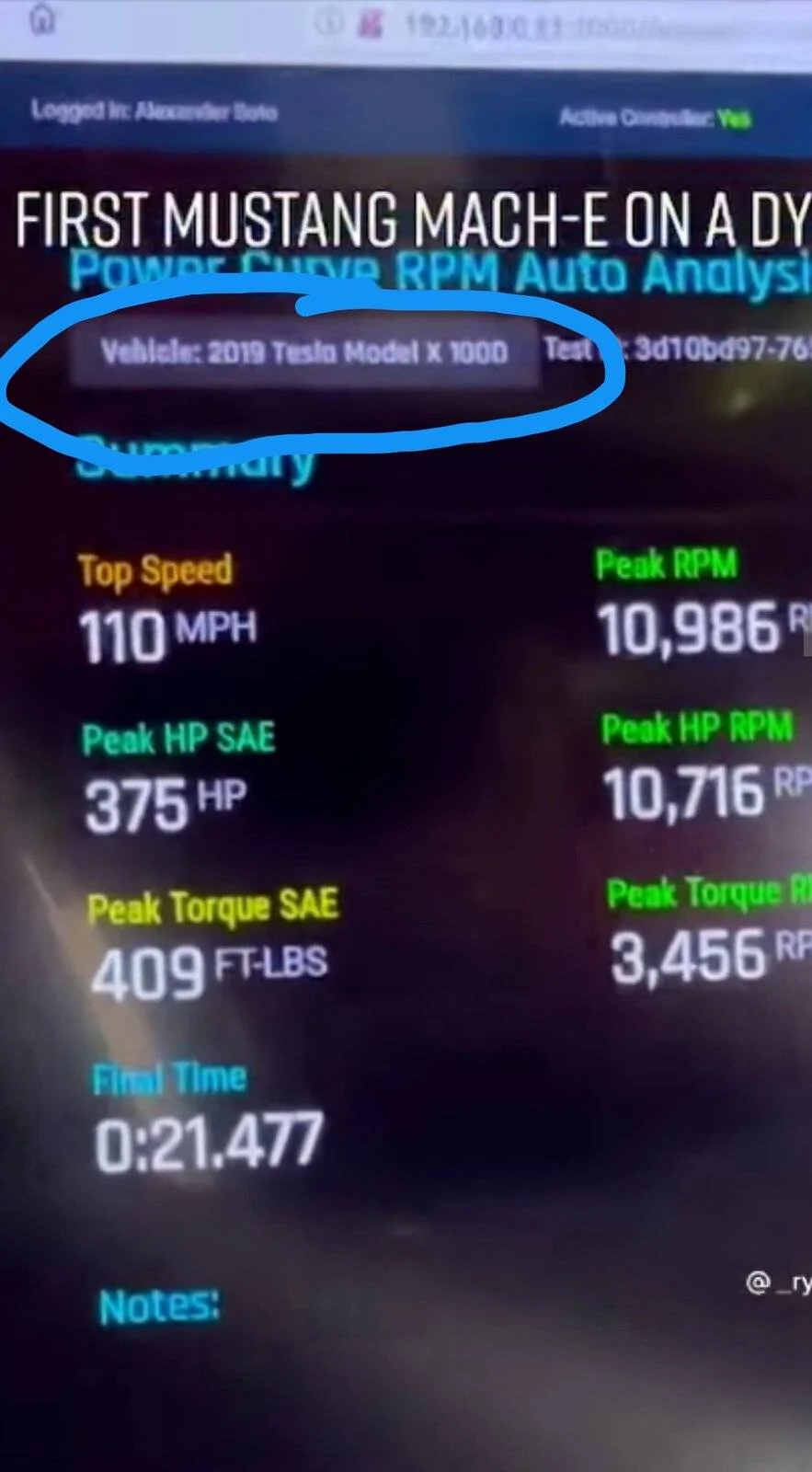

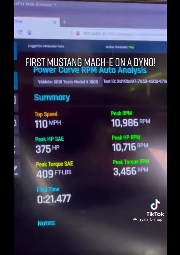

Awesome. Which model is this? AWD ER? (Edit - looks like AWD Ex)
If so...
Rated HP: 346 (this car: 375!)
Rated torque: 428 ft-lbs (this car: 409)
This thing measured a HP that was way higher (probably because the RPMs aren't correct?) And a torque loss of about 5.5%, which is about what you'd expect on an EV!

Where do they measure the torque and rpm? These numbers are definitely not wheel speed which would be used in the wheel hp calc. If it is motor output, there are two, how do you get the values from those? Needs some explanation.

Why does the Dyno have Tesla in the vehicle description?
horsevxi
Nov 21, 2019
FJ Cruiser, 2001 Mustang Cobra, 1986 Mustang SVO, Mach E Reserved
I would guess that the Mach E is too new to be an option in whatever dyno software they are using and they just chose the next closest option. The Model X has over 500 HP and more torque, so I would expect it to perform better than these numbers if they were showing previous Model X results and trying to pass them off as a Mach E. Since the video actually shows that Mach E on the dyno and the results seem reasonable, I would guess they actually tested the Mach E.
The main concern is that they are showing SAE corrected horsepower. SAE correction will adjust horsepower measurements for an ICE so that it aligns with a consistent temperature and ambient pressure at all testing locations. Since these conditions don't matter for an EV, it unnecessarily adjusted horsepower up, which is probably why it is shown to produce significantly more than the advertised 346 HP. The 375 HP is likely not what the dyno measured. I would expect torque to be lower because it is measured at the wheels and some amount will be lost to wheel and tire inertia, so I would not expect to see 428 ft-lbs for this kind of test.
^^ This.
With correction factors you can make a dyno say whatever you want.
I don’t know what the drivetrain loss of an EV is, but I guarantee it’s way less than an ICE.
Dynos make for good tuning tools for ICE vehicles. But the same car, same day, same dyno will have different peak hp and tq results.
Basically...... we need more data.

If they were smart, they could have set the test conditions to the SAE standard conditions so the correction factor would be 1.0. But who knows what they did?
