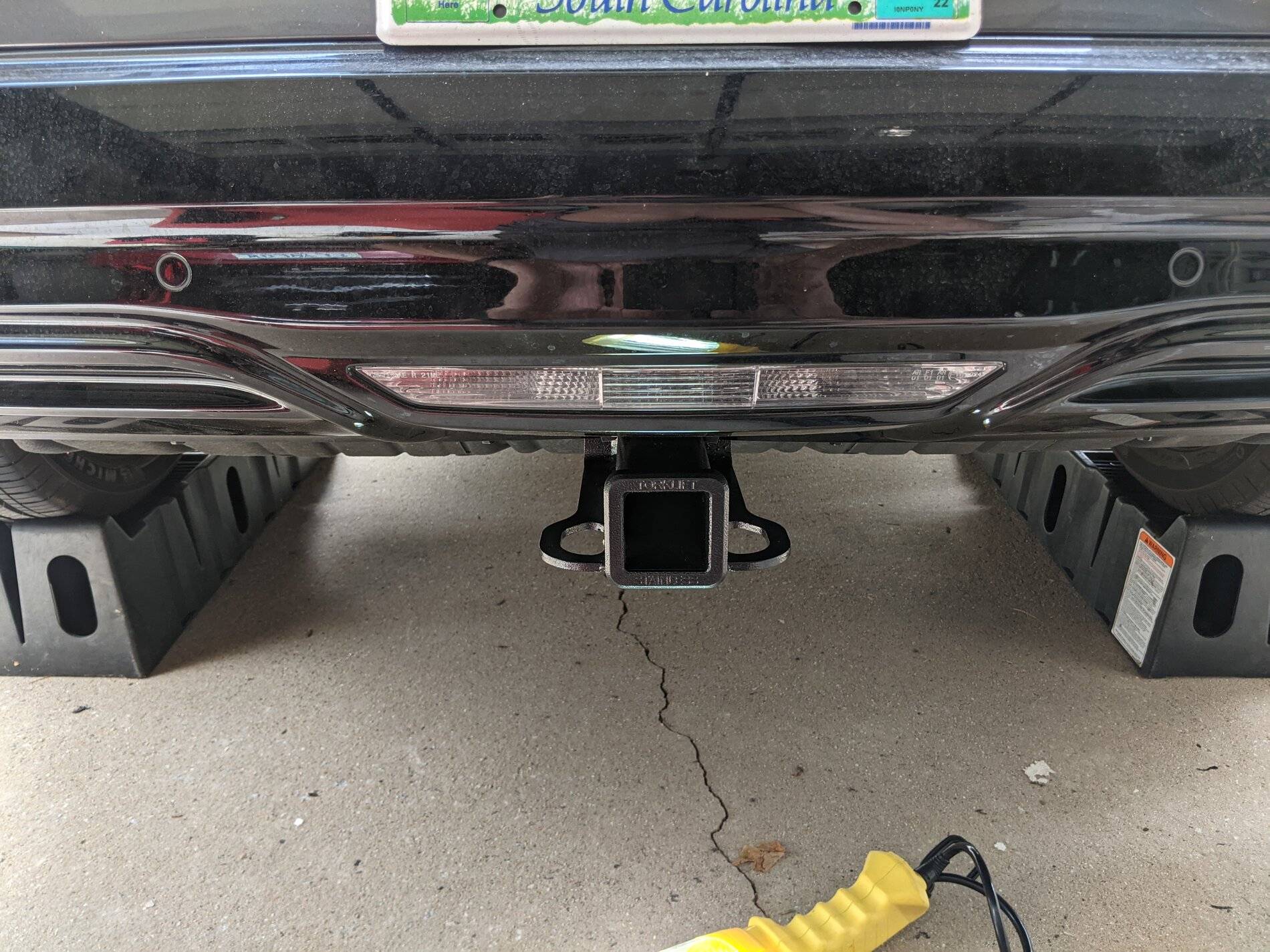

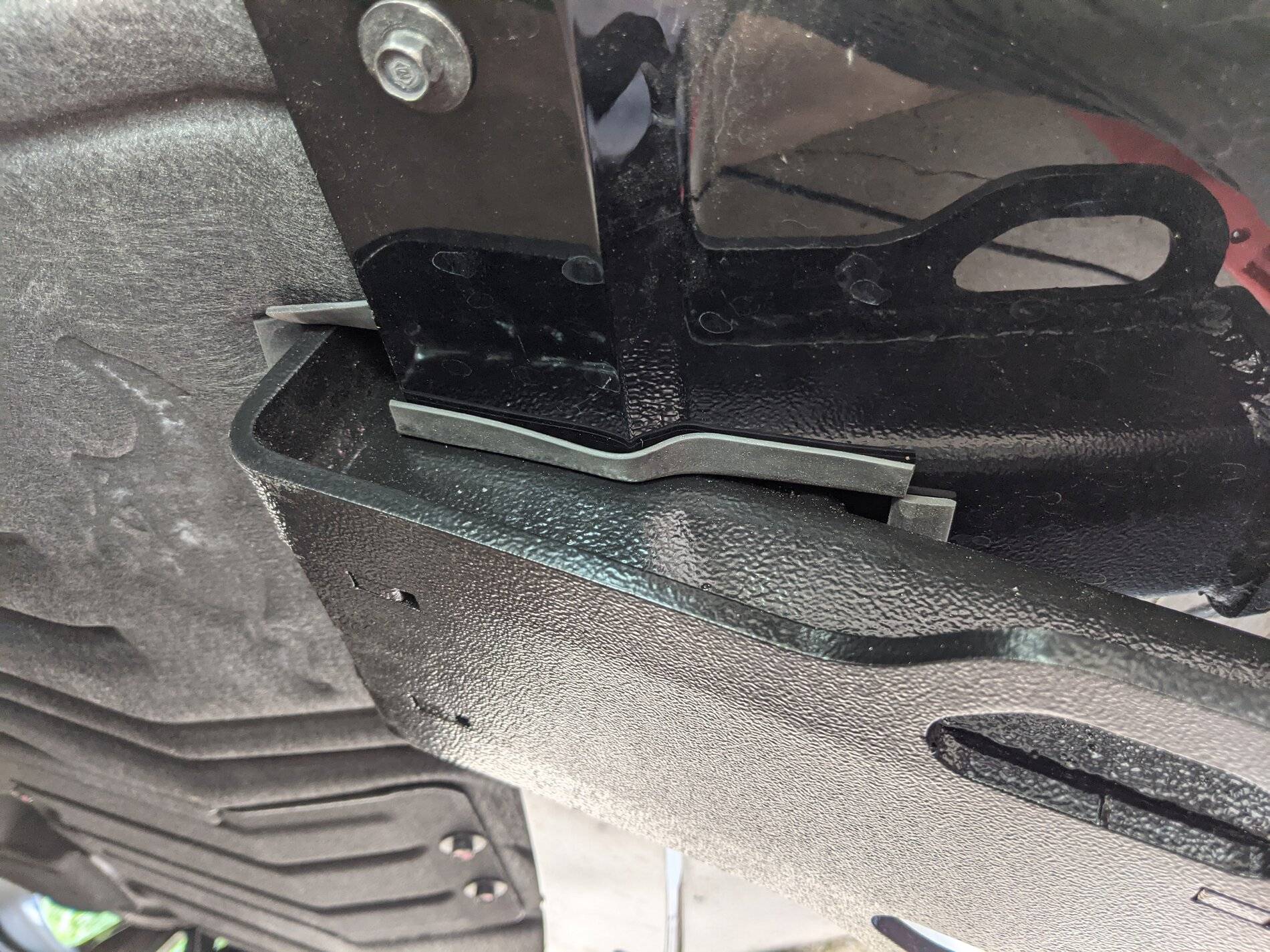

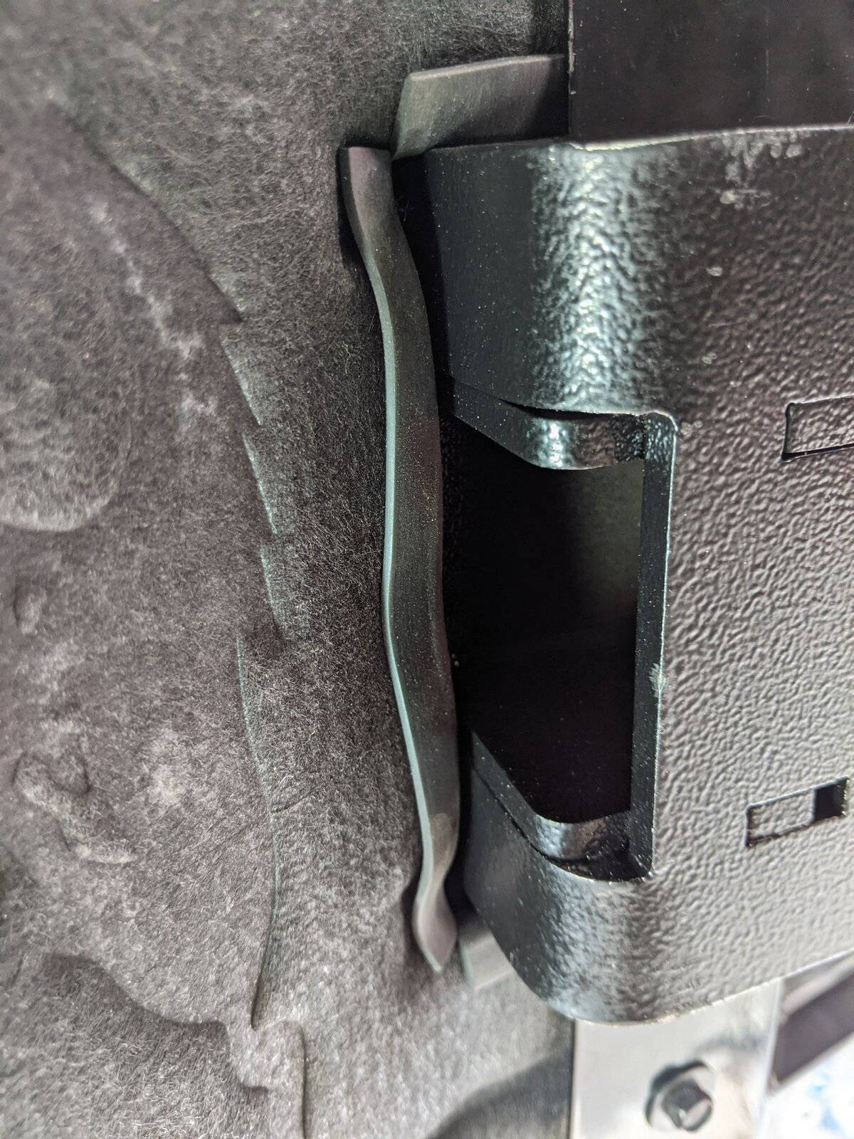

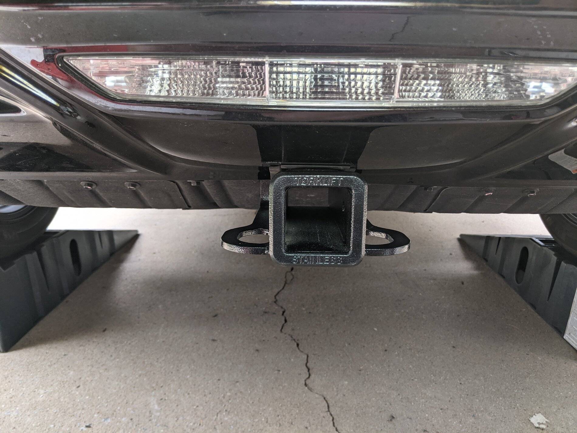

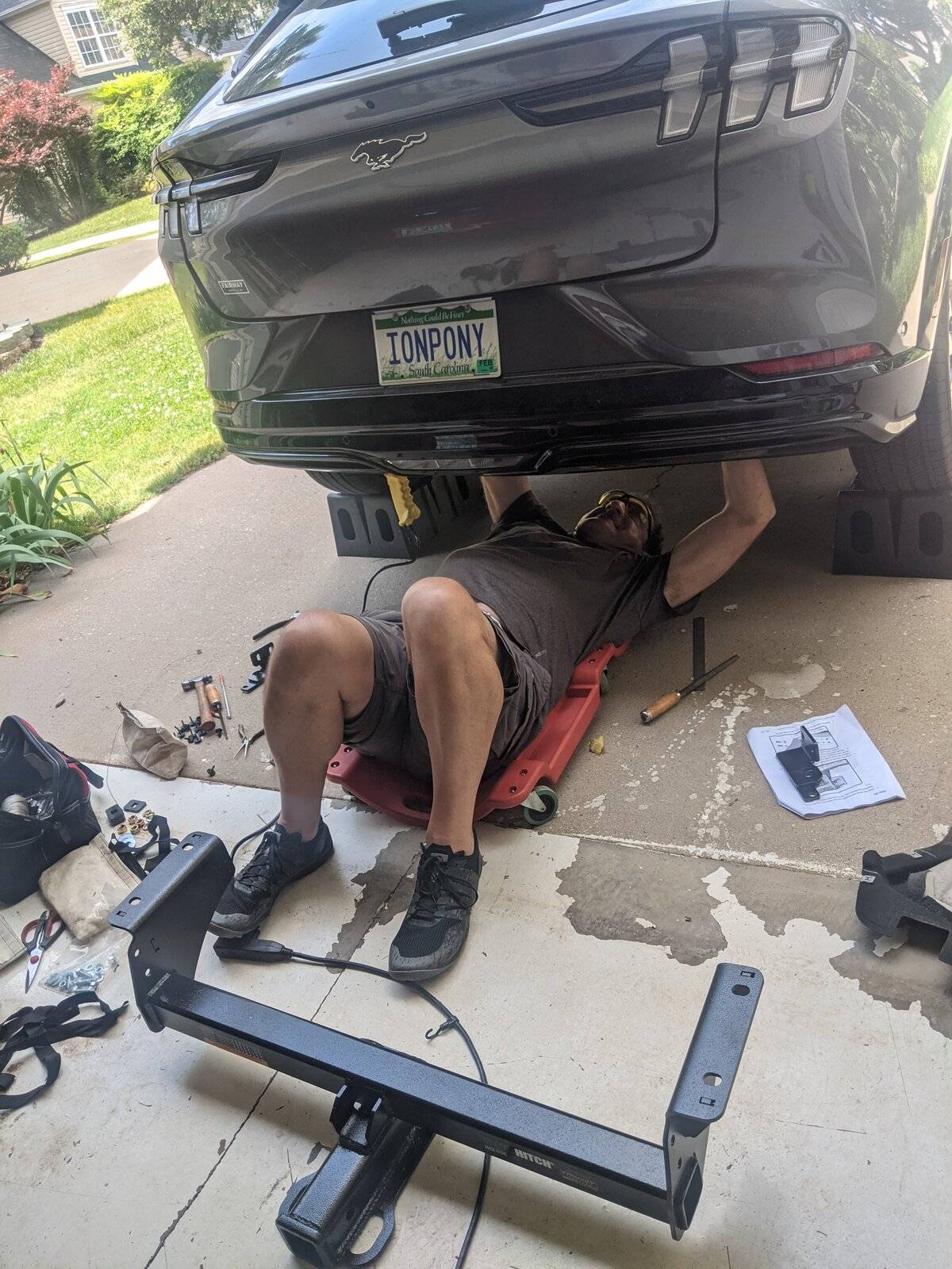

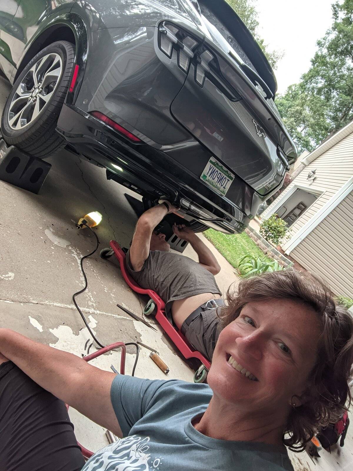

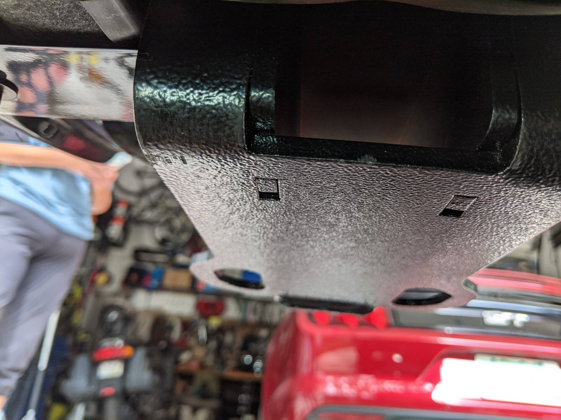

Today was the perfect day to install the EcoHitch from TorkLift. Committed to get under the Mach E, take down the diaper panel and starting the installation process.
Couple members have gone thru this process also. Instead of making the cuts according to the instructions, I shortened the cut outs. 7 inch down to 5 inch. The width instead of 3 inches down to 2 & 3/4. Cut the diaper to the instructions.
Find a person or your partner and make sure they are patient and understanding. All of you going to juggle this piece of metal on your chests and lift into position.
Your vocabulary is going to get interesting.
Do not pick a fight with your wife, friend or girlfriend. It will be frustrating at times.
Fishing the main bolts is challenging. I had no trimming to do in order to fit thru the holes. Keep in mind the holes are not the same. I had to file one of them.
No wonder if the installation seems to be a bit askew by a 1/4 of an inch, it is fine. No one has gotten it in the exact center. None of the holes are precision cut and allow for some side play. I remember someone mention that the cut outs were large and mud, dust and sand will intrude the underside.
I doesn't matter. Dust, dirt and water will enter the underside. I used edge seal to keep the cut out edges tight to the hitch.
Keep all bolts and nuts loose until the end.
You may think this was not made for the Mach E......but it is. Try to find a torque wrench if you can. Torques are critical.
Whoever helps you try to do something nice for them. In my case my wife was a great help. We giggle, laughed and got to call this piece of metal all kinds of cosmetic epithets.
We dropped tools on our heads, chests and ate some dust along the entire process.
At the end we were victorious.
Made some pics for posterity.

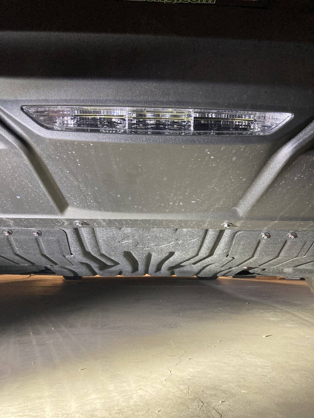

Great job Nikos and thanks for the pictures. The Select doesn’t have that fancy black plastic which means that I will need to take the whole bumper piece off I think... (posted in the DIY thread too).
Ford Mustang Mach-E First Mach-E hitch available - Torklift EcoHitch! 47D9942E-8739-4BA3-9FE3-B813BDF5F8D2
Nikos
458
425
Taylors SC
17 Must GT, 21MME AWD, 22 F-150 Lightning
Aircraft Mechanic
It is the same set up.
Don't have to take the whole bumper plastic cover. Take out all the screws and 4 plastic retainer clips and the diaper comes off. Then look up and you going to see your motor in all its glory. When you make your cuts you will have to cut both the plastic bumper cover and the diaper. Follow the instructions. I just modified the cut outs. Instead of cutting out 7 inches by 3 inches, I cut out 5 inches by 2 3/4.
The diaper dimensions remained the same. If you order the hitch you going to need someone to help you.
Find a patient friend and buy some beer for afterwards. Give yourself at least 4 to 5 hours. By the way a large heavy duty pair of scissors will do just fine. Mark your lines and cut.
Drink the beer after you finish this project. Good luck.!!!!

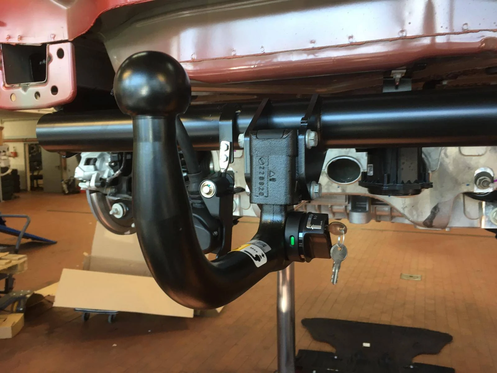

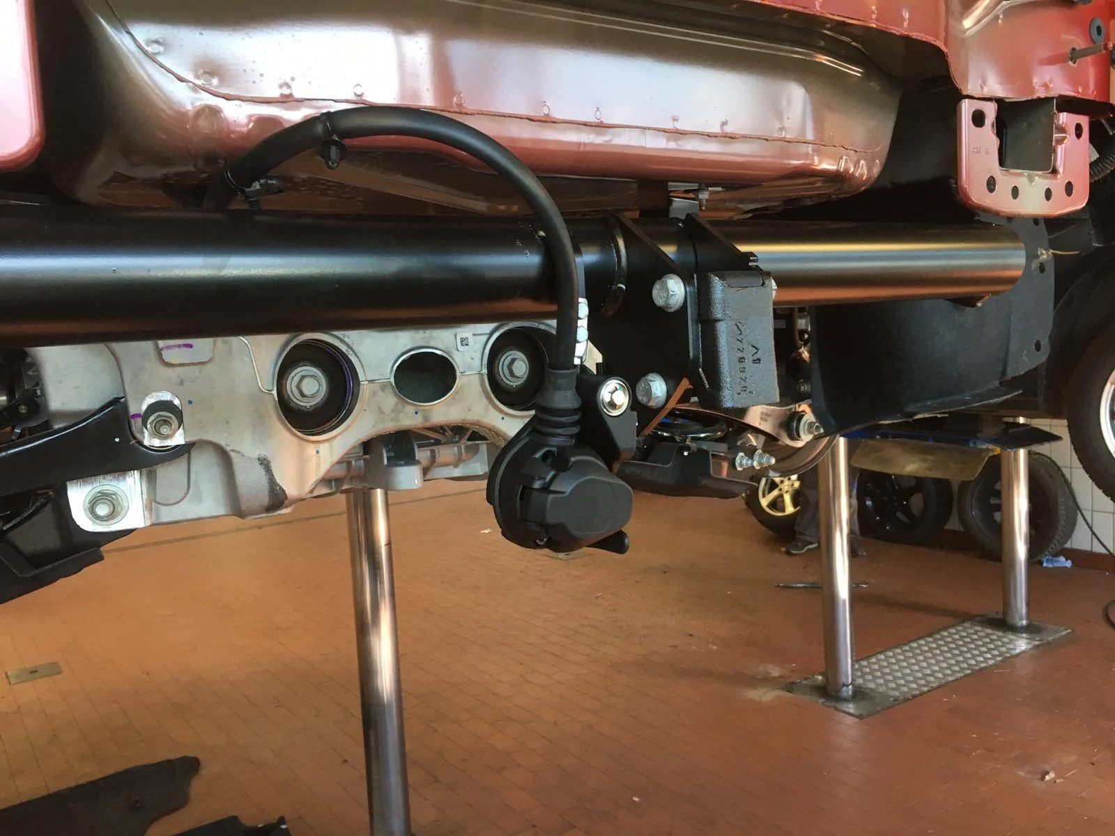

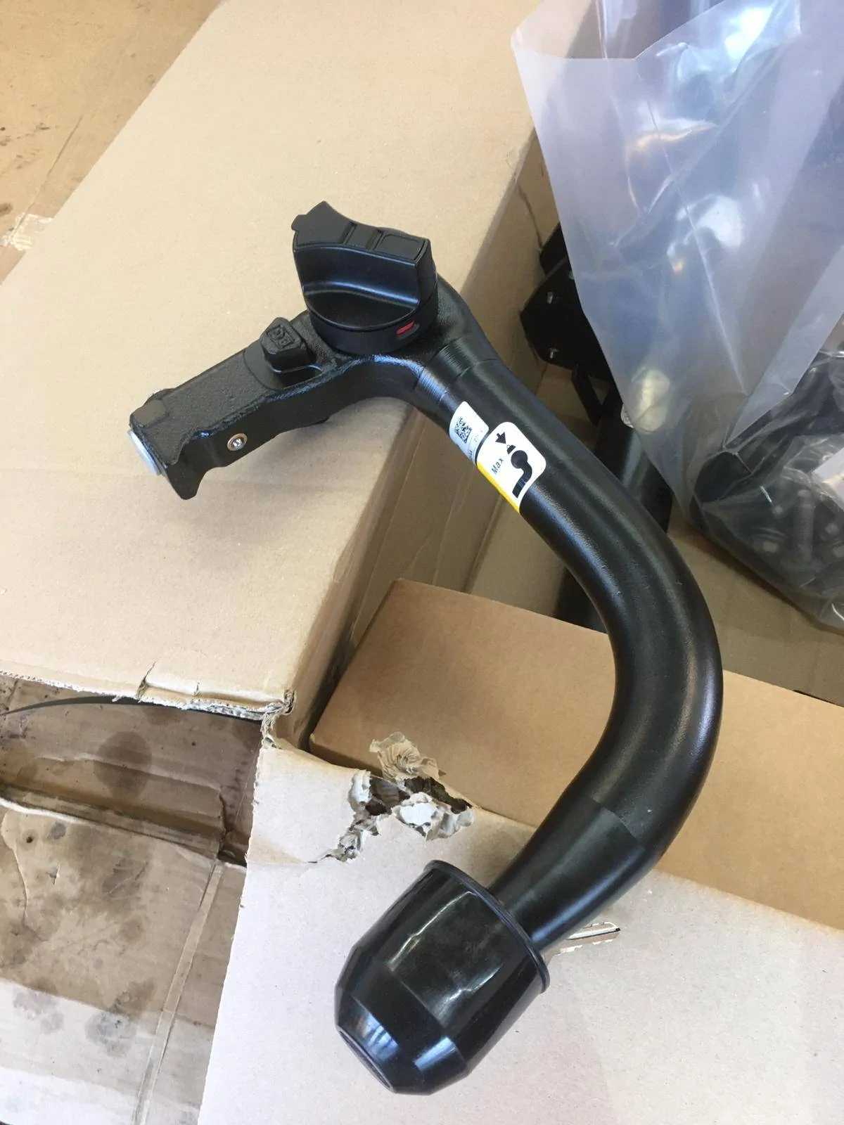

Well, and here are the differences between the US-and the European solution. Here in Germany the hitch solution is removable and unvisible.
Ford Mustang Mach-E First Mach-E hitch available - Torklift EcoHitch! IMG-20210531-WA0009
The rear bumper has to be removed for this installation. Also I noticed the 7 pin connector. Where that harness connects to/with in the vehicle? The installation reminds me of the stealth hitch arrangement. I would like to see the cutout area. Pics when is finally installed, please.
Thanks for the post. I had been wondering about these parts, and I recently created a thread asking about them:
Installing the OEM hitch receiver?
I wonder if it would be too much trouble to post the installation instructions? I am trying to get an idea of how difficult this is, and whether it is worth the trouble to go about obtaining it and installing it.
The only other invisible Mach-E hitch installation I've seen is this one:
See My New Trailer Hitch? Installed Stealth Hitches
But that is a prototype, and the product is not yet commercially available. I've spoken with a company representative, and they have no ETA other than "after the summer".
