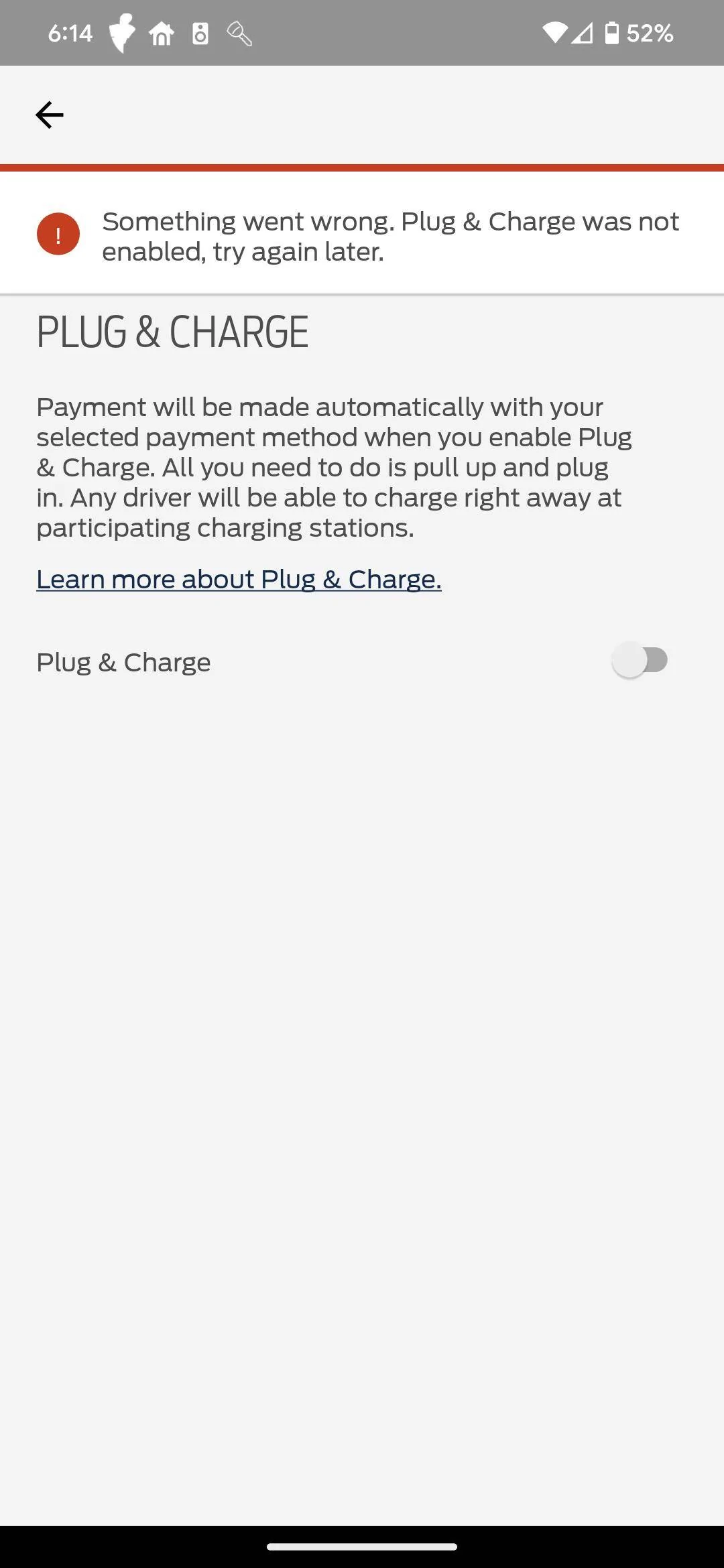

Yes that is where you enable it. Good luck. Ford pass is inconsistent and it may take the backend a day or so recognize you have the payment method entered.
Yeah, that one errors out on me.
So now I have enabled BlueOval with payment setup, but Plug and Charge is not on. How can I use Blue Oval I'm that case?
Go to the map in the app. Select charging . Find the charger you are at and activate it on the app. You’ll see the station respond and then you plug in.
