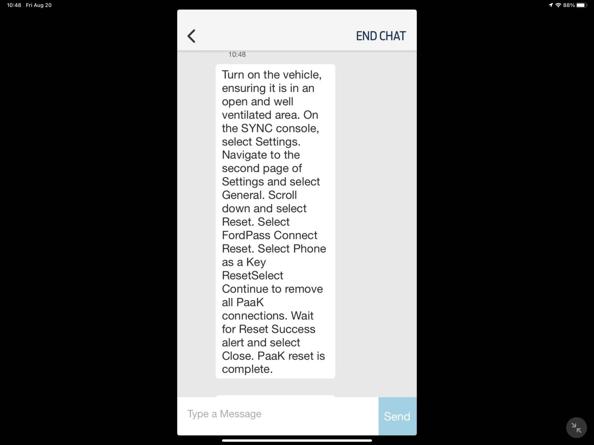

I have mentioned in an earlier post that when I had my phone set as PAAK and the FOB both with me, the seat and mirror setting defaults to #1 setting . (My profile setting was 1)
had a chat with the help folks at Ford and they had me do a rest. Photo attached. Everything works great now.
