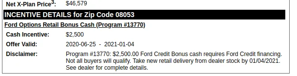

Where I am in Socal, and look at X Plan pricing, the Ford incentive currently shows $2500 if you use Ford credit for financing (purchase) or Options. Obviously, don't know what Ford incentive will be when I actually get the vehicle next Jan / Feb. CA state credit is still $2000.
You need to click on the link for the car type, and in the dialog box that pops up you'll see that the $2500 applies only to the options plan. Note the title "Ford options retail bonus cash program":
Tim,
That's not what mine says when I click through. But doesn't matter right now since I won't be taking delivery by 1/4/21 . . . . have to see what it changes to when I do . . . . .

Tim,
Interesting. So it might be a regional thing being limited to options? If you go to ford.com, configure a mach E, and hit the financing calculator with both options and regular financing does it show you a $2500 incentive for both?
Where (link) can I go to check these rates and incentives for Options?
(Repetitive) Could you please direct me to the link(s) where you see this? Thanks
I saw this in the X Plan page that I reached through MCoA benefit section. Linked to a Ford page that you entered your Zip and saw both X Plan pricing and available incentives (at the time). I'm sure the incentives change and would need to be in force when you take delivery.
Thank you, this worked for me too
