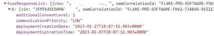

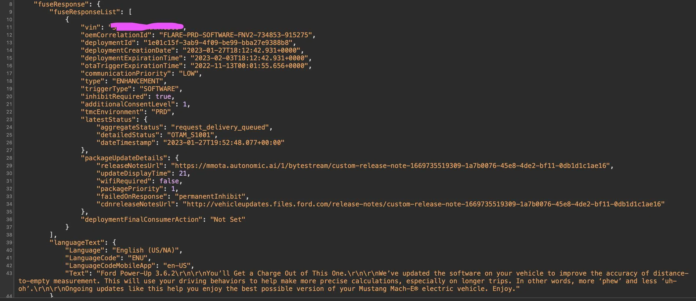

Can anyone help me understand why I’ve had 3.6.2 queued up but it won’t install?
I checked LVB SOC with Carscanner and it has been over 80% each time I’ve set the update to go. Parking brake set, headlamps “off” and still it won’t “go.”
I called the OTA folks and they said my vehicle is showing “update install active” whatever the heck that means.
I took a picture through the driver window as it was counting down to install the update … but then got a message later on FordPass that it failed.
this is so frustrating :-(
