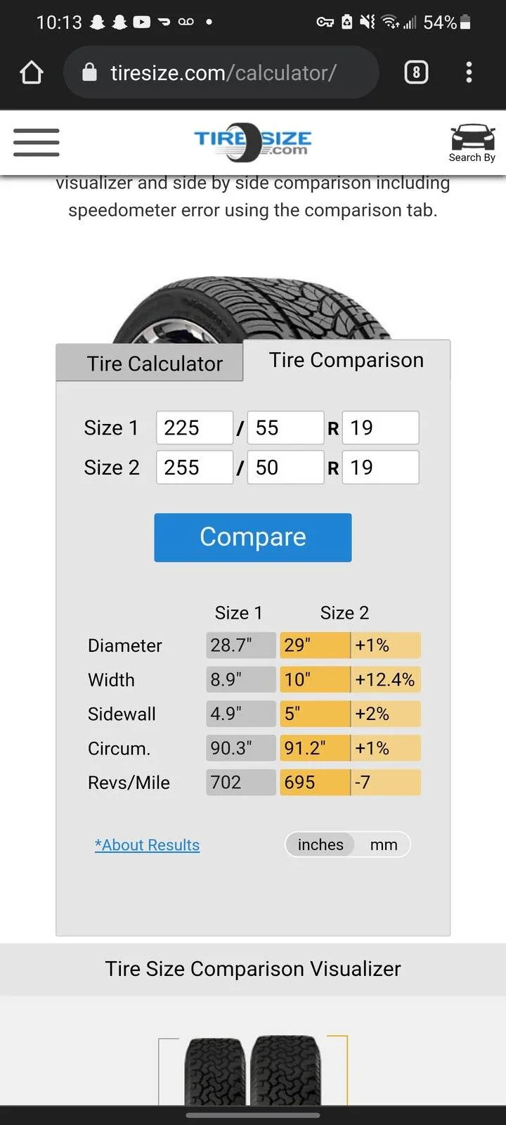

Hello,
I've got my car at a Ford dealership because the brakes got warped. Because they're under warranty for the first 12 months/18k miles they're taking care of it. While it's there I asked if they could get 255/50 r19's Michelin Primacy Touring A/S to upgrade the back tires. (OEM 225/55/R19, upgrade would have a difference of
The service guy reached back out and told me his certified MME tech won't upgrade the tires because the system won't allow it. He said I can't change anything other than to same size different brand because "the system is too complicated and could give errors and lock up which would prevent you from driving."
Has anyone heard of this? (Math attached if anyone would like to double check me)

Thanks for the reply. Yeah what had me pausing was that they're not willing to change anything other than same size different brand.
Your tech is right...you shouldn't put different sized tires front to rear unless the rolling diameter is exactly the same. Any difference can cause traction control problems. Hard to say what the threshold is but from their perspective, it's a liability issue.
Also, don't put 255 tires on a 7" wheel.
the 255s are rated for 7-9 inch wheels. The diameter is 0.3" bigger and the circumference is 0.9" bigger with a +7 difference in revs/mile.
Do you think this might be an issue?
I do think it could be an issue...depending on how sensitive the traction control is....especially as you get going faster on the highway.
255 may be rated for a 7" wheel but you'll be extending the tread over the width of the wheel which will A) look worse and B) handle worse.
The short answer is yes it will.
I had an even closer match (+4 per mile) on a former car of mine and I had to throw the spare on it. The car quickly screamed that something was wrong. It disabled traction control, ABS, lane centering, cruise control very quickly and threw a lot of errors until it was fixed.
On the mach E I can see it screaming even more and this goes double if it is AWD
