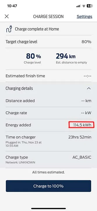

Possible bug in 4.31.2?
Ford Mustang Mach-E FordPass 4.31 now available IMG_4341
Looked at my charger a few times and steady not flashing (drawing) so I think it is the FP display? Getting cold here now and needs to be plugged in. Charged 60 to 80 last night finished 12 am or so. Auto preparing to drive 6:00 am. 60 to 80 is 18 KW so there is an extra 100 KW in there somewhere. Impossible and it is still at 80% and the heating and preconditioning are not running non-stop. Charger says no draw. Just keeps counting up and is at 121.2 KW now? We will see on the next hydro bill 🤣
