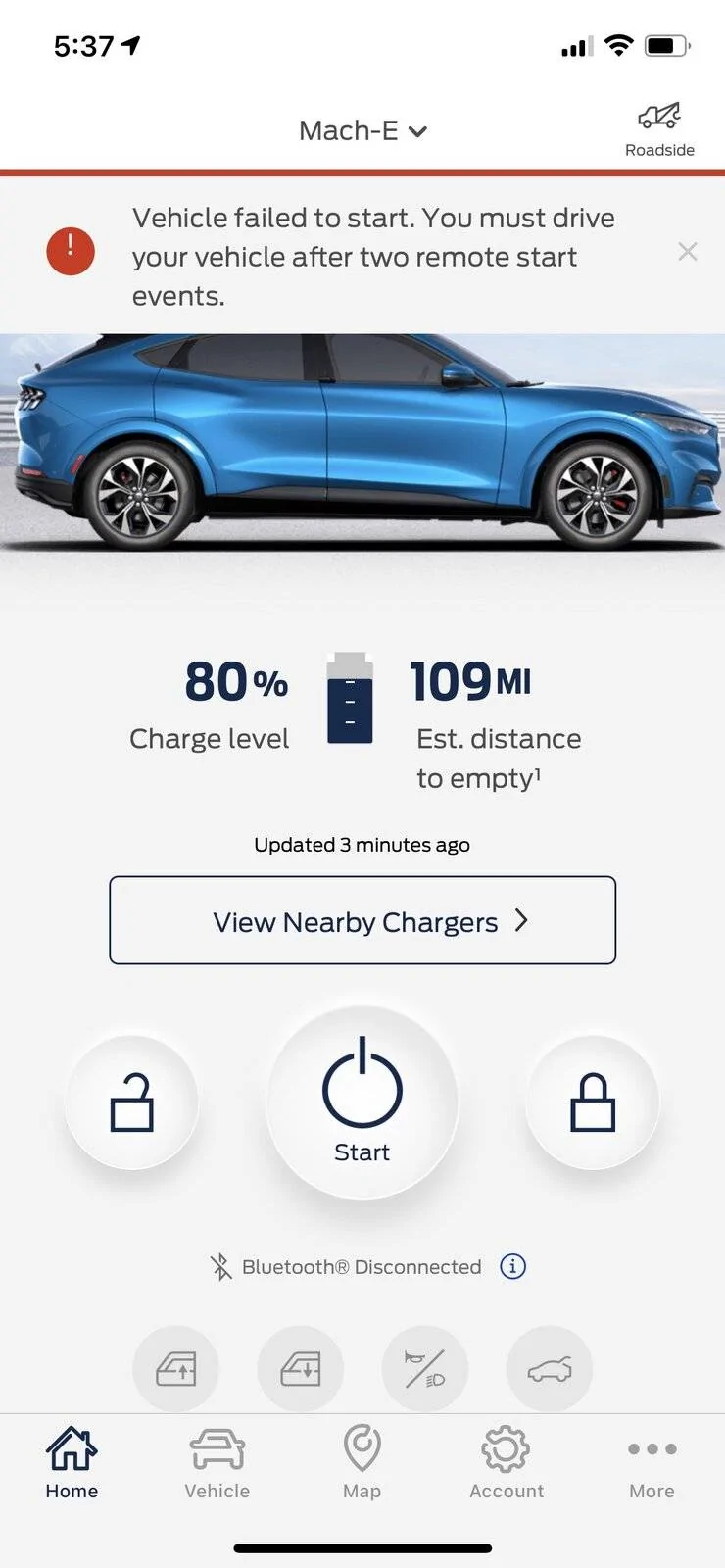

Could be a coincidence, but the two times today that I walked up to my Mach-E without my fob, it unlocked and started without delay or issue. Granted it's just been in the garage all day, but better than it had been before...

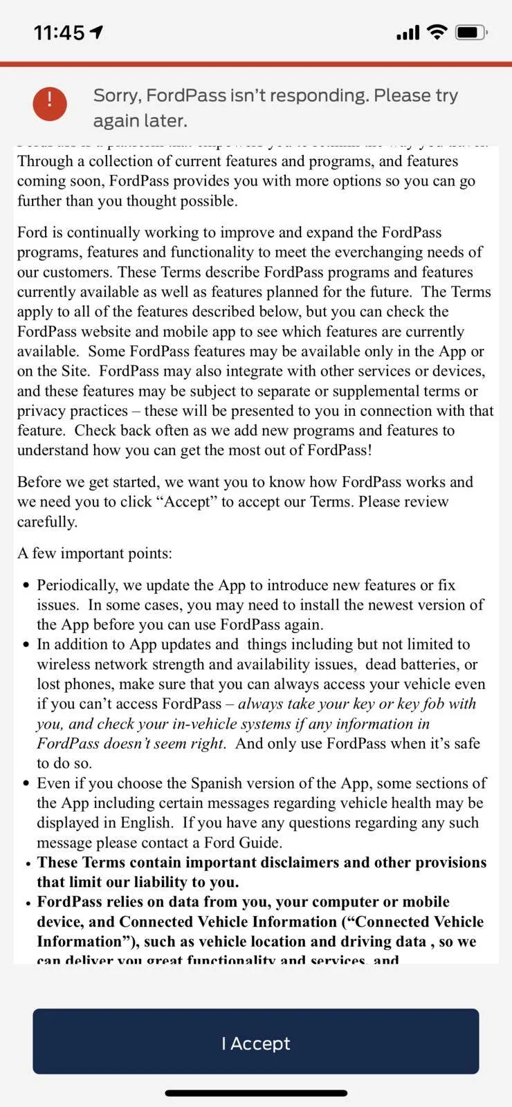

Just updated iOS app today. Stuck at the terms and conditions page as apparently I am unable to connect to the FordPass servers.
