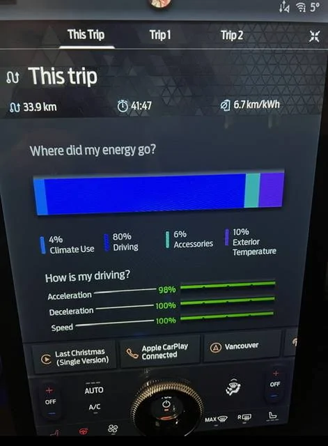

I don't park in a garage but do try and follow all of these as best I can. This morning was a bit chilly at 4-5 celcius (41 F) and managed to get shockingly good efficiency during my morning commute this morning by running only the seat and steering wheel heaters while having the HVAC system off.
Over the 33.9km of city/highway driving, I managed 6.7km/kWh efficiency! While the cabin was cooler than my wife would be comfortable with, I was very comfortable in my blazer coat. The seat heater was only set to 1 as I found setting 2 or 3 was too hot.
I did notice that the steering wheel heater seemed to turn off after a while. The setting was still on but it stopped feeling hot. I wish that this would just stay on the entire time so it would always feel warm/hot.

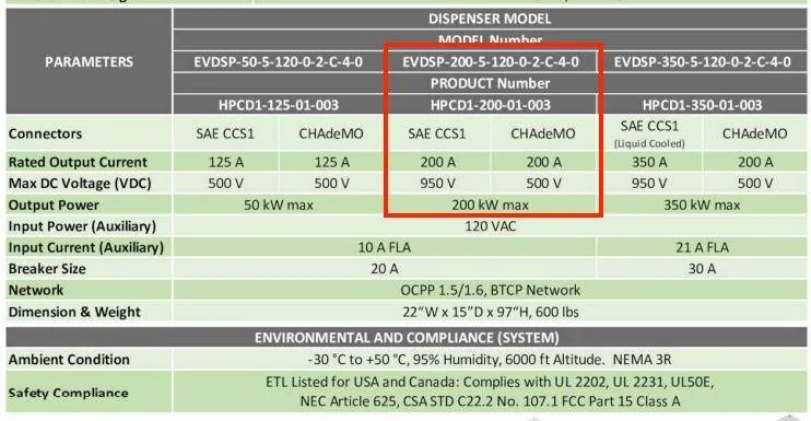

Lmao. Who turns off the heater while DCFC? Great way to get more EV adoption. The colder it gets, the slower it chargers, and the colder you get sitting in your car for 45 minutes while it chargers at 35kw on a 350kw charger!
No need to be at a 350kw charger. The Mache can barley utilize all the 150kw.
Not necessarily true. Since watts=volts X amps and the Mach-E is limited to 360 to 380 volts (depending on state of charge), the max amperage (current) the charger can put out is the determining factor for how much power (kw) you'll be able to get. The spec sheet below is for the chargers EVgo put on the expressway near me. They put in the chargers rated at 200kw, but that is only at 950 volts. When charging a car like the Mach-E or ID.4 that are nominally rated at 400V the most power you can get is 70 to 80kw. The 350kw units would output a max of 135kw or so.
You can see the constant complaints on plugshare: https://www.plugshare.com/location/423220
