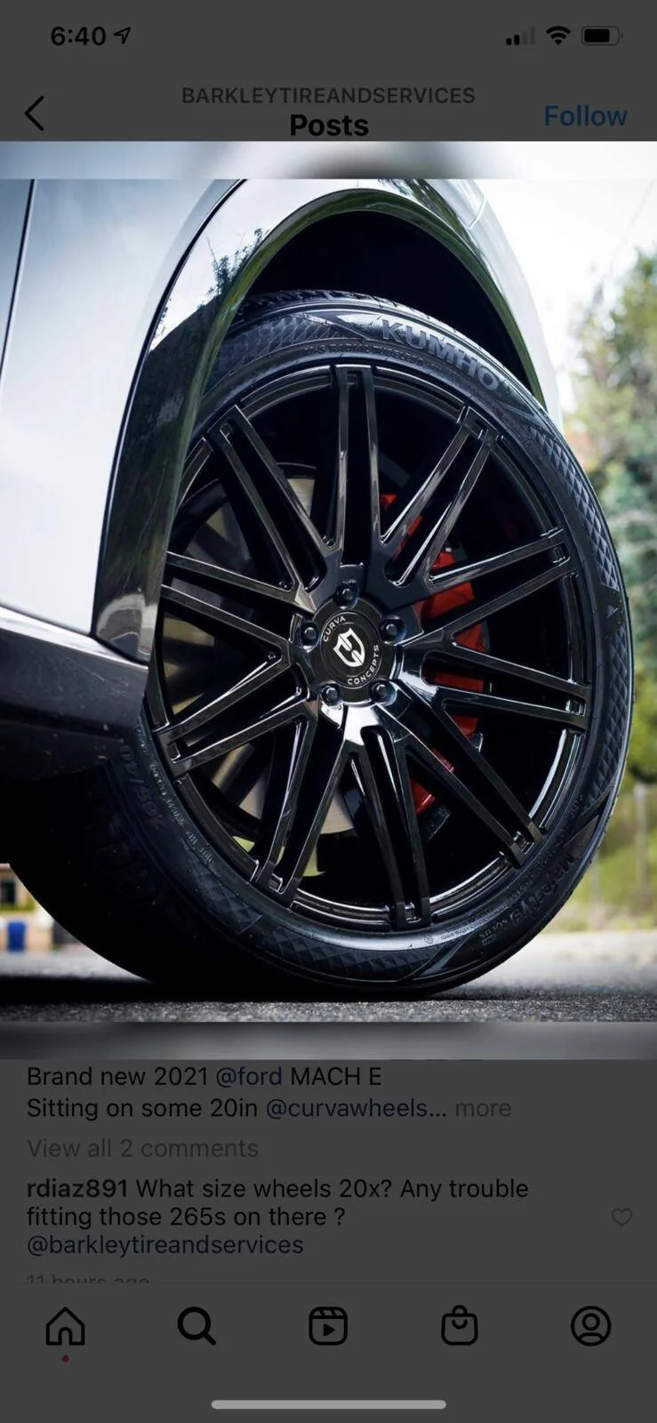

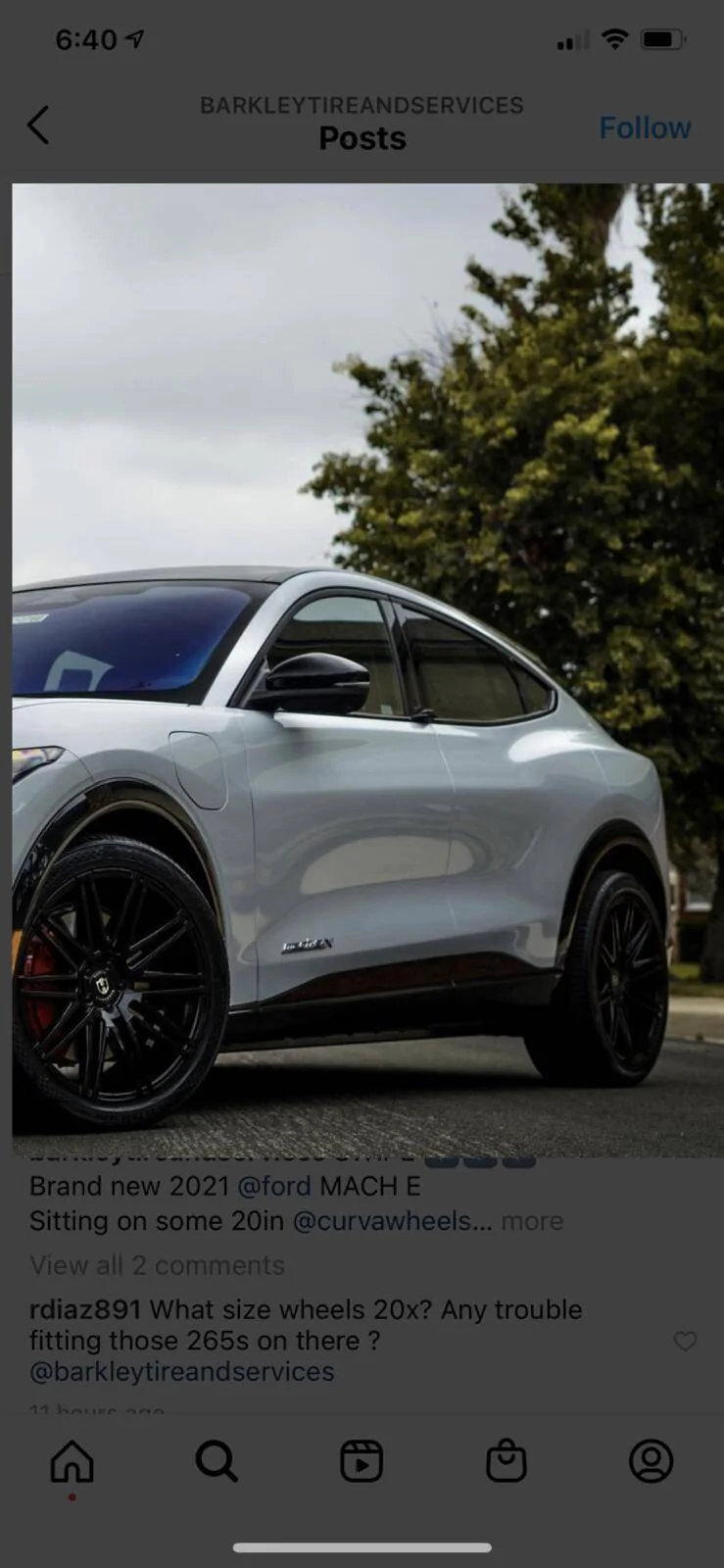

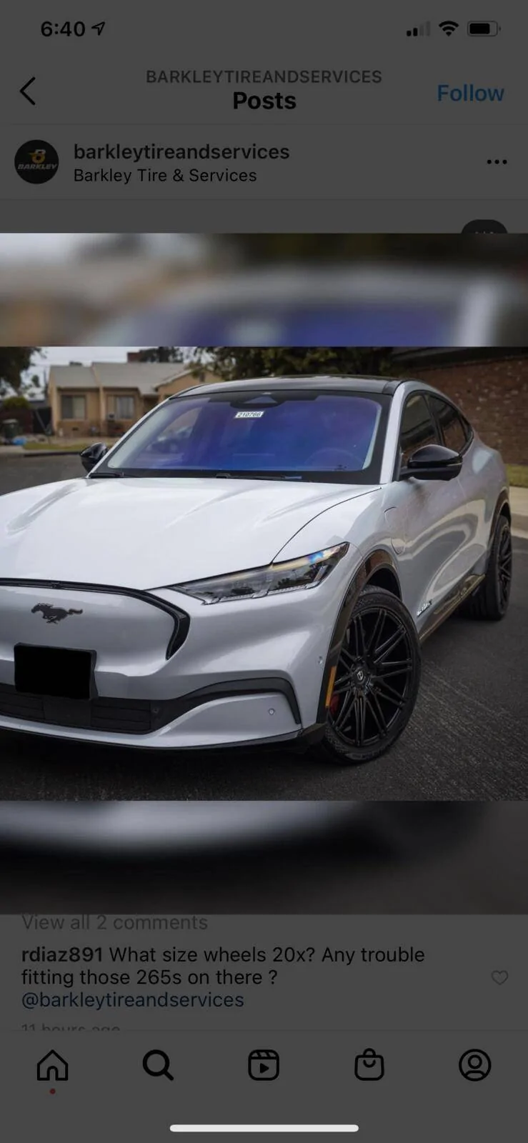

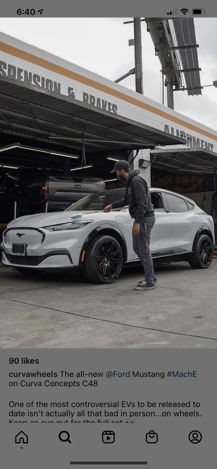

Was browsing IG for Mach E #tags and found this one. I got a reply back from Barkleytireandservices and was given the following information. "The wheels are 20x9 +35 fit with 265/40/20" Wheels are Curva Concepts C48s.
thought this would be useful as there are not many aftermarket wheel threads for the MME and some are interested like myself.
