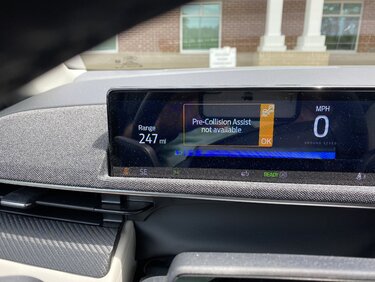

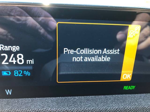

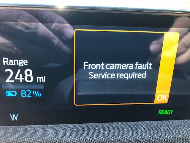

I have been getting these errors a lot recently. Driving on the highway and they pop up then go away within 3 minutes. Should I have this checked out? I figured the dealer would want the car to be displaying the error message when I take it in, but it fixes itself after 3 to 5 mins of driving.

The fix is to get the coaxial cable replaced by the dealer. Theres is a TSB out for it now.
Ford TSB 23-2137
23-2137 Ford Technical Service Bulletin (tsbsearch.com)
