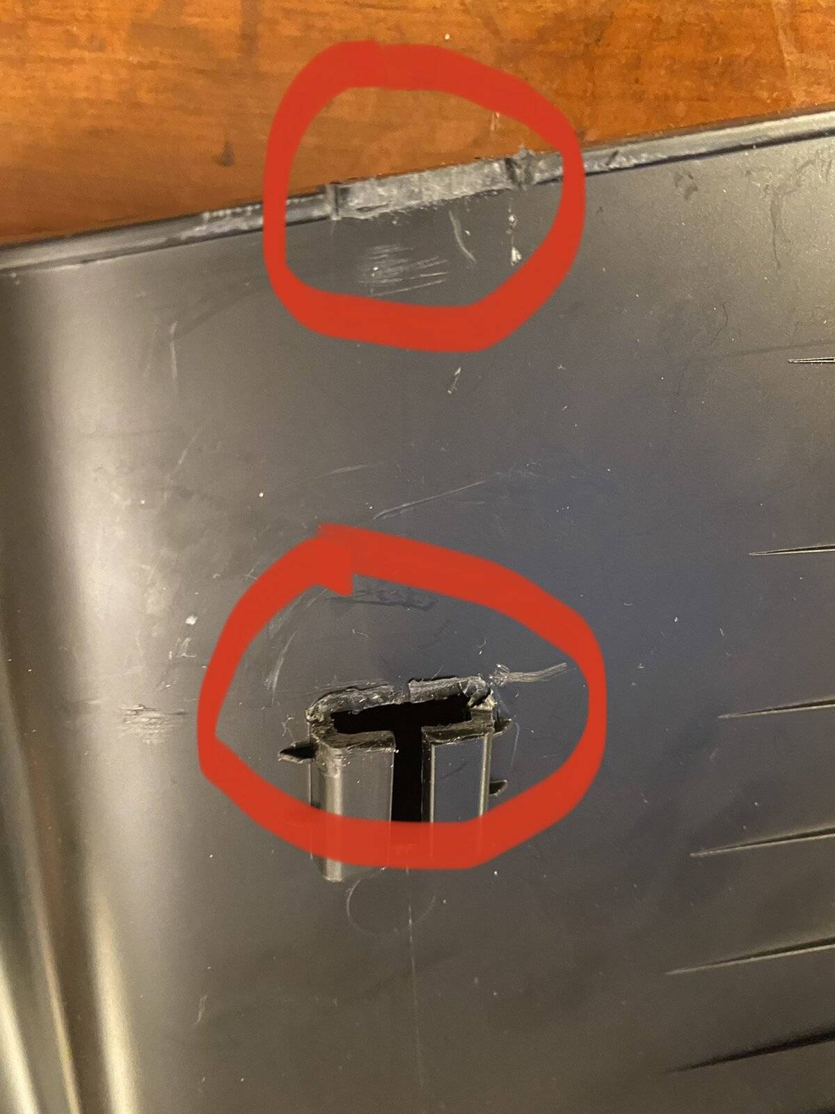

As I suggested in another post in another thread the center cross support of the frunk divider can easily be made removable with a Dremel tool or x-acto blade. I sliced the bit of plastic that stops the support from being removed away from the two side supports. Also need to remove a bit from the top of the two side supports.
