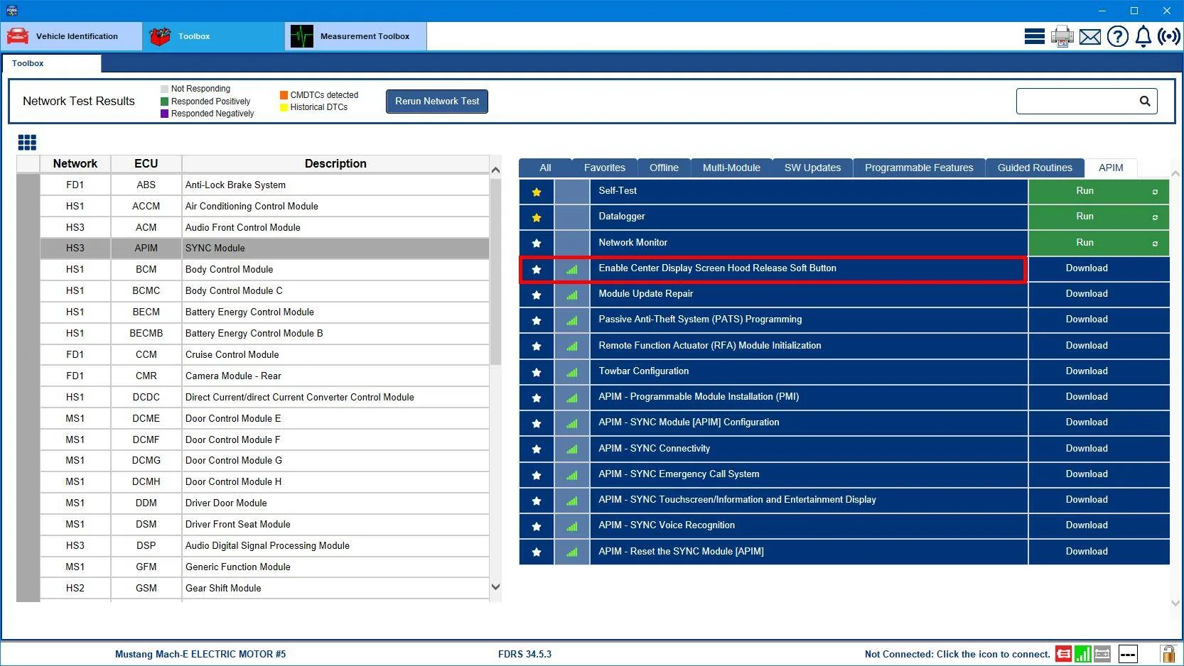

Note: that does not fully enable remote frunk release functionality, nor has ford announced the release for Job 1 owners. It’s sort of a “happy coincidence” more than anything else.
Respectfully disagree.
All that is required to enable the functionality (from the standpoint of the car's systems) is the GFM followed by the BCM update (or vice-versa).
The fact that the Frunk soft button does not appear in the Access menu is a separate issue from whether or not the functionality exists.
There is no trickery or hacks involved in this. BCM/GFM will enable the door keypad and support the use of a suitable (in the US a Lightning) key fob.
The Frunk button not being visible in the Access menu is resolved by this routine in FDRS:
Ford Mustang Mach-E Frunk opens electronically: 2021 Job 1 First Edition Mach E Frunk_Button_Enabl
While I understand and sympathize that it has taken Ford way too long to effect this seemingly minor change, much less to deliver such a change via OTA, the functionality does exist even if it has not been bestowed by the OTA fairy.
If Ford created a CSP to make this change on your car would you go to the dealership to get it done?
Totally disagree. Ford has not officially announced, or released a remote frunk release for MY21 Job 1 vehicles to the best of my knowledge (other than the now-deleted late Friday night tweet from Farley). Just because there happen to be bits of code that can be downloaded and installed by enthusiasts with the right equipment, doesn’t mean that the functionality has been released by Ford.
To answer your final question: Yes. If Ford were to say that the functionality was available, but had to be enabled by a dealer, I’d head to the dealer. That’s a no-brainer.
