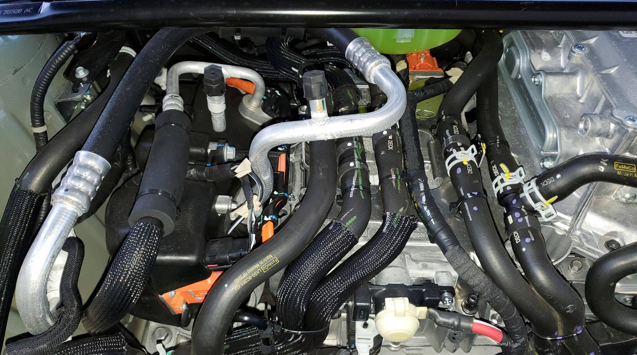

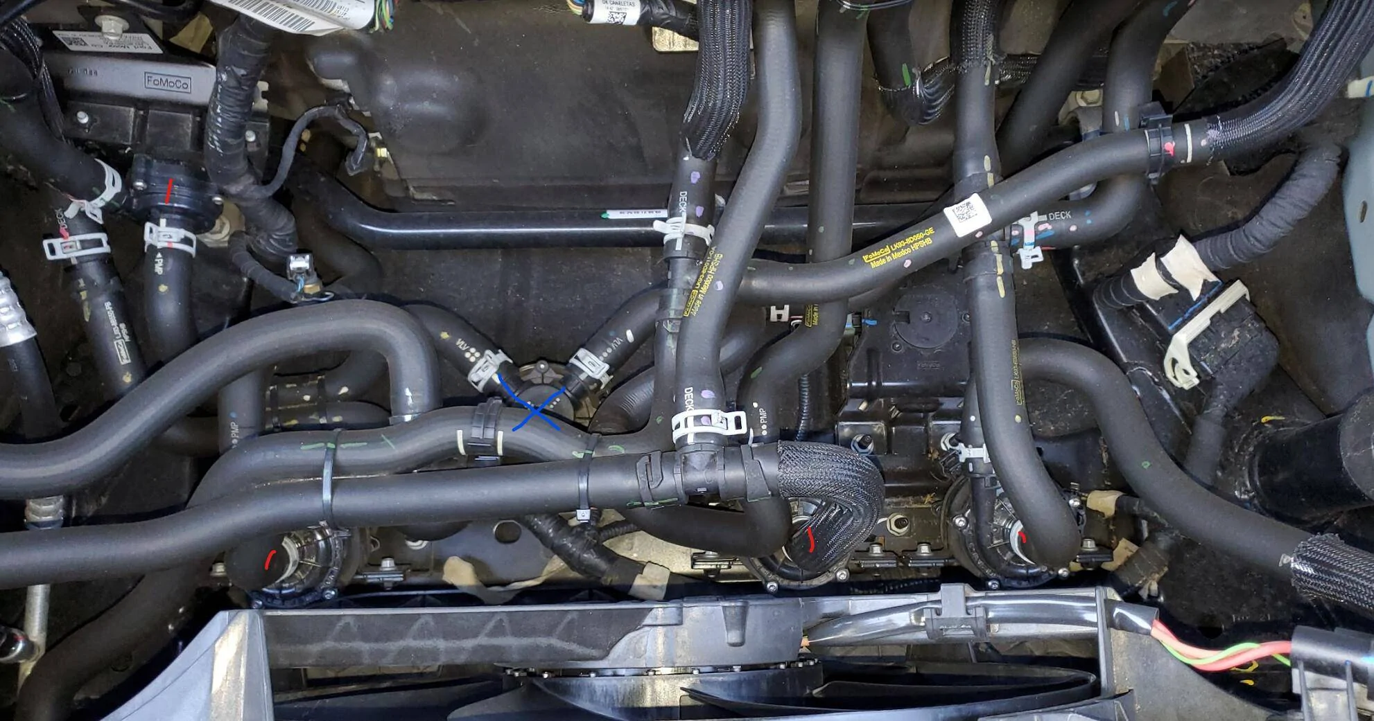

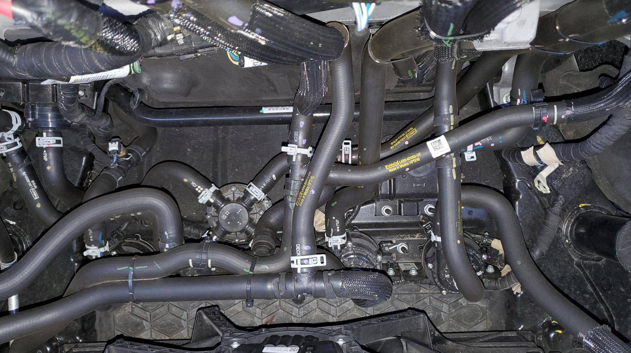

Can't believe there's only 4 pumps under here, I mean ford could have easily put 2 more

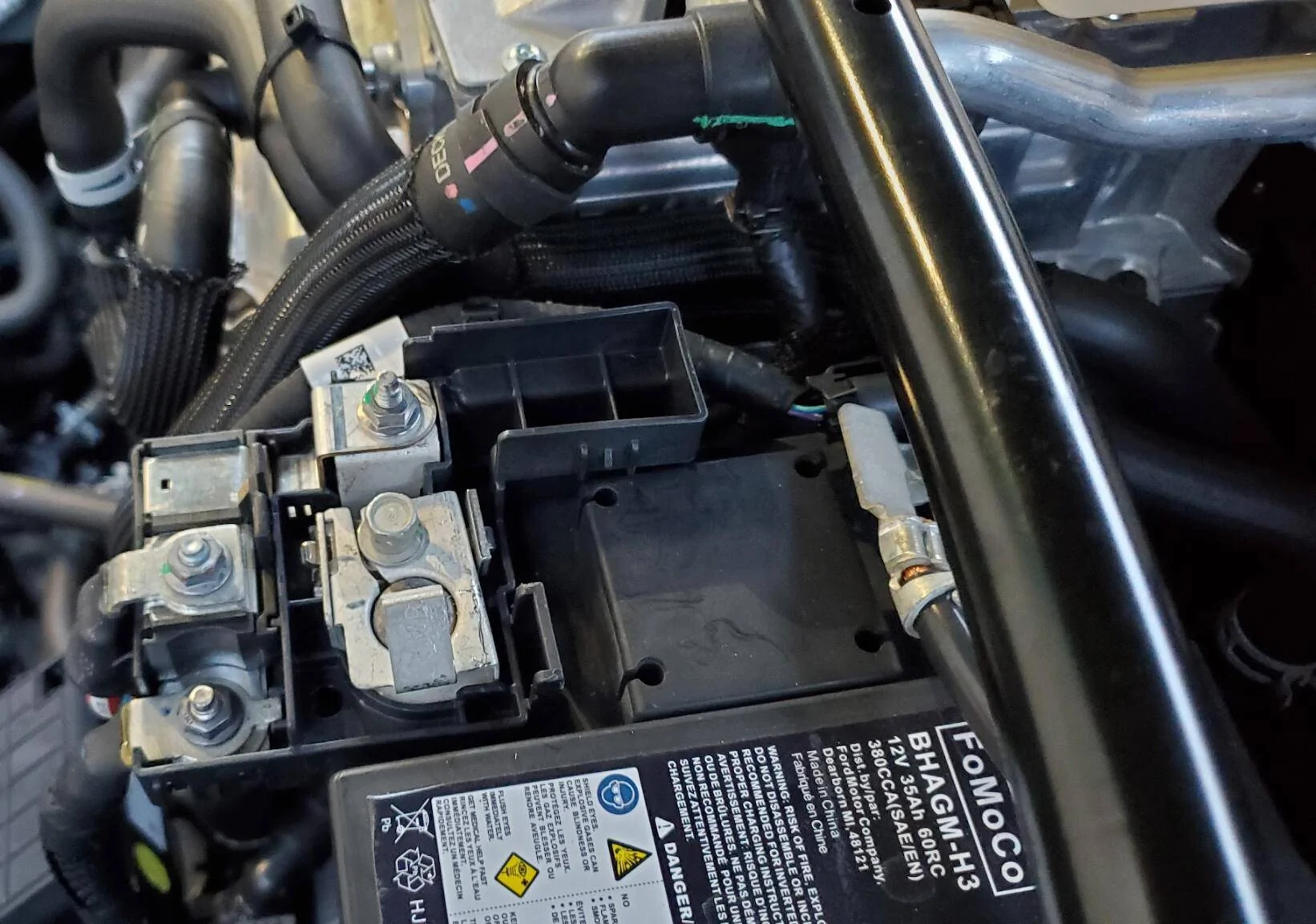

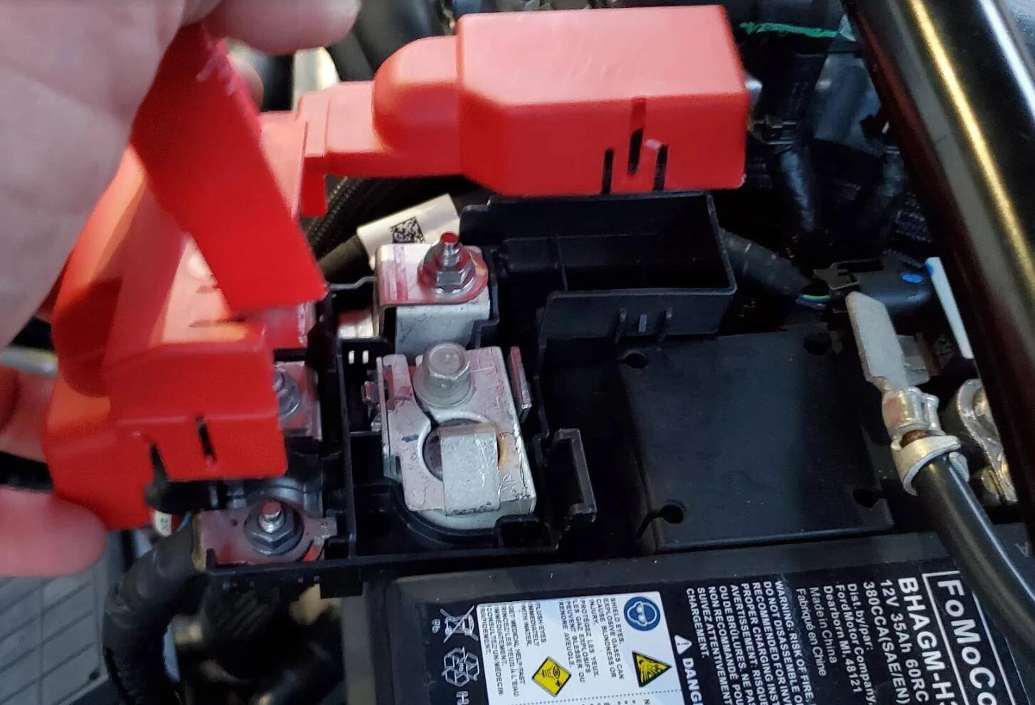

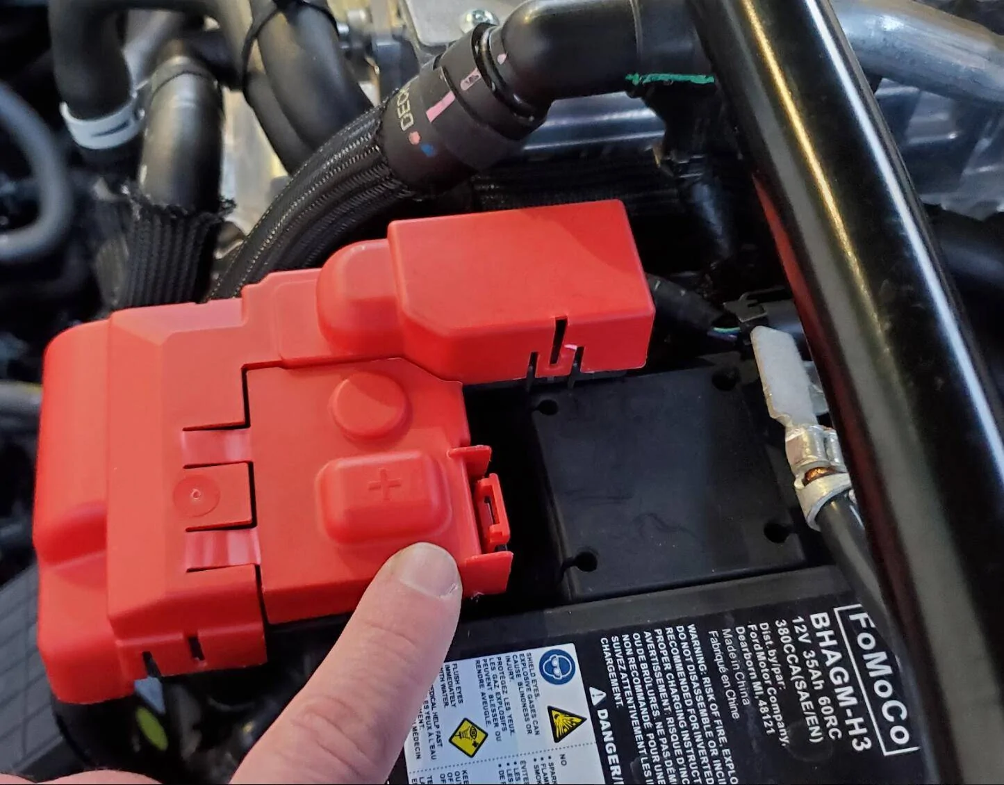

Looking to tap the batt? Here's a close up

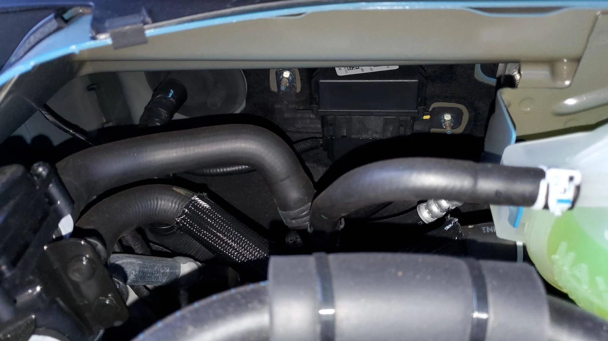

Wire for DC-DC to batt

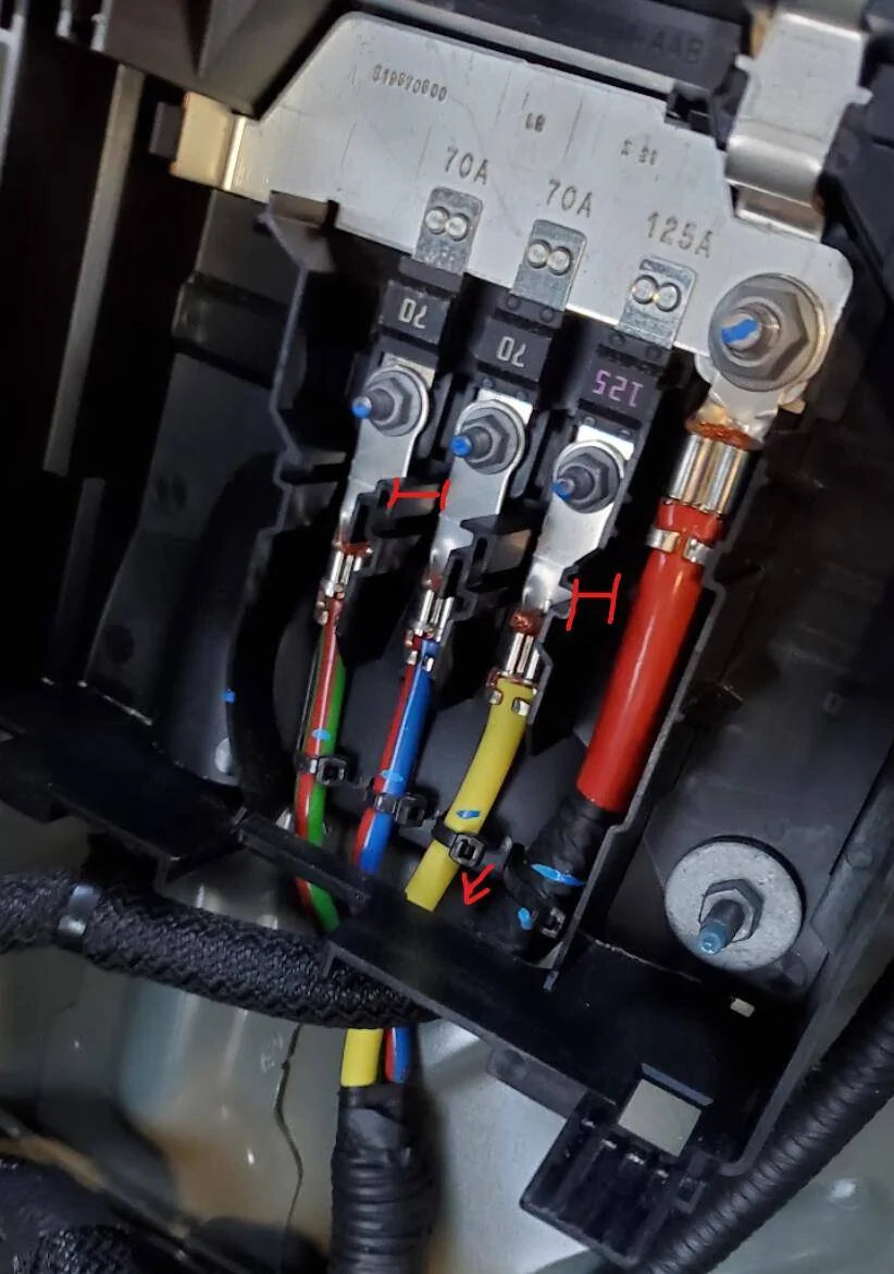

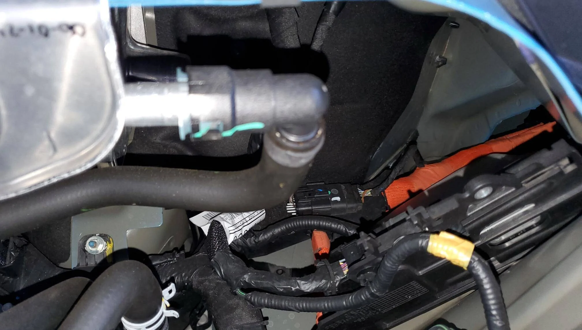

Notice the height / distance available to tap here as well, Large red is batt incoming - Low power devices ONLY from this box!

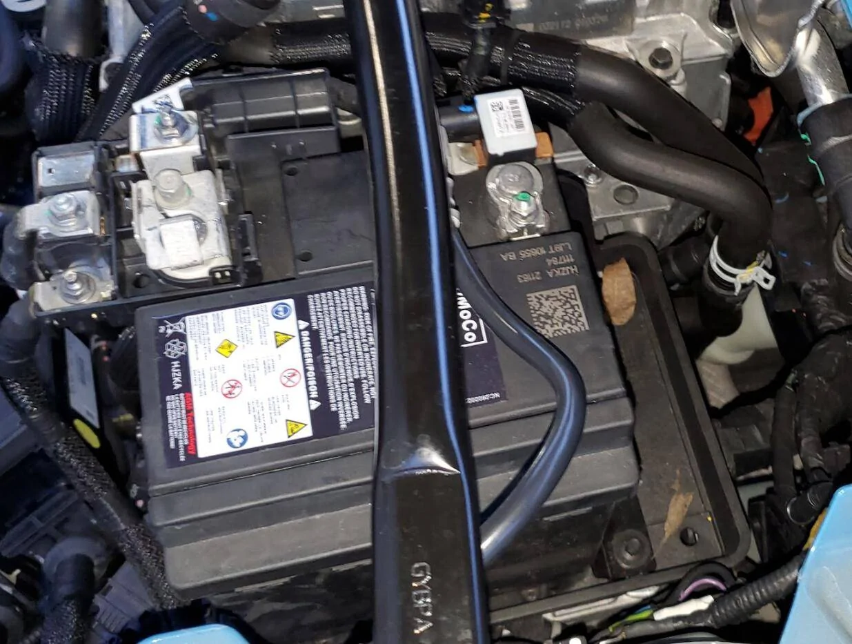

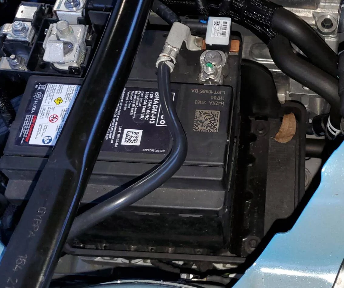

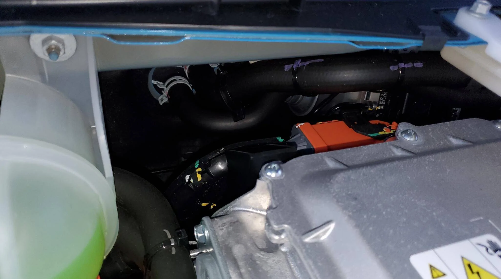

Batt tray can hold a larger batt too
