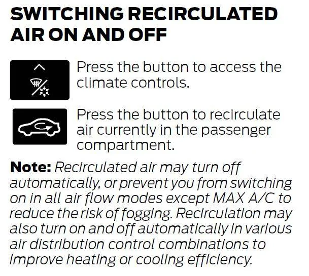

This video looks at the e-heat and does some testing with a laser thermometer. You can watch the video but my takeaway was that to get the hot air coming out he switched on the re-circulate button. This noticeably increased the temperature coming out the vent. Sometimes the heating is very weak and this is a good way of beefing it up. I haven't had a chance to test this out in the car yet.
