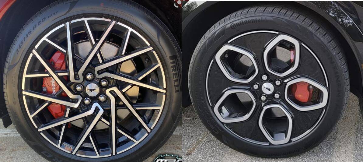

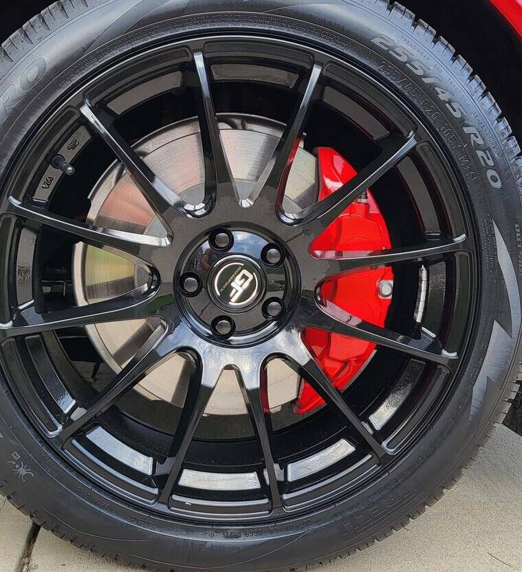

Okay thanks.The issue is the marketing clearly states that the GT & GTPE have the same size rotors, the current parts guide has the GT using the same rotors as the regular mach-e, as there is only 1 dust shield which is made to accommodate both, the GTPE rotors have a few mm to spare where the normal rotors have a more obvious gap, the photo posted of the GT has that same gap which matches parts but goes against the marketing.
Hence the op wanting clarification and quite rightly expecting to get what has been marketed not a switch a roo, as false advertising tends not to get looked on kindly legally so Ford need to offer an explanation.
So, it sounds like the OP doesn't have a car to measure for himself yet?
And it sounds like someone has confirmed the dust shield is the same for all models?
And nobody has looked at the rear rotors of a GT yet?
If the GT has the same front brakes as the other non-PE models then doesn't it also make sense it would also have the same rear brakes as the other non-PE models? Wouldn't that be super easy to see with a visual check?
The literature says the GT and GTPE have same size rotors front and rear. Has anyone posted photos of the front and rear wheels from a GT? That would be a good clue right there because it would be easy to check.
As far as I can tell.....there is no version of 18" rear rotors on any model so if the GT has the same size rotors front and rear (which can be easily determined by visual comparison) then they would almost certainly have the 19" rotors.
Or of course just pull the wheels and measure the damn things but apparently that hasn't happened yet. If I had a GT or a GTPE available to me then I could answer the OP's question fairly quick.
