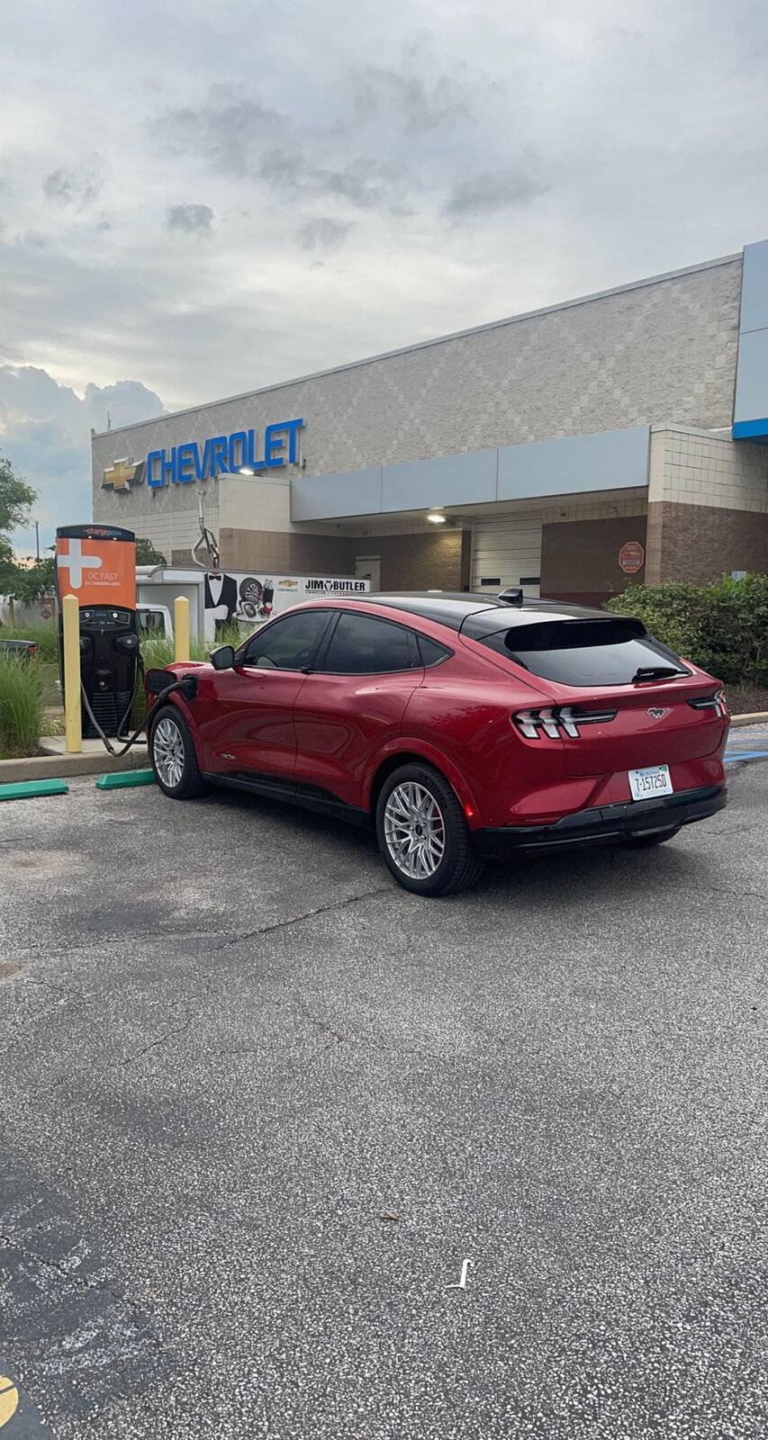

19" will be fine. The brakes are the same as all Mach-E's. They just put the brembo decal on them.
I have a set of 19" wheels from my FE with 245/50/19 Michelin Pilot Sport 4 All Season tires I'll use for winter. We usually only get a little bit of snow here so no reason for dedicated snow tires. Pic of 19" wheels on the FE that will go to the GT for winter.
Unless their media material and tech specs are wrong, this is not true. The GT PE and GT are the same size. The lesser models have 18 and 17" respective discs. The GT and GTPE have 19" discs front and rear as claimed. However Brembo indicates the discs are 385mm.

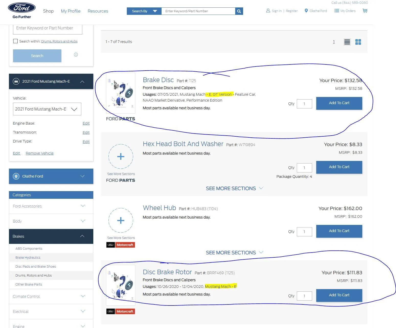

Edit Ford's HVBOM is wrong the GT has larger front brakes than other models.
385mm = 15.15"
17 and 18" is a BS figure, that would be just freaking insanely large rotors especially 19" on a GT holy hell. The Porsche 911 Turbo has 408mm rotors which are only 16.06"...and that's huge!
I looked up the rotor part numbers in HVBOM for both my GTPE and my FE. HVBOM is a bill of materials for any VIN that will list every part in the car (if it's updated...)
All rotors the same front and rear: LJ9Z-1125-B (front) and LJ9Z-2C026-C (rear)
I looked up the brake pad part numbers too: LJ9Z-2200-A (rear) and LJ9Z-2001-A (front). Same for both GT PE and FE. They didn't even change the pad compound for GT/PE.
Calipers: LJ9Z-2B121-B...and I was too lazy to find the rear. Same front for both GT PE and FE.
So yes, the brakes are IDENTICAL unless Fords BOM is plain wrong. However I didn't run a RWD vehicle or a select through so that is always possible, but I kind of doubt they're different.

Can't see part numbers really but different part noted and price for Disc specifically.
According to HVBOM the part numbers are the same for my VIN and my FE's VIN so not sure. Fords stuff is often pretty screwed up lol so maybe HVBOM is just wrong. I'll go measure the rotors when it stops raining. All I know is they are NOT 19" across.
