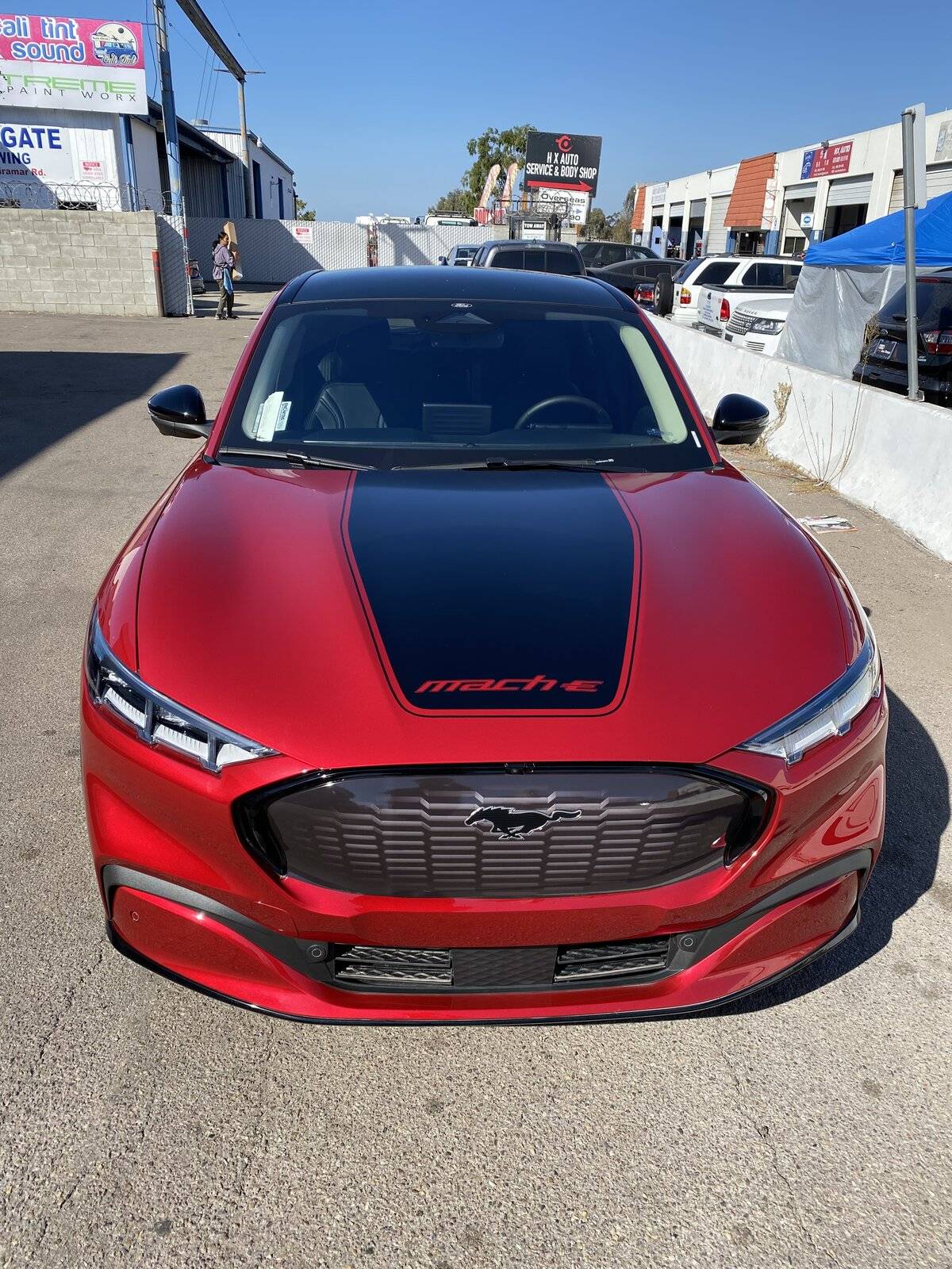

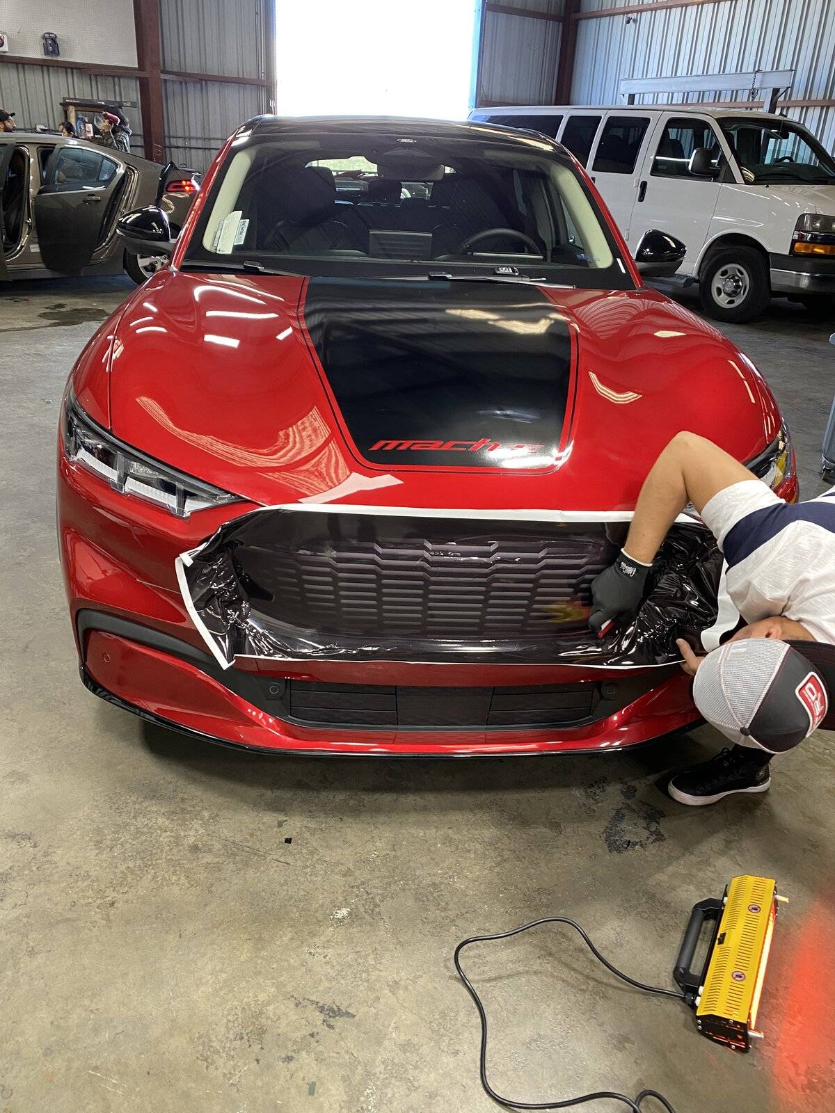

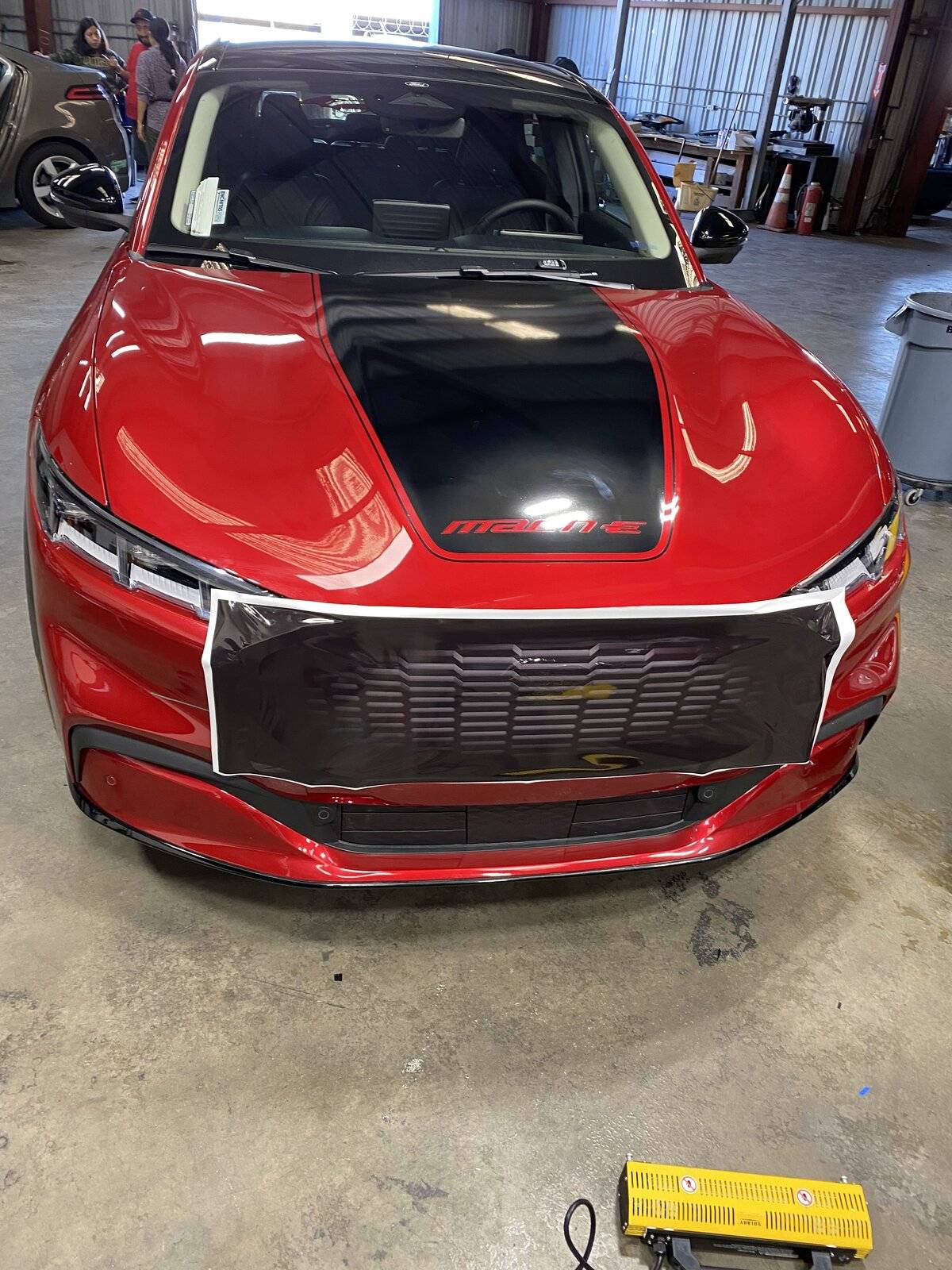

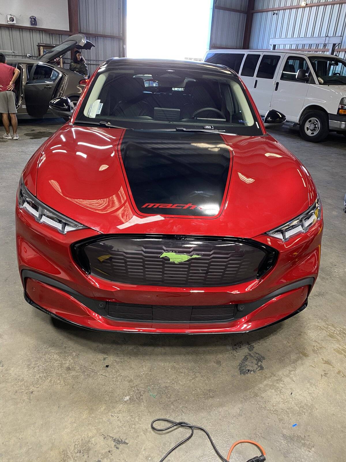

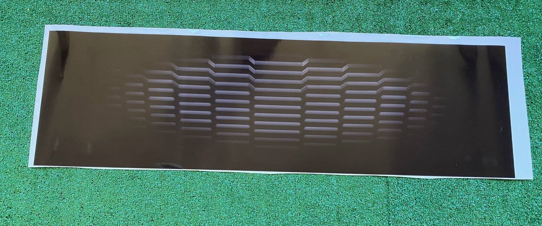

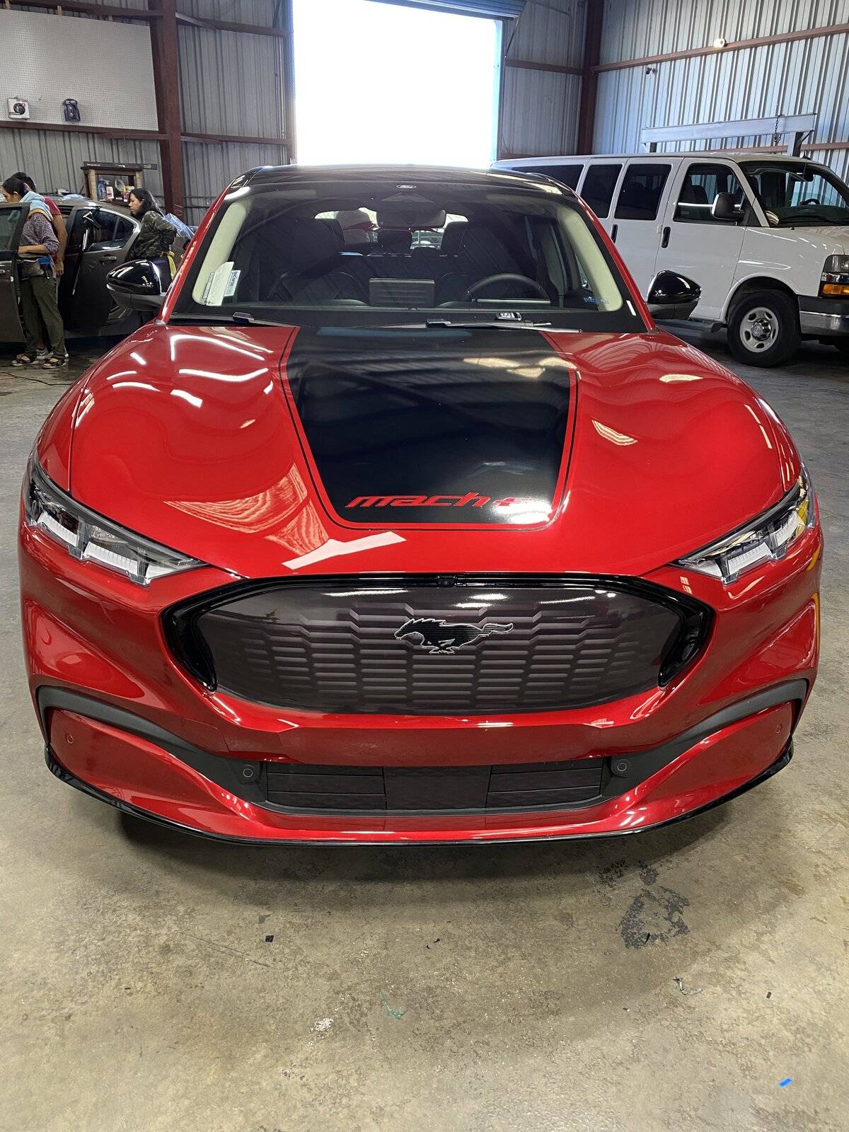

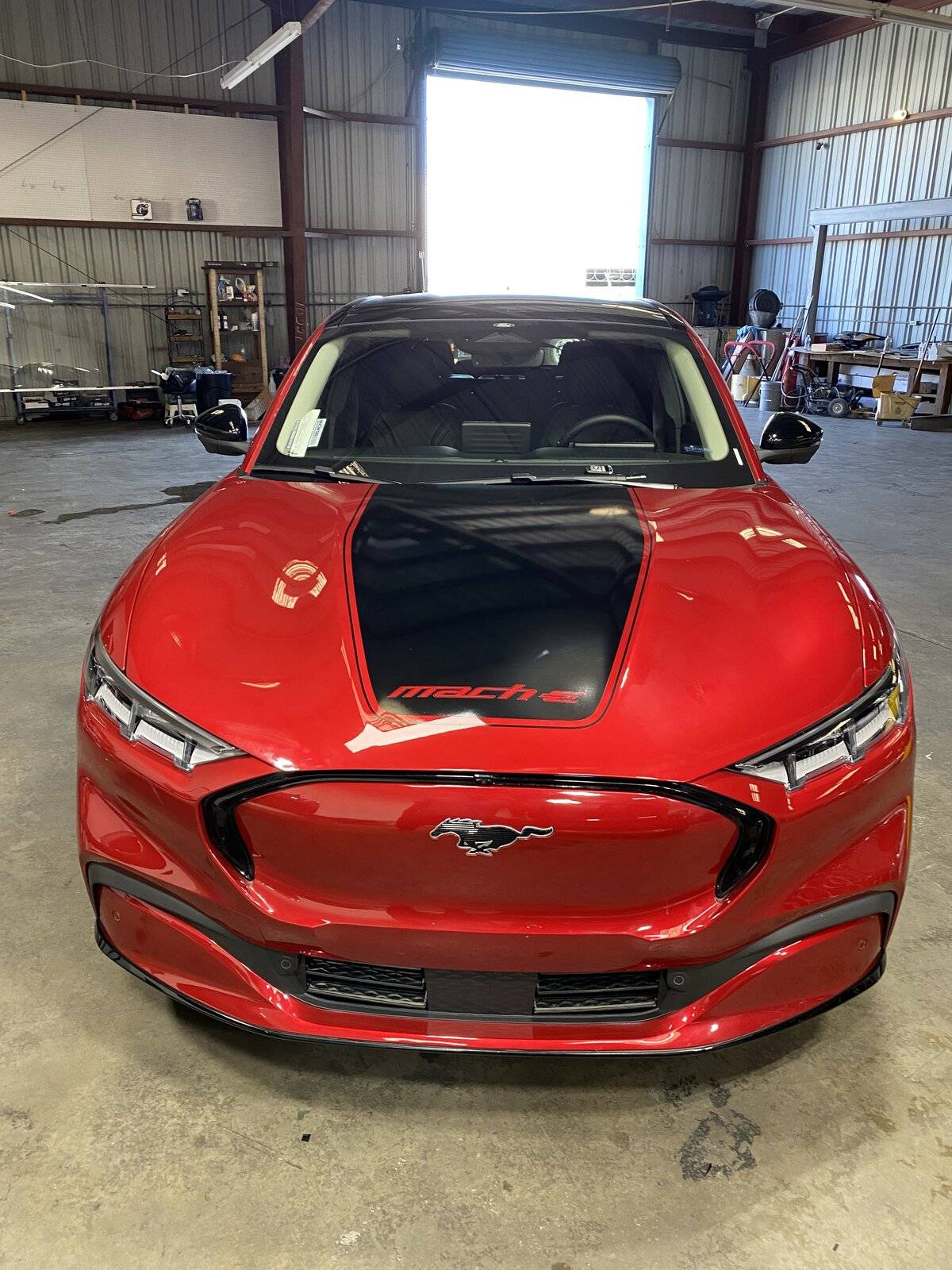

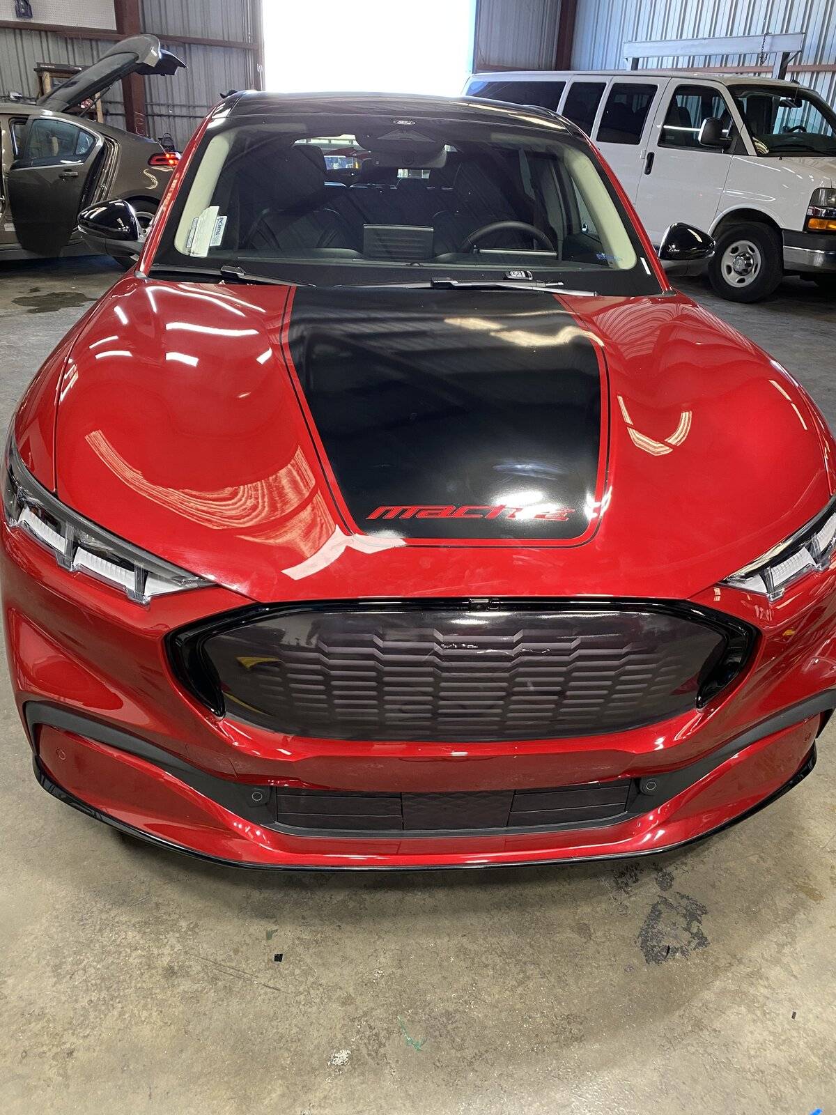

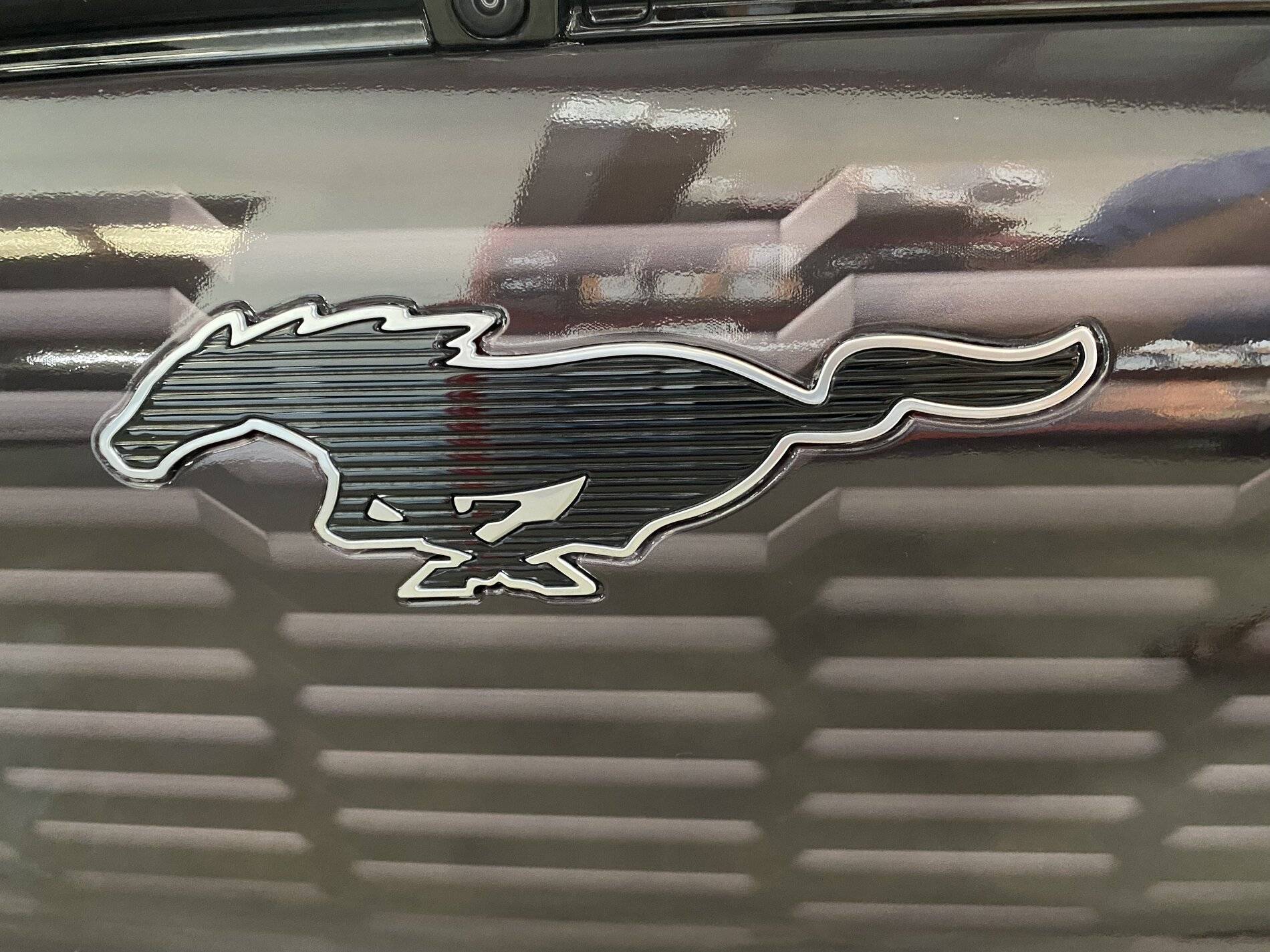

While doing striping, I’ve done both approaches on my car (removed the emblem) and my wife’s car (left emblem in place and then cut. Leaving the emblem in place is absolutely the better way. No breakage of the pins AND a better lay of the vinyl. When I tried replacing the emblem over the vinyl on my car it wanted to gather and bunch at the edges.Not sure how easy it is to remove the emblem. Everyone are following the same approach of cutting around it. So I also went with same approach.
Also, I did Mod a lighted Pony on my Premium, but at this point I say it isn’t worth the hassle. Someone will make an aftermarket one sooner or later.
