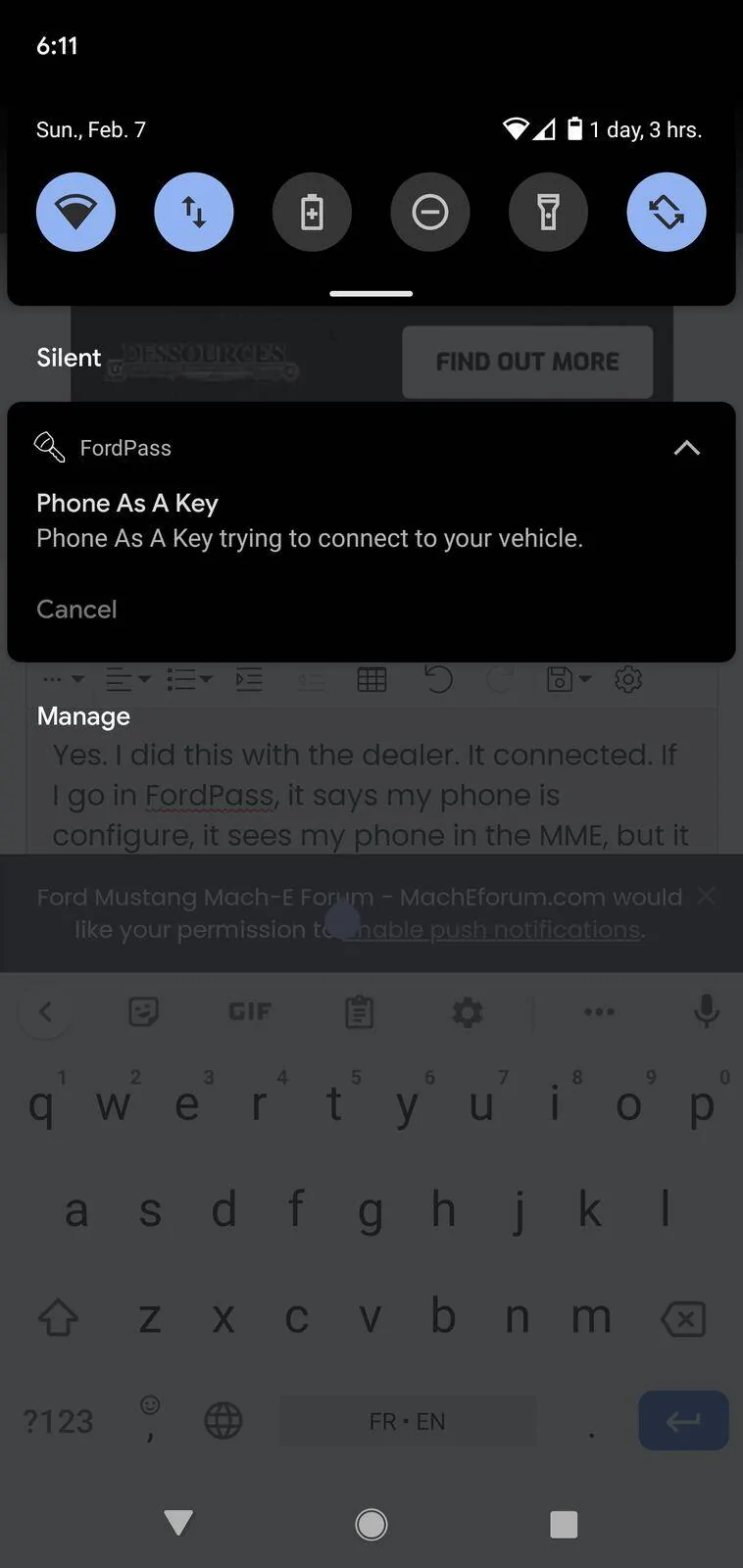

So I picked up my MME today. With the dealer (who never did this before) we started setting up all the things. We started by setting phone as key. I don't think it's working? We did it with the FordPass App, and while the MME says it's connected and I got an Email from FordPass telling me the phone as paired, on the FordPass App, there's a message that is constantly there saying : "Phone as key is trying to connect...."

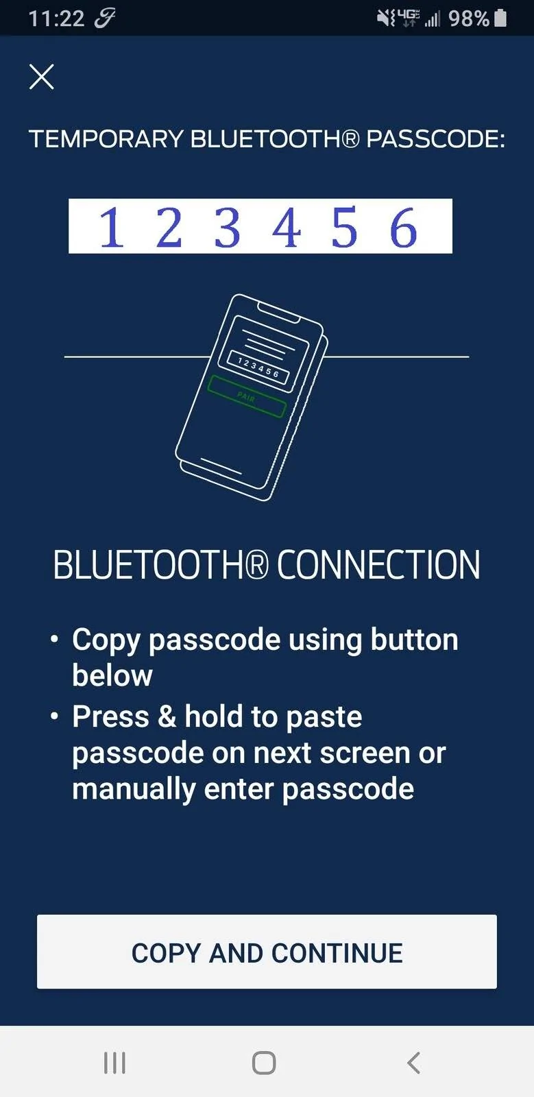

Did you enter a six-digit code when connecting the phone via Bluetooth (2nd time) to something with a mac address? (See first image) I had to pair both the MME and the unlocking system to my phone via Bluetooth.

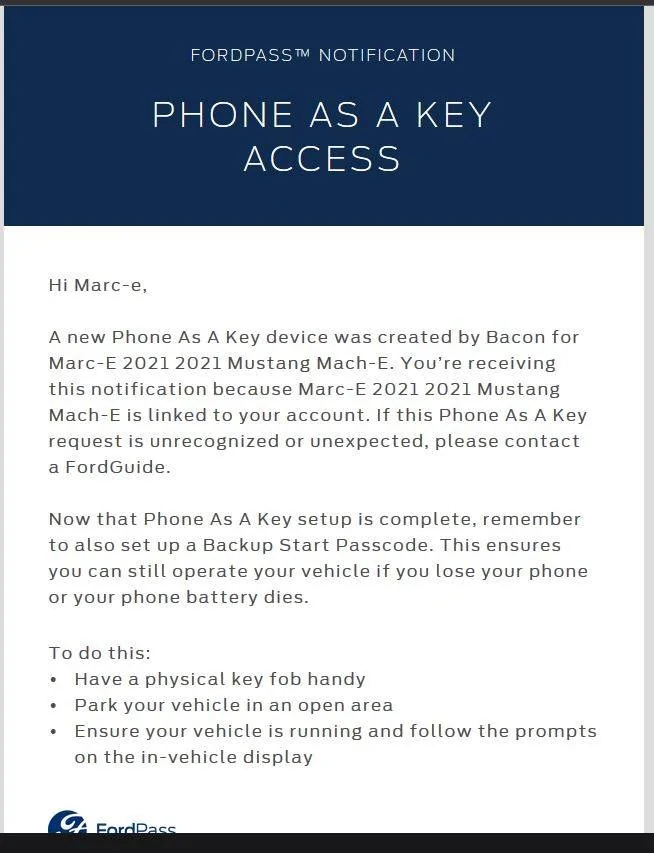

Did you receive an email that the phone was added as a key? You mentioned paired; my email's subject specifically stated "Phone As A Key for Bacon has been created for Marc-E 2021 2021 Mustang Mach-E." (See second image)

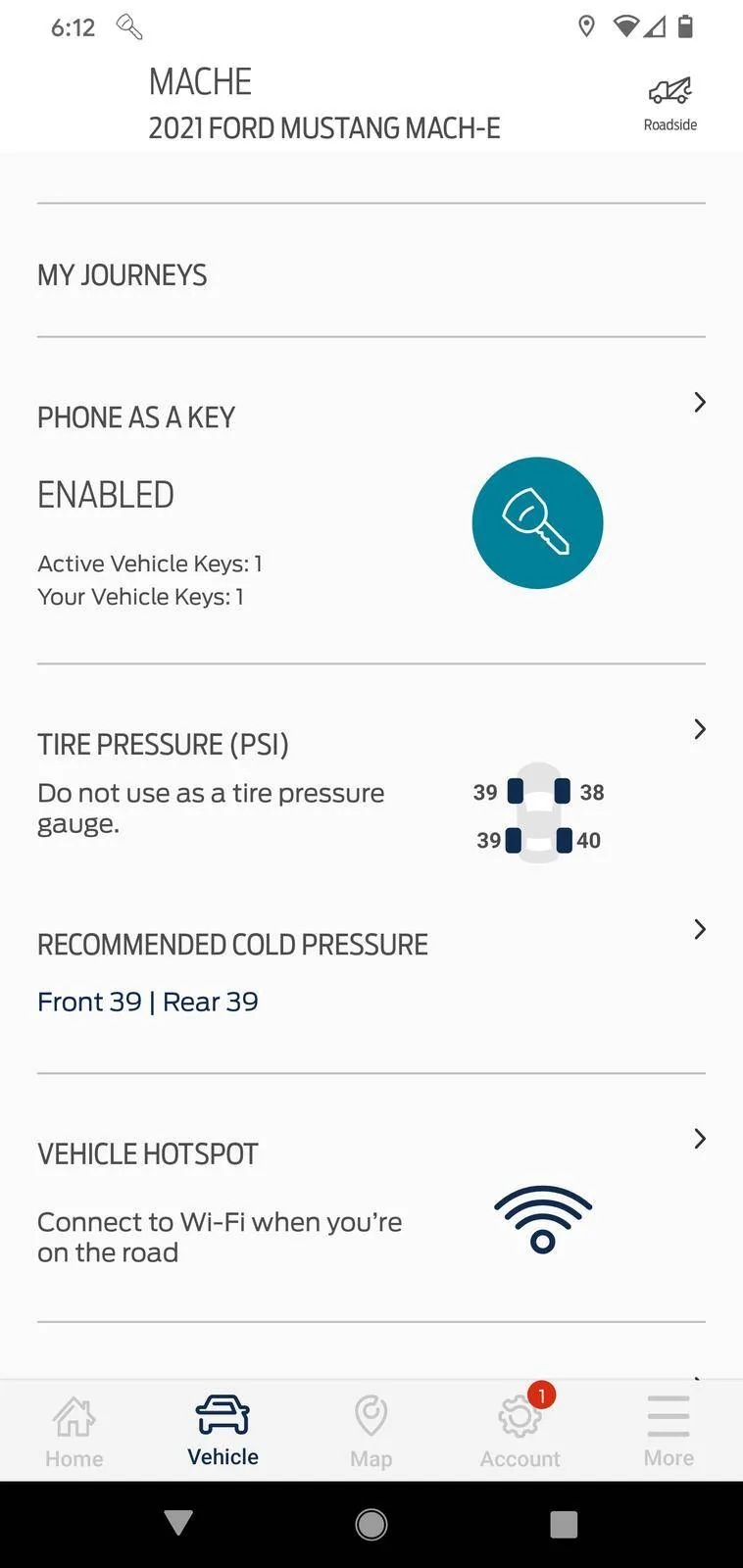

Yes. I did this with the dealer. It connected. If I go in FordPass, it says my phone is configured, it sees my phone in the MME, but it just cannot connect.

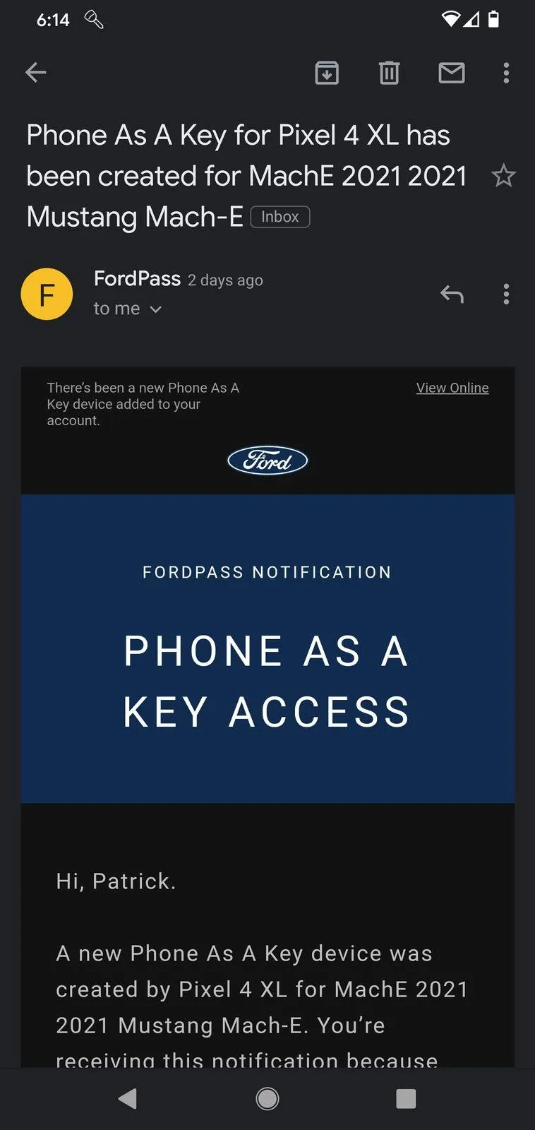

I did get the email too.
