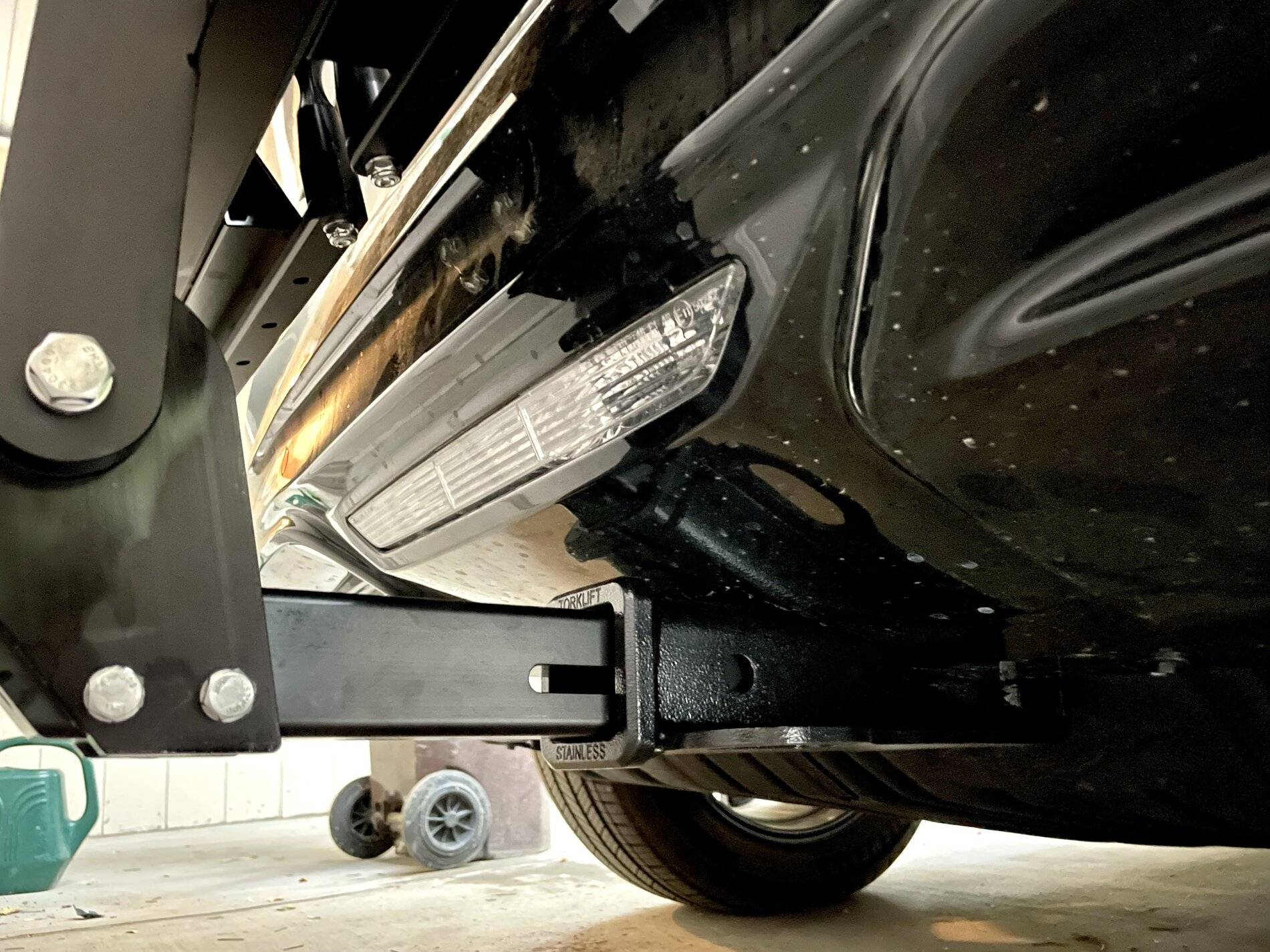

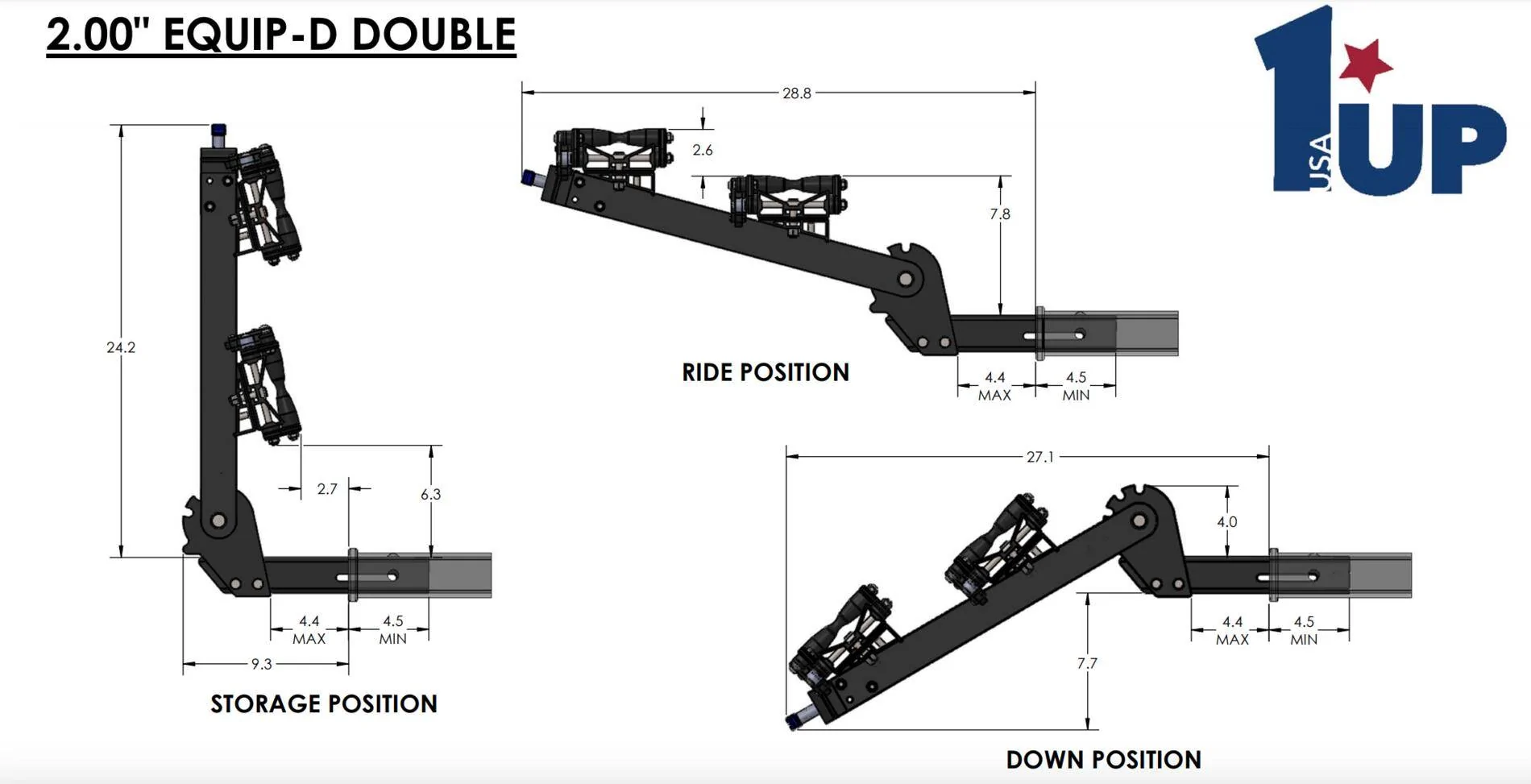

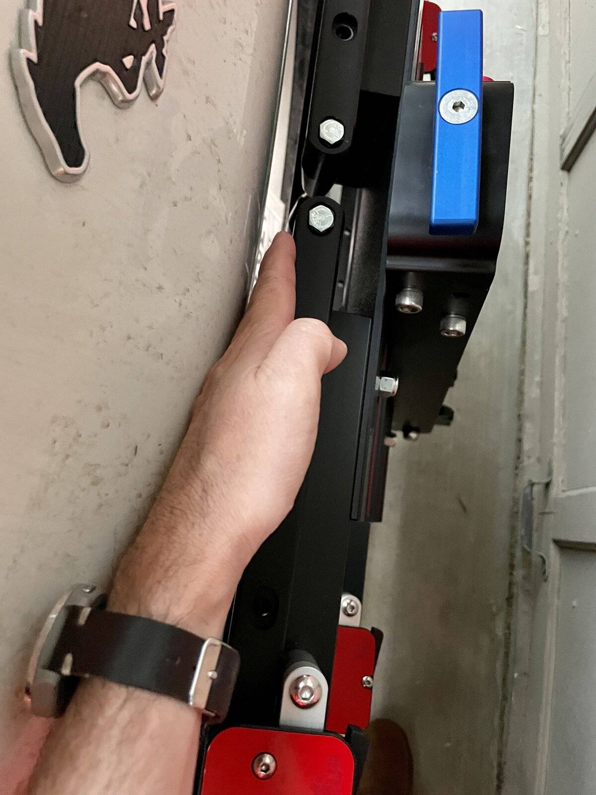

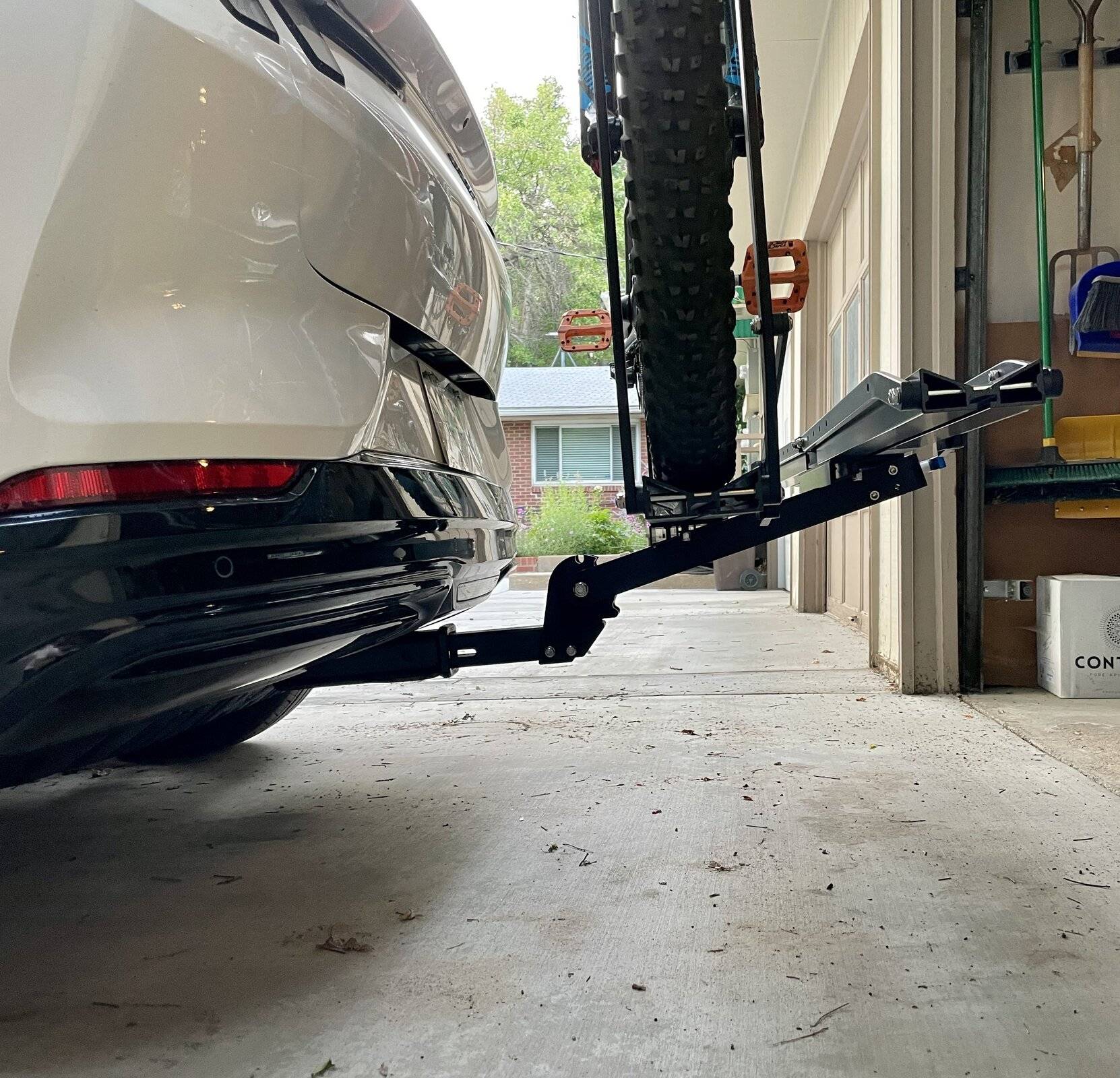

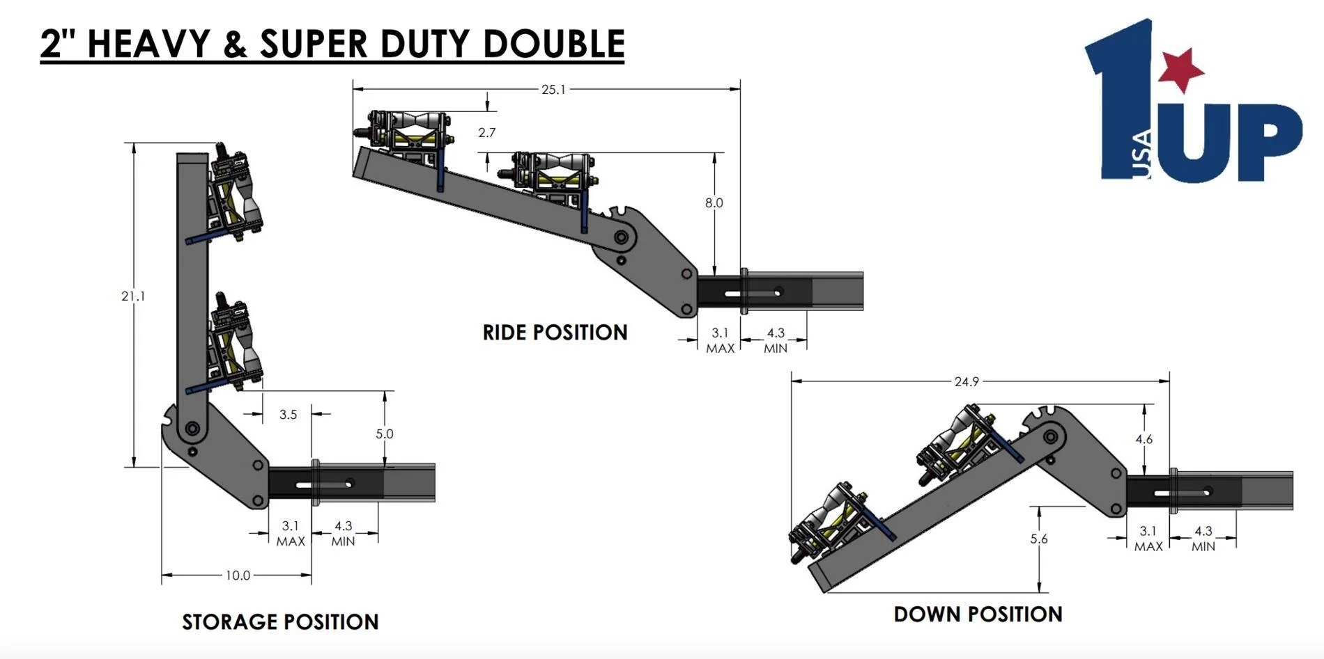

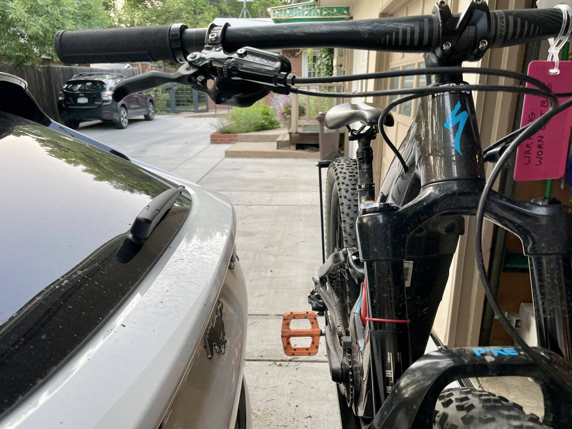

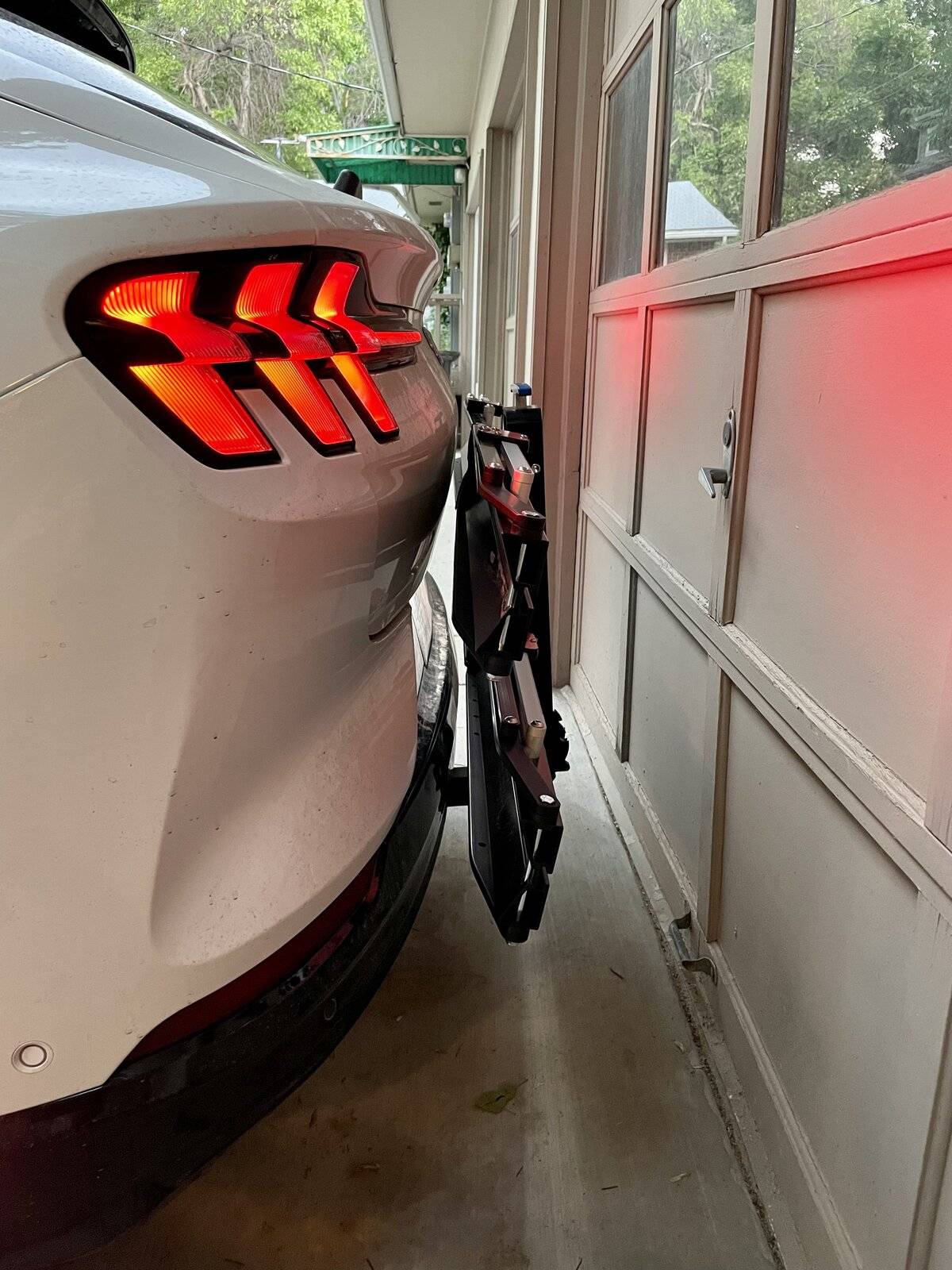

I just installed my Torklift Ecohitch, and my 1UP EquipD double bike rack. The fit is a little close for comfort. The hitch requests a minimum of 2" of insertion after the anti-wobble bearing, which doesn't work. At 1.5" of insertion, the rack is far enough out that it won't hit the car, but just barely. It is plenty far out with bikes on (even with 800mm bars), but in the closed position it is very snug. I'm sure they have a little safety factor in their 2" recommendation, but I don't love that I have to go out so far to get a solution that just barely fits. You can also tell that 1UP doesn't like this level of extension because the slot doesn't line up with the hitch pin hole, meaning it can't be locked to the vehicle like this.
I've ordered a Kuat Hi-Lo adapter, which gives up to 7" of extension, and 2" of rise or drop. Unlike straight-through adapters, however, it looks like in this case if I drop or raise the rack (probably drop), then I can probably slide the 1UP deeper, and get less than 7" of total extension. Ideally I'd have about 2-4" of extension. Dropping by 2" looks like it would be OK from a clearance perspective as long as you aren't on any really rough roads.
The hitch and rack themselves are great, both very high quality, I just wish the Torklift came with another 1-2" of extension, that would make it a perfect fit out of the box.
