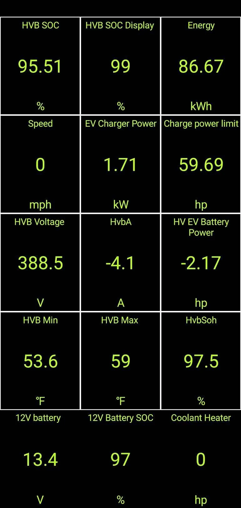

I bought my 2021 GT AWD 2 weeks ago, certified pre-owned. I got an OBDLink MX+ and CarScanner to check some numbers. I am charging to 100% to get max numbers, and here's what I have (at 99% as I know some of the numbers disappear when not charging).
Looking at the HvbSoh it shows 97.5%, which seems reasonable for the age. The HVB SOC is 95.51%, the HVB SOC Display 99%, and Energy to Empty is 86.67kWh (at a battery temp of 55.4 degrees)

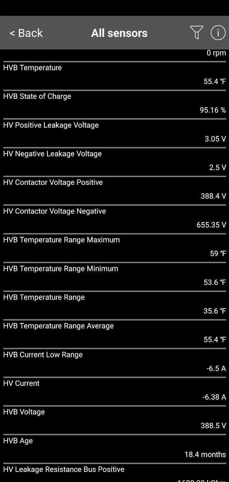

I also screenshotted the battery sensor screen. According to the window sticker (confirmed by the date on the door) the car's date is August 9th 2021, but according to the battery age in CarScanner the battery is 18.4 months old, which puts the battery date at September 20, 2021. Does this indicate that the battery was changed? Or that one of the dates is wrong?
