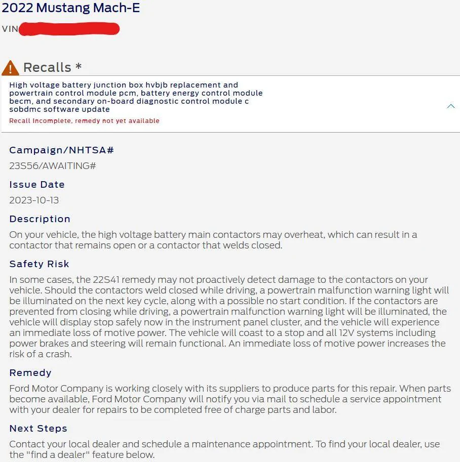

Could these be even newer designed parts than previously used for replacement? That might make sense if it applies to those who have already had replacement.
I notice the statement on the website under Remedy that indicates the parts are not yet available:
Ford Mustang Mach-E High Voltage Battery Junction Box (HVBJB) Replacement Recall for  recall HVBJB in 30,013 Mach-E 1697497662624
DevSecOps
Todd
Sep 22, 2021
67
4,502
11,050
Sacramento, CA
CISO
Likely not otherwise it wouldn't be isolated to vehicles before May 24, 2022, it would be on all of them.

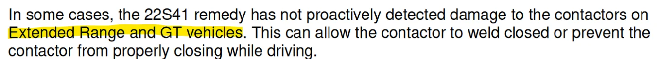

generaltso
13,894
24,883
Vermont
2021 MME Premium AWD SR Infinite Blue
It's not just for ER and GT, it's just pointing out that a previous fix may not have detected the damage correctly.
If they think the previous fix was only ineffective on ER models, I suspect those will be the only models included in the new recall.

DevSecOps
Todd
Sep 22, 2021
67
4,502
11,050
Sacramento, CA
CISO
Not sure that's correct. Between the first MachE sold and May of 2022 they sold 43,580 units, but only 30k are being recalled. That leads me to believe that the 13k excluded are SR units.
