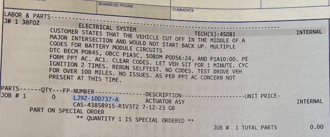

UPDATE:
After almost two weeks of being at the Ford Service Center, I was told that they were done.
The couldn't replicate the issue (they had put 150 miles on it and a technician had to even drive it to their home and back and keep it overnight to run diagnostics on the car). The car had cleared out the error codes and is behaving normally now. So they do not know what happened.
They said they had replaced a battery controller (one of the other error codes that was listed) but they are not sure if that will solve the issue or do not know what caused the issue in the first place...
They cannot say if the issue will happen again or not.
10 days ago Ford Customer Service said they will call me back regarding gas reimbursement for the loaner and they never followed up. I called again today and they said they will have to check and said they will call me back.
The car drives fine, but I do not know if it will "glitch" again or not...
You may be misunderstanding or more likely: the service advisor isn't communicating effectively.
Looking at the portion of the paperwork you shared, it states that the technician DID observe several codes. Then he or she followed field service troubleshooting steps from Ford. Part of the troubleshooting included clearing trouble codes. This is normal/typical. They then performed further tests and the problem did not reoccur.
The technician also replaced a part.
What is unclear is whether the part replacement solved your issue or the other troubleshooting steps. Either way, your vehicle is now back in service.

They had called me prior to replacing the part. They wanted permission from me to allow the technician to drive the car home (that was the only way they could drive the car for 40+ miles each way) to run diagnostics.
What was communicated to me was they could not figure out why the issue had occurred. One of the error codes pointed to a component that they said they have ordered and will replace. I was told that the error code thrown during the "High-voltage batter error" was the one that went away and not the reason for the part change.
So, the test drive was PRIOR to part change and was to try and replicate the error. One of the things they had suggested was the hot weather contributed and they wanted to run diagnostics as they did their long test drive.
248
10,366
21,959
That’s a voltage sense error I think. Could just be a random glitch, but if it happens again you might need a new pack harness, BECM, or a whole new battery pack if they can’t trace it down. You have a couple of low capacity cells in module 10 there, so maybe they could just replace those.
Either way, just drive it and see what happens.
