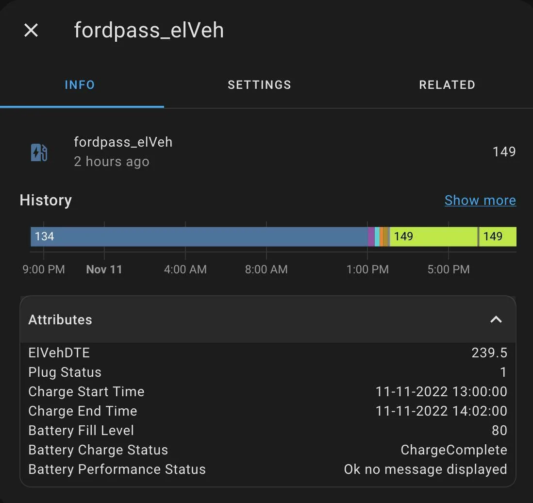

It is buried as an attribute inI didnt see Plug Status, I will look for that. Any clues about where it is so I can make a template sensor for it, please?
sensor.fordpass_elVeh
so you need to use a template to extract it:And here is a template snippet that works to extract it into a template sensor with a friendly name and a custom icon:
