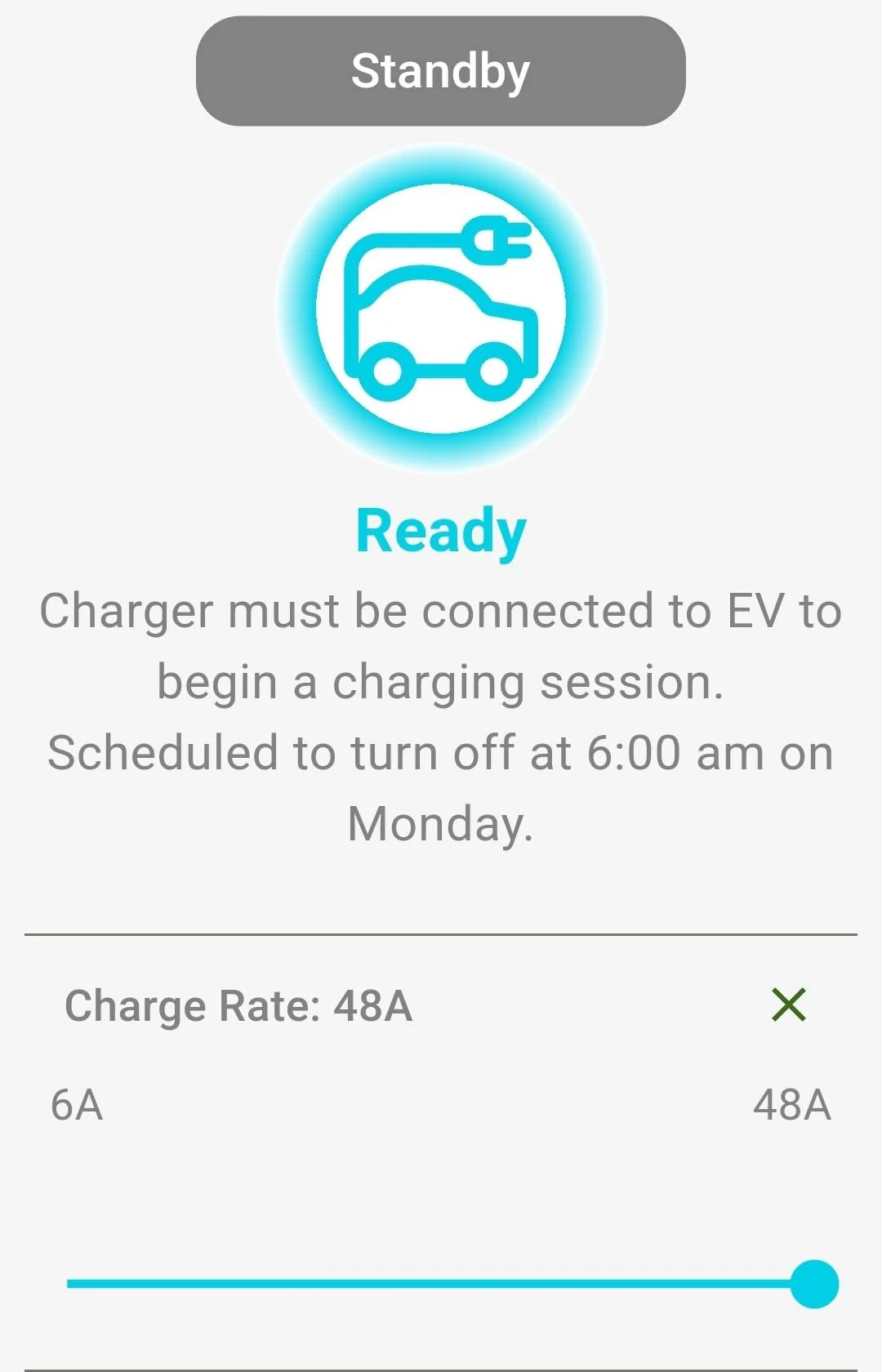

I like our Emporia. Allows you to adjust in one amp increments from 6 to 48 amps.
Just purchased an Emporia to replace my GrizzlE. The 5%machE code may still work on their site. Another way to get a discount is make an account and put a charger in your cart and leave it. Emporia may send you a 5% code to finish checkout in a day or so.
