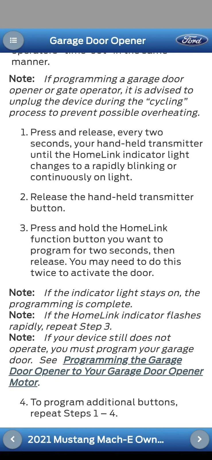

Not sure if you tried this as well, but there are some issues with timing so this could help
Ford Mustang Mach-E Home link connection to gate opener? Screenshot_20210221-220617
