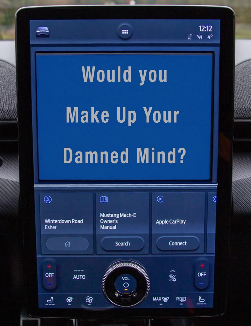

Ford Mustang Mach-E How do I charge to 100% overnight, again? IMG_4492
Interestingly when I put it back to its normal 80% position, the car accepted it right away. But before folks start in on Ford conspiracies, I suspect that it was simply because the car was awake now. So I tried again to set it to 100% and sure enough, it did it quickly. Same when I moved it back to 80%.
I'm pretty sure when I drive the car tomorrow, the SYMC display will look like this:
Ford Mustang Mach-E How do I charge to 100% overnight, again? MME Display
