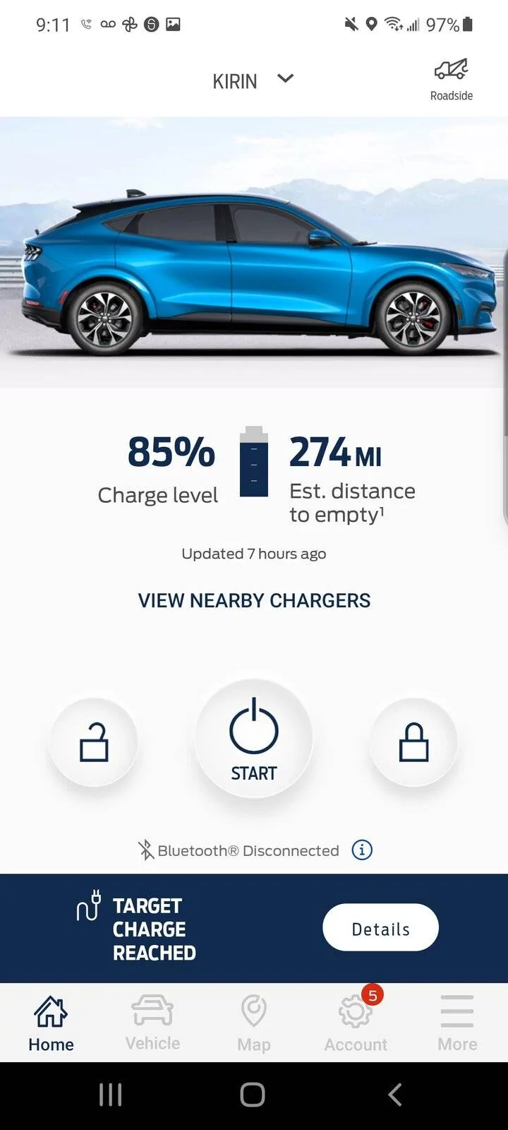

Well first of all yes: remain calm all is well.
Since your car is brand new you may want to reset the range calculation history (its in the settings somewhere). Then the car will start to learn your habits and calculate the range appropriately.
Given that: As the weather warms up you'll see better range. It is likely you may even see 300 miles at some point (of course that may not be accurate for a highway road trip but if you drive in the city a lot for "a tank").
Also try to turn off e-heat as much as possible.
My California Route 1 just showed 300 miles on a full charge this morning...

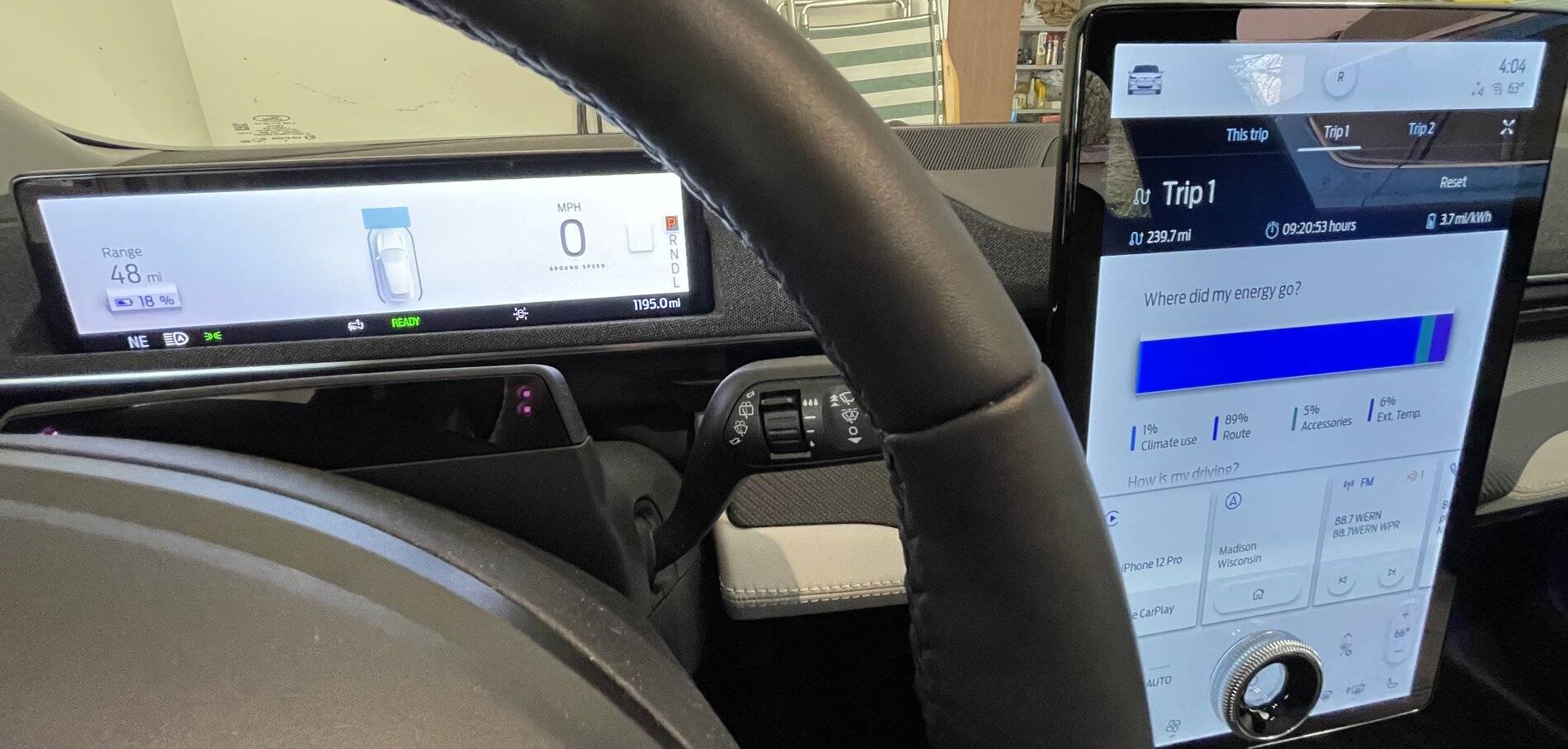

This time of year, getting over 270 is very easy. Here are some numbers. “Trip 1” is the distance I have driven since full charge. 18% remaining. 3.7 miles/kWh. do the math. This was 75% around town and 25% at highway speeds. I just fully charged again and the GOM now says 298 miles. Note that my car has been learning about range for over 1000 miles now. AWD ER.

The real number to watch is your miles/kWh. Track it over days/weeks with the trip meters. Multiply by 88 kWh and that's your better range estimate for that type of driving/temps/conditions.
