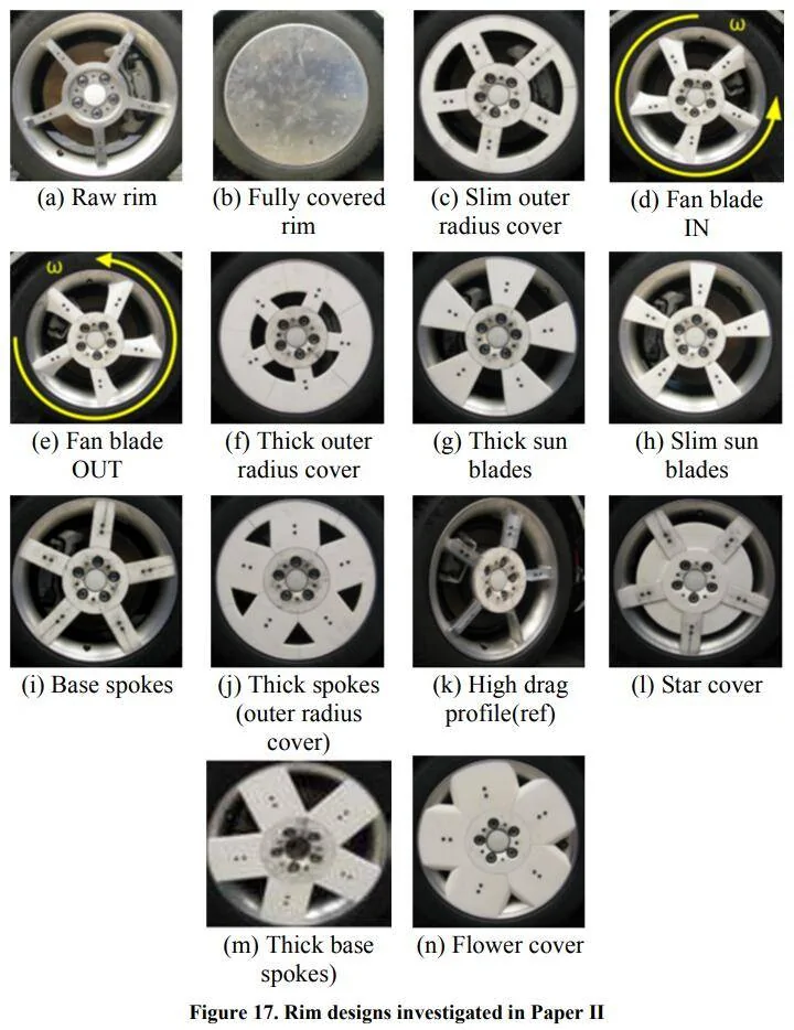

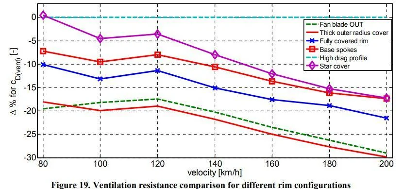

Cool video, but unless I missed it, I don't think it explains WHY the higher diameter rims reduce range. Is it just the air resistance of the higher diameters? Could that be fixed by having fins in the rims?
He addresses it down in the comments. The larger rims create more air buffering. He also mentions how closing up the rims help like Tesla does on it's SR+ Model 3 and Ford does with the California Route 1 Mach-E (both come with 18" rims, too).
Also, larger wheels tend to be heavier, overall, which contributes to rolling resistance, which reduces range.
Mostly air resistance due to lower side walls and more turbulance from the rim. Also mentions wider front area of the wheels and rolling resistance.

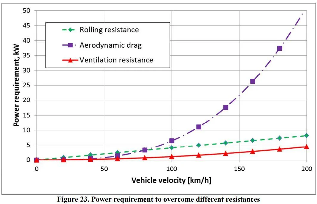

"What contributes to rolling resistance? Experts say that 1% to 5% of it stems from aerodynamic drag. Another 9% to 10% comes from road friction. And the remaining 85% to 95% is due to internal friction or hysteresis of materials. Engineers cannot do much about aerodynamic losses, and some degree of road friction is needed to keep cars and trucks on the road and not sliding off of them. That’s why they concentrate on hysteresis losses, those caused chiefly by the flexing or the tire materials as the vehicle moves, to cut rolling resistance. "
"The most influential factor on rolling resistance is tire pressure. With greater pressure, the tire becomes rounder, approaching a perfect circle, and this reduces resistance. The tire also becomes stiffer so there is less flexing. However, higher inflation pressures also influence handling and ride, so tires should not just be overinflated. "
https://www.machinedesign.com/marke...understanding-rolling-resistance-in-car-tires
The article does not mention wheel weight, but I think that has been reported other places with Tesla testing that indicates a heavier wheel reduces city range due to F=m*a.
In the end, I think putting 245s on the MME will have more of an impact on city range than highway range, and I am comfortable with a worst case 3% hit to highway range. It will probably be less if the tires are inflated to the high side of recommended, and with the use of "eco" tires designed for low rolling resistance.
