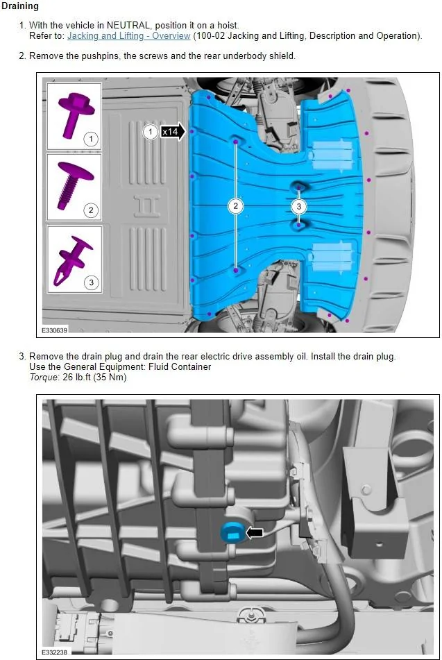

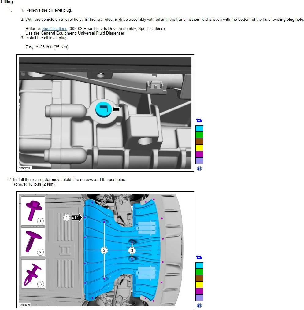

Rear drive - Motorcraft ULV Automatic Transmission Fluid - 4.07qts (recommend you actually measure how much comes out)

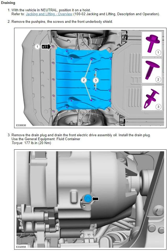

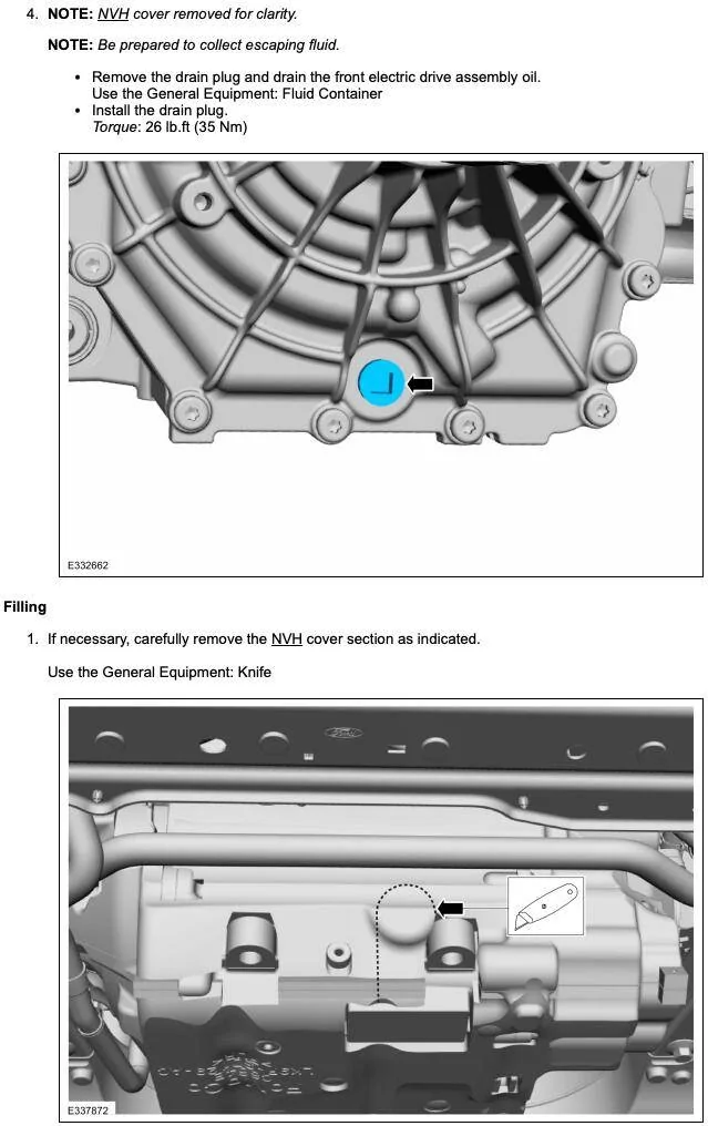

Front drive - NON-GT - Motorcraft SAE 75W-85 Premium Synthetic Hypoid Gear Lubricant / XY-75W85-QL (WSS-M2C942-A) - 0.92 qts

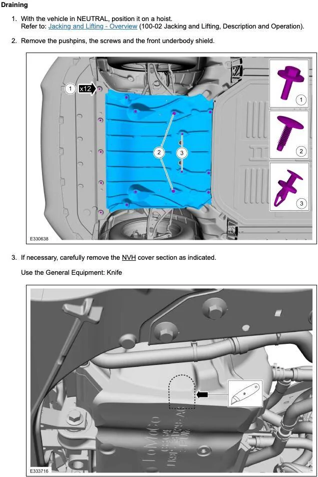

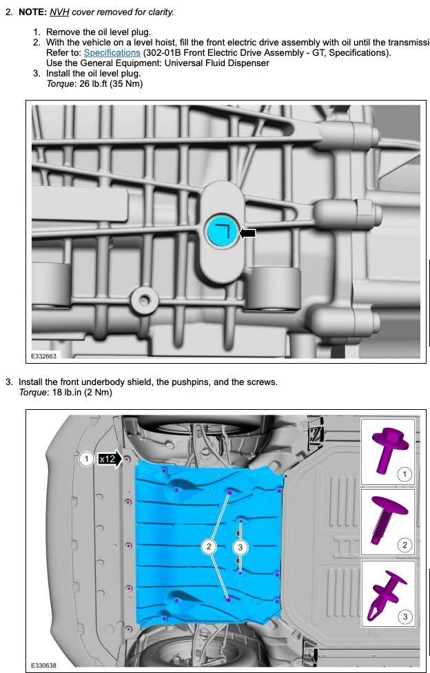

Front drive - GT - Motorcraft ULV Automatic Transmission Fluid - 3.43qts (recommend you actually measure how much comes out)
NOTE: DO NOT MIX UP GT/NON-GT FRONT MOTORS! You WILL damage your front motor if you put the incorrect fluid in it! The instructions for the GT front motor are at the bottom of this post.
Here's the WSM procedure on changing the transmission fluid. It is super straight forwards and simple. I'll do the rear drive unit first followed by the front drive then the GT front drive below that.
One note. The vehicle is supposed to be in neutral for this. I don't know why, but they want it in neutral. To keep it in neutral you hit the "L" after putting it in neutral with the car on otherwise it will go back to park when you get out. With the car in neutral be sure to be extra careful if you're jacking the car up so it doesn't roll.

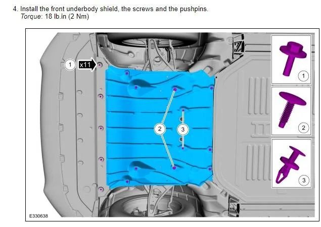

Front drive unit:
In reality, no one will have to do this for a while, but here it is for when it needs to be done!
EDIT: Adding procedure for GT front motor below:
